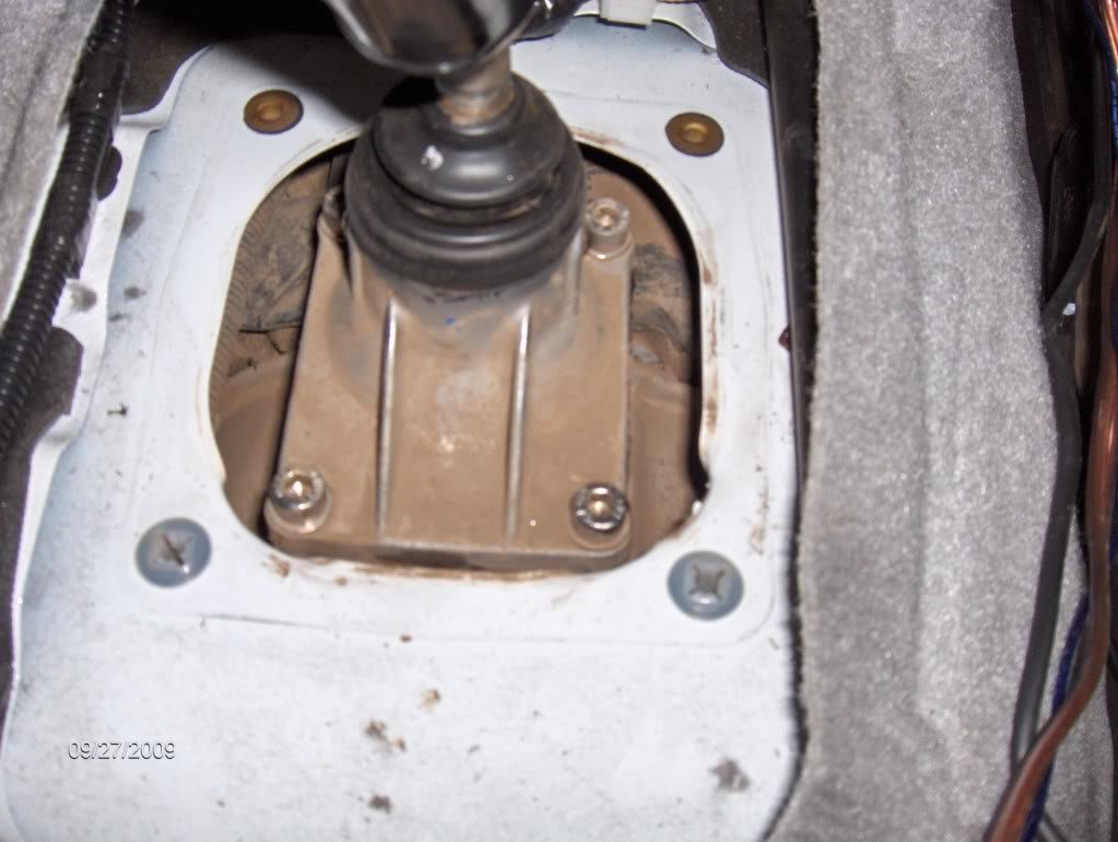

    Yeah, experienced this contact after the install and I had to clearance the hole around the shifter in my truck as well. I just did the pliers method.
    This pic shows where it was contacting

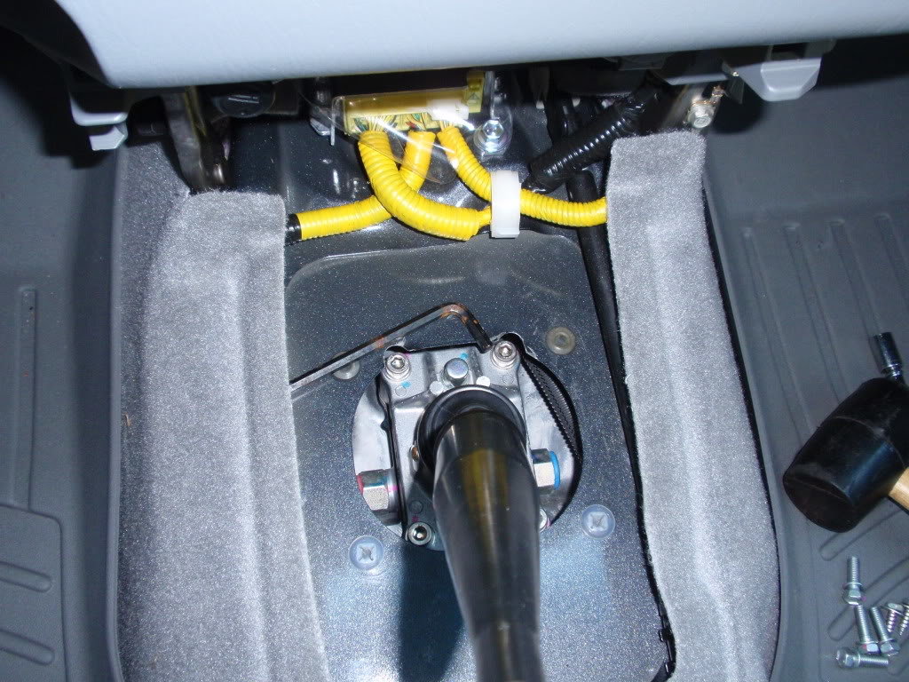

    V6 access hole ^
    I4 access hole
    As you can see my access is much smaller on the 5spd access cab. I should have done even more but I was able to turn shifter and eventually jam it in there and get the bolts in.
