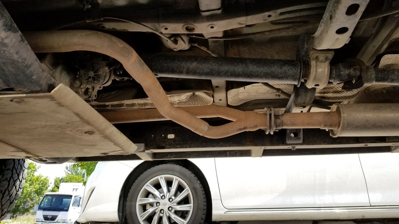

    Nice. Any pictures of your crossover?

    Nothing special. Just had to relocate. Oem crossover goes under the the T-case/tranny. Otherwise skid plate has to be shimmed down to fit under the exhaust pipe.
    Moving the crossover back further provides better ground clearance.
