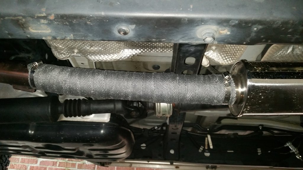

    OK, so URD refused to offer to buy back their MKIII muffler system if it did not resolve the crinkling foil rasp that their spec-u headers and y-pipe cause between 2 and 2500 rpm. Well like I said I would do, I got a newer larger resonator welded in today. I think the muffler shop did a trashy job because they used a piece of galvanized pipe even though I told the bastards it was stainless. Oh well, the sound is like night and day, and it beats the heck out of giving $500 bucks to URD for a muffler they won't even stand by. I have pretty much eliminated the rasp except for above 3500 RPM (where I never drive at anyhow).
    Old Resonator:
    New Resonator:
    Just so everybody knows- this is the URD Spec-U Headers, URD 4x4 Y-Pipe, Magnaflow Offroad Pro Series exhaust, and Vibrant 2.5" Ultra Quite resonator. It sounds great. No more crackling potato chip noises. Quite a bit more power according to my butt-dyno.
    Biscuits and Torspd[OP] like this.

    Fixing jenga:

    Keeping the heat away from the carrier bearing?

    That sounds fancy, but mainly fixing the crappy looking weld job on my resonator which was so lovingly referred to as 'jenga.'

    Ahhhhh.....a little toner for the blemish. ;)
