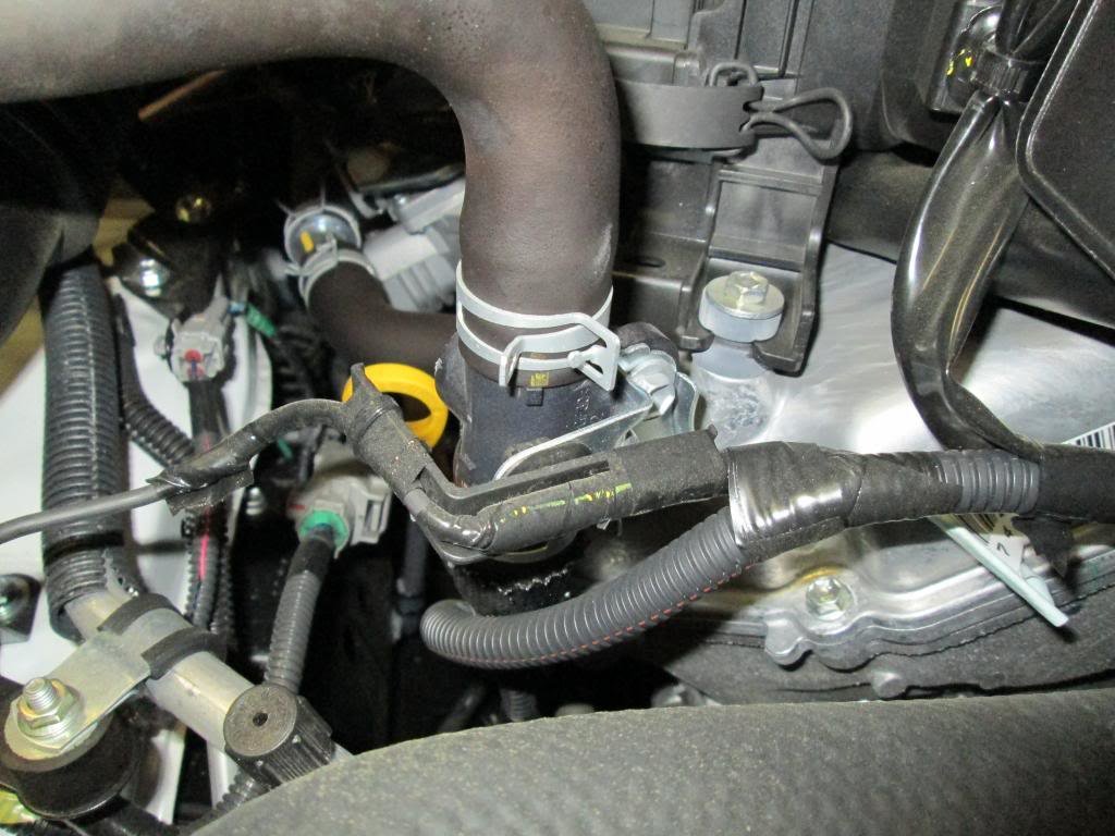

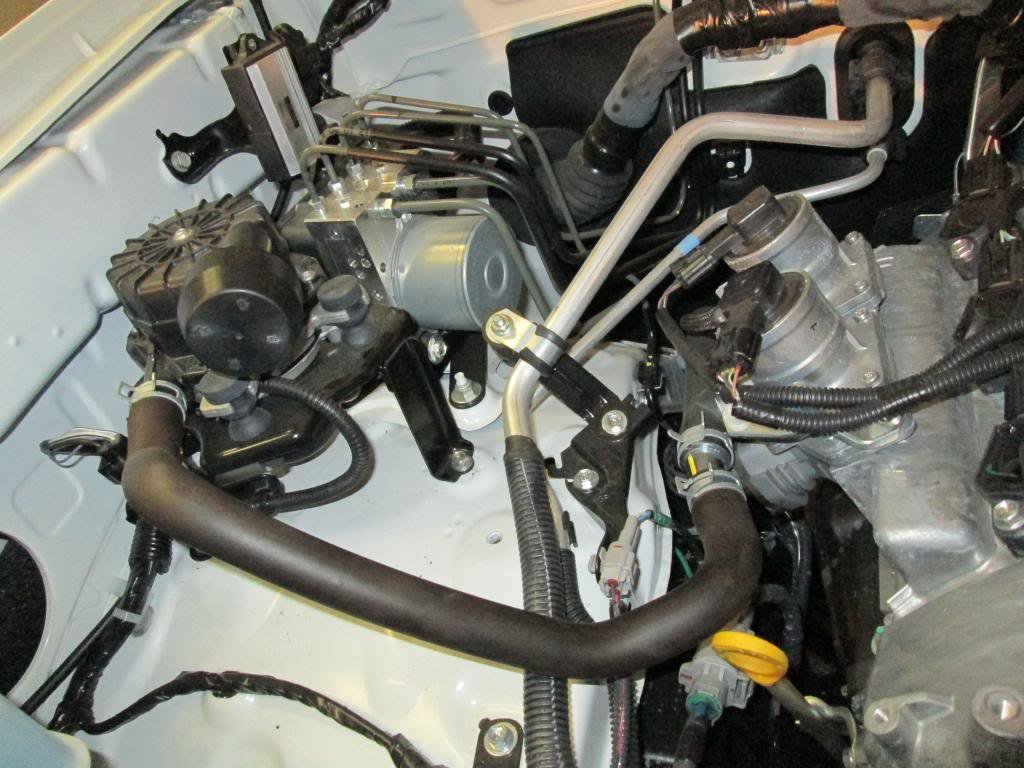

    We had a 2013 Tacoma DC 4x4 come by to get the TCAI installed today.
    The air injection system is real easy to deal with. I just removed the bracket and junction assembly and then routed the main hose from the pump directly to the control valves.
    This leaves all the stock parts completely in tact if they every need to be converted back to stock.
    Real simple and took like 30 seconds.
    G
