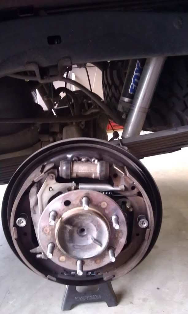

    +1 internets to everyone who said brake fluid. I wasn't below the minimum line, but I added some and the light went off. However, I have discovered something that bothers me. I took off the front wheel to take a look at the brakes, and there's a groove in the disc brake. I'm no brake engineer, but that can't be good. It's not super deep, but i'm sure it's still a problem.
    Also, i'm still getting a metal on metal noise when I'm driving. I might be retarded, but shouldn't bad brakes squeal when you're applying pressure to the brakes, not all the time?
    Lastly, when I jacked the front of the truck up, I went to spin the front wheel for fun and it didn't spin freely, it was very restricted. The back wheels spun for a good amount of time with little resistance, so the fact that the front doesn't worries me.
    EDIT: Oh I forgot to mention that I couldn't adjust the e-brake line. The bolts were really stuck on there, so I blasted them with WD40. I'm not sure I'll worry about it thought as the light is turned off.

    That's the only picture I took. I'll take a better one tomorrow after work. Any recommendations on what pad to buy?

    I wouldn't worry about the rears. Yours look like they have many miles left in them. Not sure how many miles are on your truck but those are most likely the originals if you have less than 150K.
    Here is a pic of mine from a recent inspection. 113K miles. I expect to easily get another 50K outa them.

    18,000 miles? they should've lasted a bit more. the pic of the front rotor looks like a 'stone groove'. Either way, it really is gravy to do a front brake job, and ,BTW, I'd turn(recut) the front rotors from the look of them. They are quite glazed. Otherwise, new pads will go to shit. And, with metallic/semi metallic pads you will have to 'bed' them, which basically means after you change them drive the truck a bit, do some 'hard' braking and it will help set the pads and kind of heat-treat them. If you don't, when you first drive it the pedal may feel low, braking weak. This is normal, but after you heat them up they will be fine. Any local auto parts store will cut/turn the rotors for around $15.00 each. It's always a good Idea. Ask me how I know...
