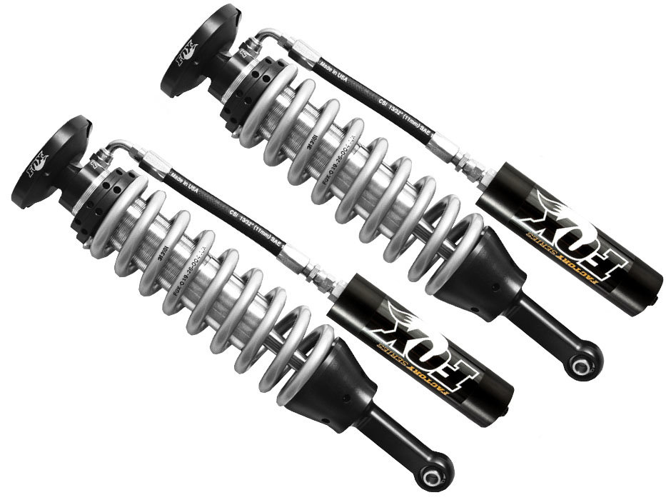

    Does anyone know if fox sells replacements top mounts for their coilovers? One of the 3 bolts that mounts the Coilover to the frame snapped off on me and for the life of me I can’t get it out (thanks NY salt). The top mount disconnects from the Coilover by 1 bolt, I’m hoping I can just purchase a new top mount and be on my way. A new Coilover would be ridiculous!

    Yes, there is a part # for the top hat. What shock do you have?

    They’re the 2.5 factory series coilovers for the bds 6” lift. I’ve attached a photo of the style they are.

    I got the Coilover off the truck and tried to drill the snapped bolt out but it won’t come out, so I’m going to need a new top hat. The top hat attaches to the Coilover body via a large Allen head bolt that goes through the top hat and shock body

    Fox designed it where the top hat is threaded so you just thread a bolt in, honestly I thought about just drilling it out and putting a bolt through and a nut on the bottom

    Fox sells that part for sure but I doubt anyone has it in stock to sell you.
    IMO drill it out and nut and bolt it. It might be worth it to drill out the threads on the other 5 to do the same since they will all corrode to become 1 soon enough.
    https://en.wikipedia.org/wiki/Galvanic_corrosion
    That's what is happening and you need a 5 gallon bucket of anti-seize and yearly maintenance to keep it at bay.
