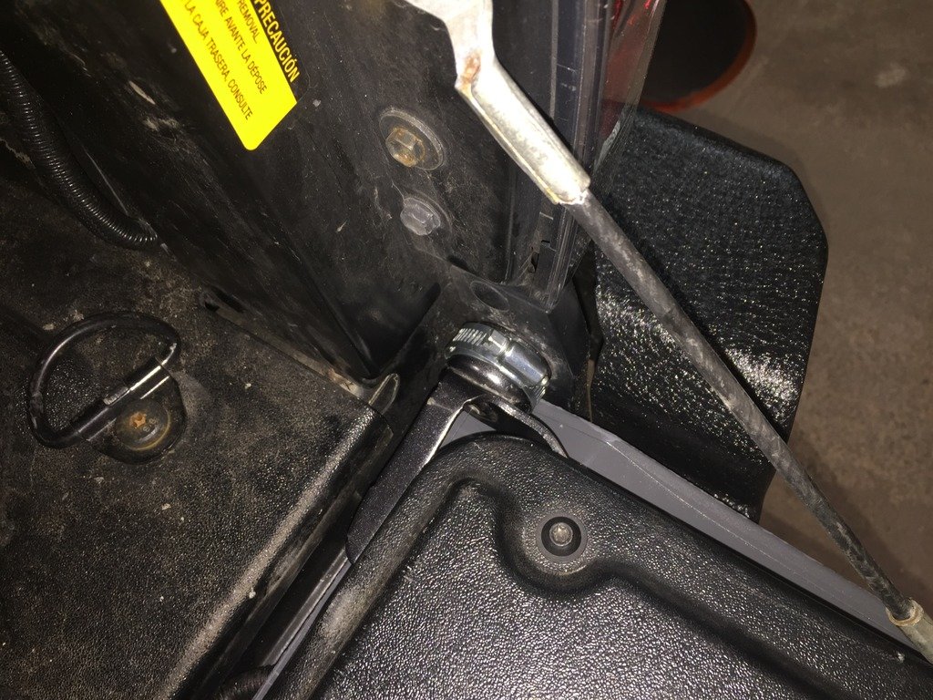

    If it is like in the next 15 minutes urgent, do the hose clamp mod. Also do the washer mod. Those two in combination will stop 96% of tailgate thieves. If you think it is still necessary, order a pop n lock.

    I did the hose clamp mod. You could also just park your truck close enough to your house, tree, whatever, so it can't be opened until you get a fix.

    Another Mod you could consider is instead of using the hose clamp, just remove the tail gate bracket cut a piece of 1-1/2" PVC pipe cut to size and place the sleeve over the pivot and then re mount the bracket. Very easy and cheap to complete. It works great if you don't plan on removing your tail gate for anything. I read about this a while back on TW not sure who to give credit to an awesome idea.

    Thanks for all the responses ordered the pop n lock but just went to home depot and got a hose clamp to put on for at least the next to days. Still cant believe they stole the tailgate. We are sitting ducks are neighborhood street does not have a block wall separating us from the main street so any one can walk though, we have had are boat broken in to and other vandalism.
    PVC pipe idea is great idea to never would of thought of that! to who ever said it above

    you can also make the screw part of the hose clamp point down where you actually have to get under truck under the bumper to access it and its not just on top when you open the tailgate
