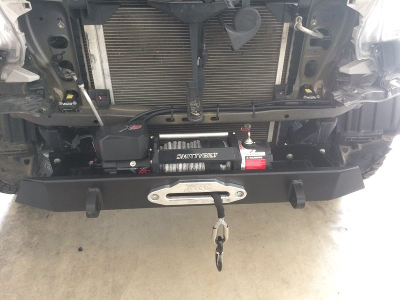

    cWSmB7kxzz2ox_6D0iWM8UGpHat9X30N-m1TA4kh_8d710b9bd9d5226f839e77cd75f225670b1994d0.jpg
    I'd recommend putting the fairlead on first, then putting the winch in the bumper, then sliding the entire unit in place, it's a HELL of a lot easier to get the winch all sorted out before putting it on the truck, I, of course, did it the other way around. Including forgetting to put the fairlead on till after the winch was bolted in place (with some difficulty I might add), AND didn't wire the winch till after it was bolted in (also a PITA).

    :rofl: I can only laugh because I did almost the same thing. Except I bolted the winch down and hooked up the wiring. Once I mounted it all up including the bumper guard I realized it would be hard to mount the fairlead. Ended up removing the bumper and pulling the winch off and redoing it all right.

    I feel better now. I felt like an idiot for not noticing the space constraints on the fairlead bolts. Had to pull it all apart and redo it, too.

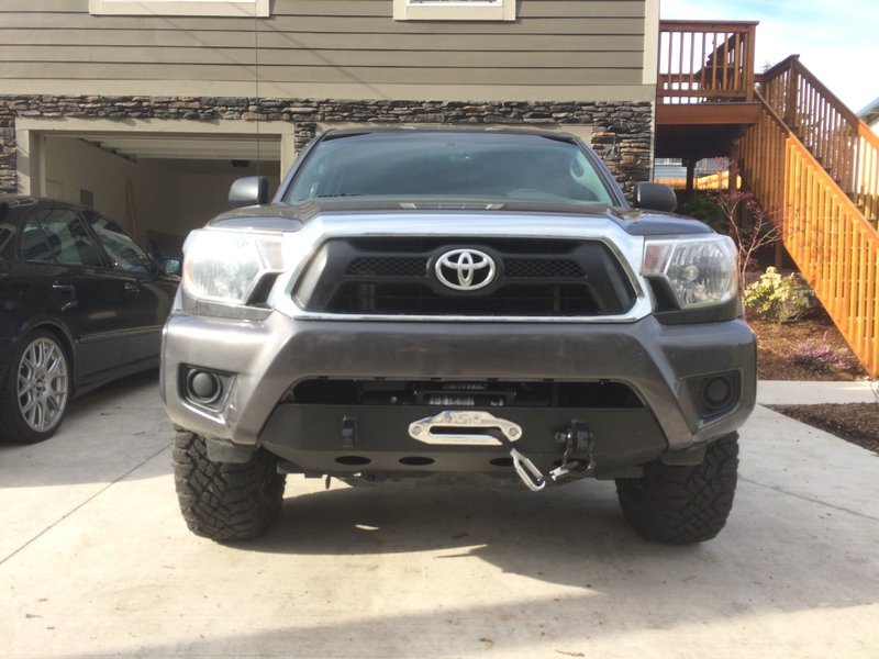

    Forgot to post these up. Install went fine. Very clean.
    The one think I would like to do is make quick-connect fittings near the battery for the power and ground cables so they're not hooked up to the battery constantly.
    Has anyone done this? Where can I find some of these for 4G cable?
