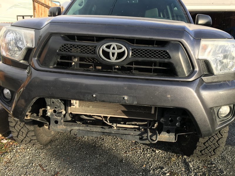

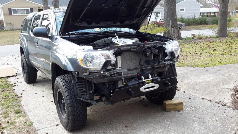

    Question what did you use to cut the bumper and thank you for showing pics of it in the process I never see this and it helped me confirm my choice on bumpers lol

    I just used some side cutters and a saw. It's easy

    Do you have any pictures of it before install possibly?

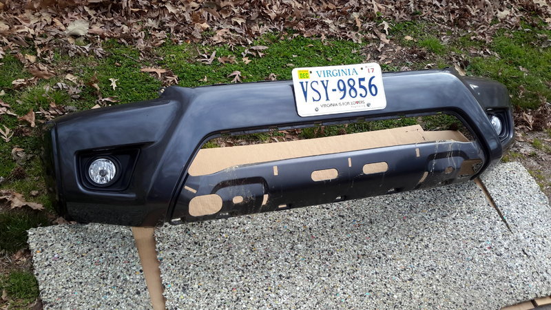

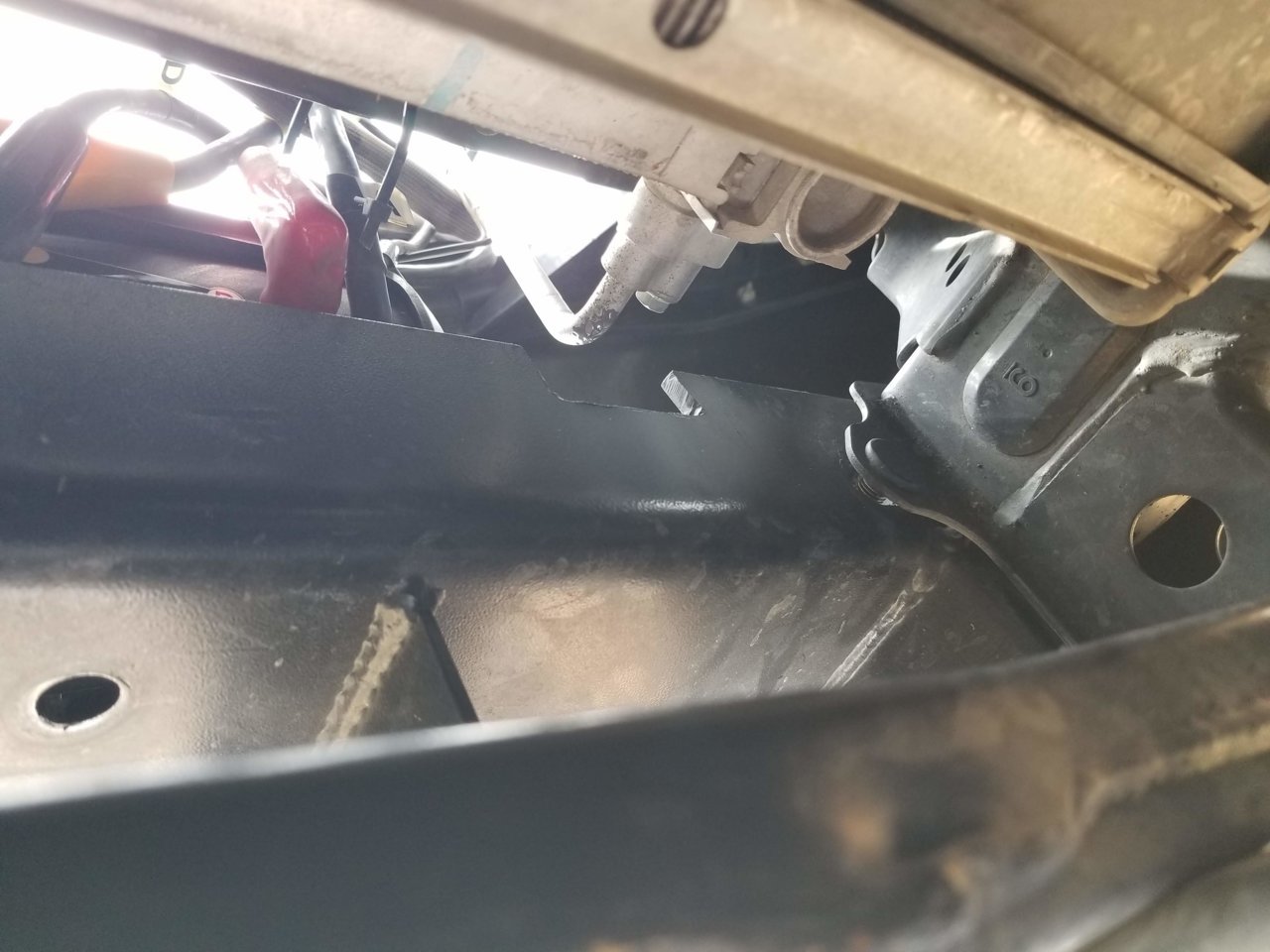

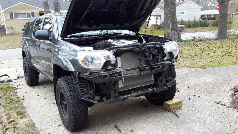

    I used the cutoff wheel that was also used to cut the tie down hoop. Then fine tuned the cuts with a sharp razor knife. Only pictures I took before install.
    20170324_152457.jpg 20170324_171223.jpg 20170324_171231.jpg 20170324_185417.jpg

    Here's a post cutting/pre install pic @13_trd_tacoma
    The final prep for the US offroad bumper may look a bit different...I have a Relentless bumper.

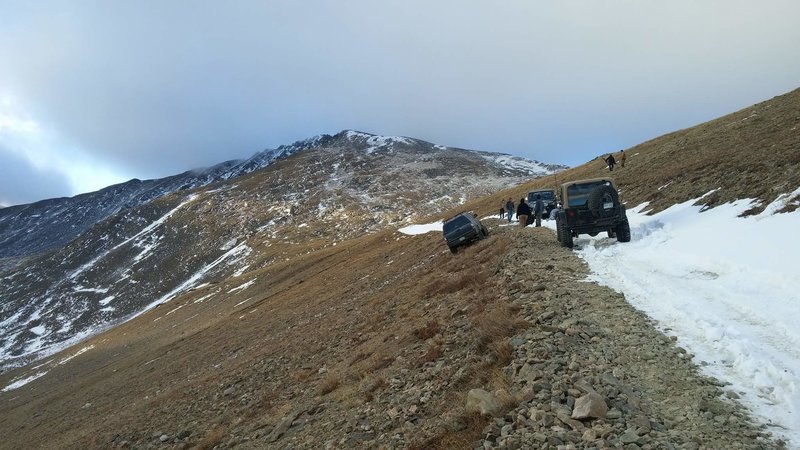

    I've done many recoveries with a local rescue and recovery group. 10 recoveries that I documented using the winch, many being full strength pulls at crazy angles and large vehicles. It's also been used as an anchor point and for kinetic strap recoveries. Total winch uses, likely near 20... Two of those being for me.
    15068504_887874313505_2723916315760594314_o.jpg 14568145_877534285005_9069602819884372561_n.jpg
    So it has been well used and shows no signs of any issues. I have the USoffroad one.

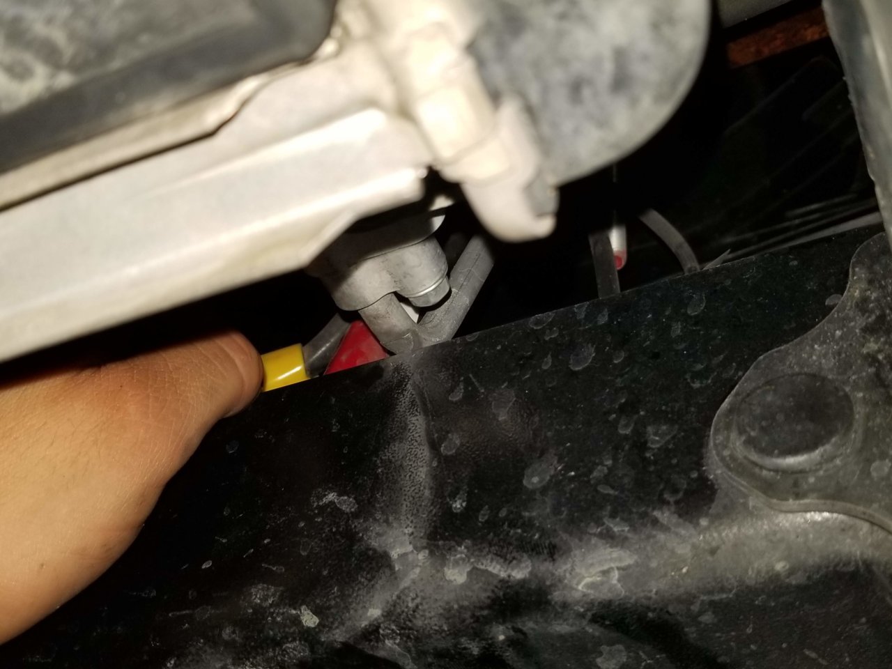

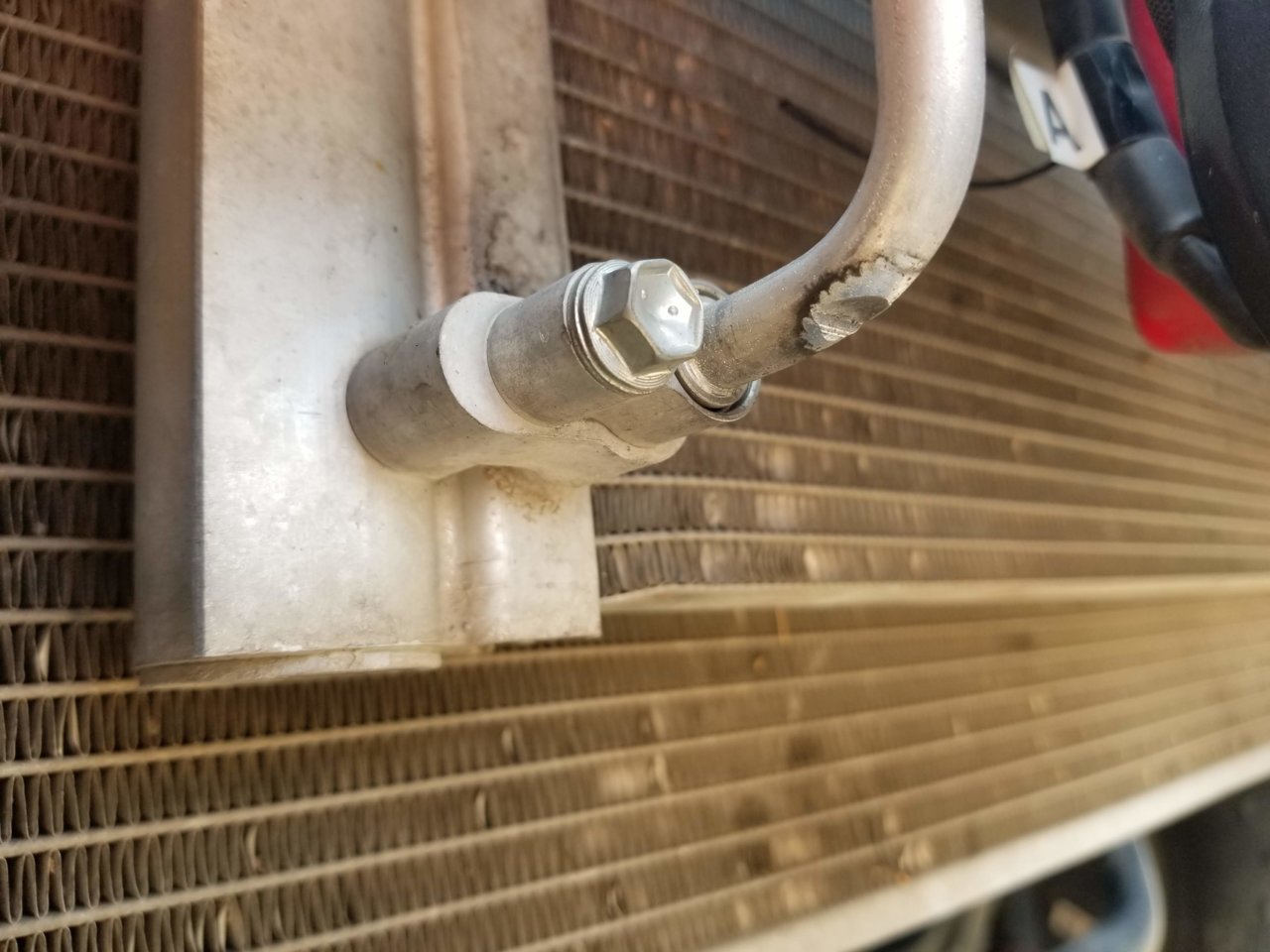

    Maybe this has been covered before, but y'all may want to check your lower AC line. Bumper was starting to rub a hole through mine. Had to take it off and notch it. Took 2 years or however long i've had it, to get to this though. @usoffroad

    I just checked mine. I got 1/4 inch spacing between my (US Offroad) winch bumper and AC line. My guess its how high the bumper was held when the bolts were snugged up. Now after 4 years, you’ve made me paranoid. o_O

    I've never seen one rub out of the 1000+ we've sold. Was your truck ever hit in the front? AC system ever been off and reinstalled?
    No matter the positioning of the mount that our mount holes allow.. it should never touch the AC line.

    No wrecks or AC work, until this anyway, lol. Lost a little freon and started lookin for leaks, then i remembered the small tolerance and checked this location and sure enough.
    It was always very close though. I'd say 1/8 to 1/4". I remember noticing how close it was when i installed and thinking i should notch a small groove. It could just be variances in MFG, who knows.
    I installed 5100's and they were not up to par and caused some good cupping on the tires, regardless of numerous balances, road force balances, and alignments. The cupped tires probably contributed to front end bounce/vibration and caused line to hit bumper. Not sure. Have since installed TRD Pro setup, that has alleviated that. Anyhow, i created plenty of room, with a good size notch, lol. Just JB welded the pin hole, as a temp fix, and its been holding up fine so far.
    Still completely happy with bumper and recommend it to anyone, just puttin out the info. Just in case others have a small tolerance and may want to alter a bit as i did.

    Can't see the gap from this angle, but there was a small one, i figured allowed for enough tolerance. I'm actually pushing the condenser back a bit to show the rub. I imagine the vibration from the cupped tires may have been the main contributing factor. Line and condenser actually move pretty easily, i didnt have to push on condenser very hard to allow for movement to see the line.

    Nothing wrong with bringing this up. I ALWAYS want feedback of any kind. There are large variations from truck to truck... FJ's are the same way, some will have an 1" of clearance, some 1/4". If something is a little close it never hurts to split some fuel line and zip tie it around the line... the bend in your line makes that a bit difficult though. The notches we cut for the AC lines have always provided plenty of clearance but maybe yours was just one of those that had some shift in the shape of the AC line or something. It's a common issue on just about any aftermarket bumper out there for Tacos and FJ's.. .especially FJ's.
    Email me some high res pics of your truck.. including the one above... and all of your mods and I'll post it up on our sites. brad @ usoffroad . us
