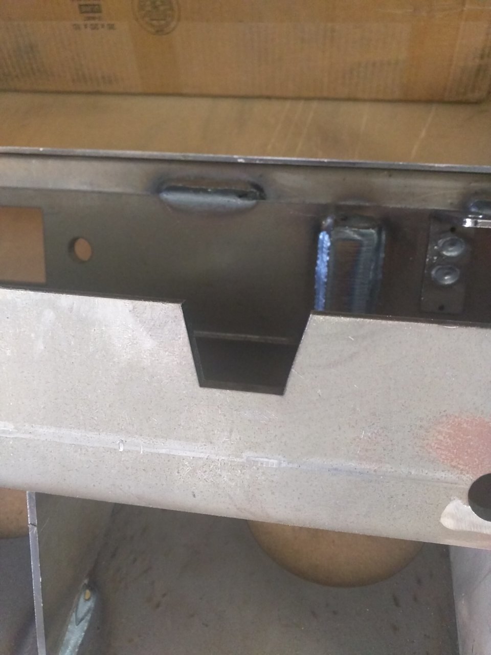

    I'm looking at your pic... where is the notch in the back of the mount? You can see where the freon was leaking. Should be a notch there from us..... what is your order number?

    Wait.. you may have one of the early Gen 2.0 versions that didn't have the notch. They all have notches now. We didn't add the notch at the time because there was typically tons of clearance.. but we added it later to be on the safe side...and now we know why.

    This is the cut we make now... been on there for quite some time.

    Haha. Yep, i made my own notch. Price you pay for being an early adopter, lol. No worries :)
    Just hoping the JB weld holds, lol :rofl:

    Checked those and all good. They added the notch for a reason, lol. I just happened to have a smaller clearance, coupled with my cupped tires and vibration, probably all i needed to work a hole into it. I needed to replace the solenoid on my winch anyway, so i had to drop the bumper anyway. Killed 2 birds with one stone, well 3 really, also needed to paint my homemade light bar mount that was rusting, lol.
