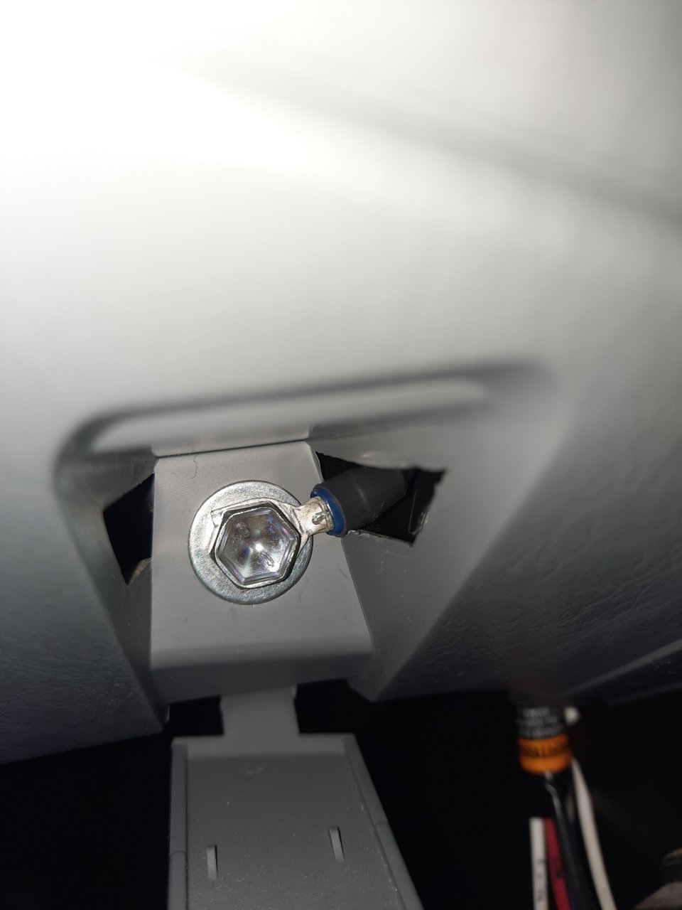

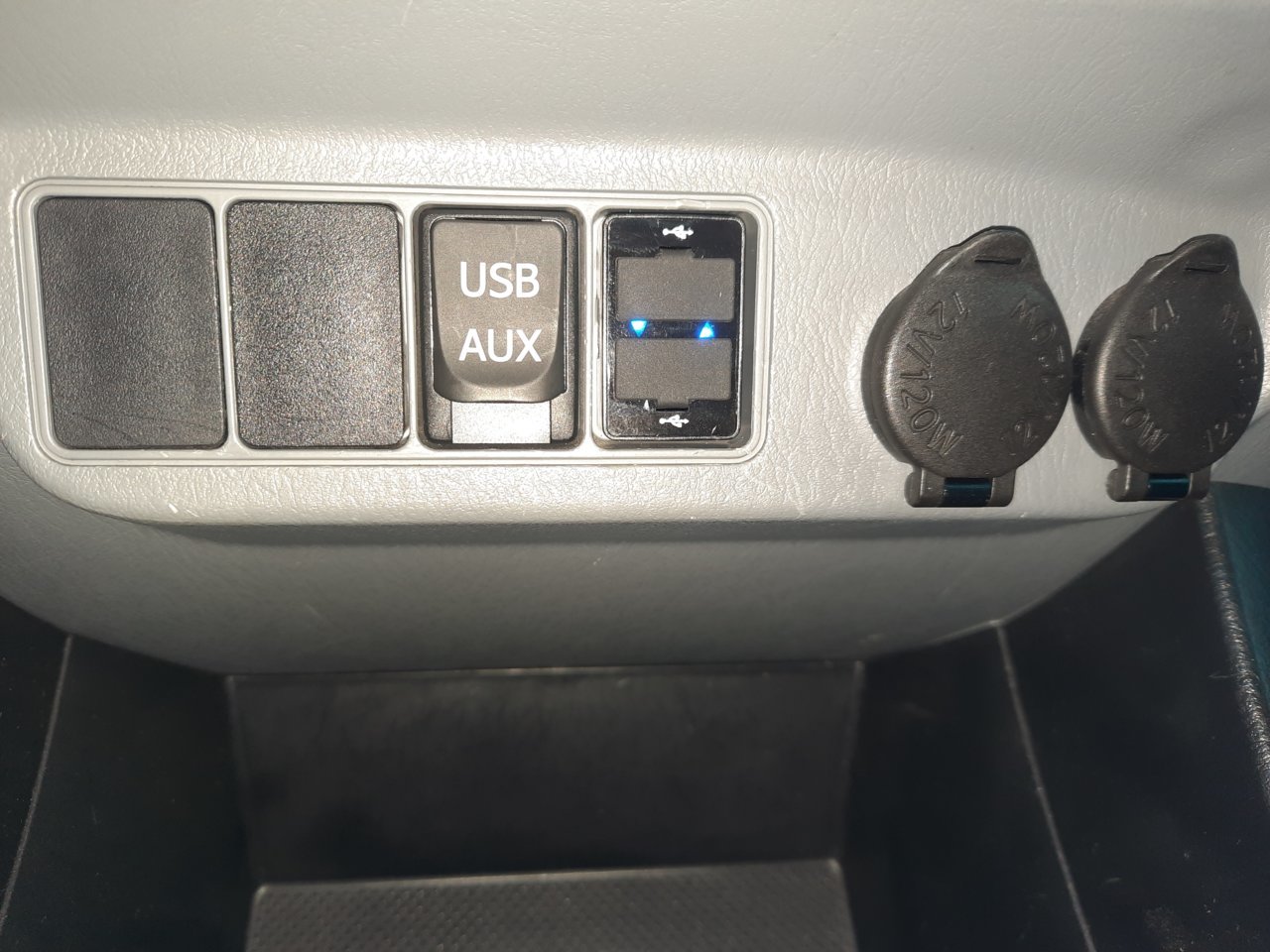

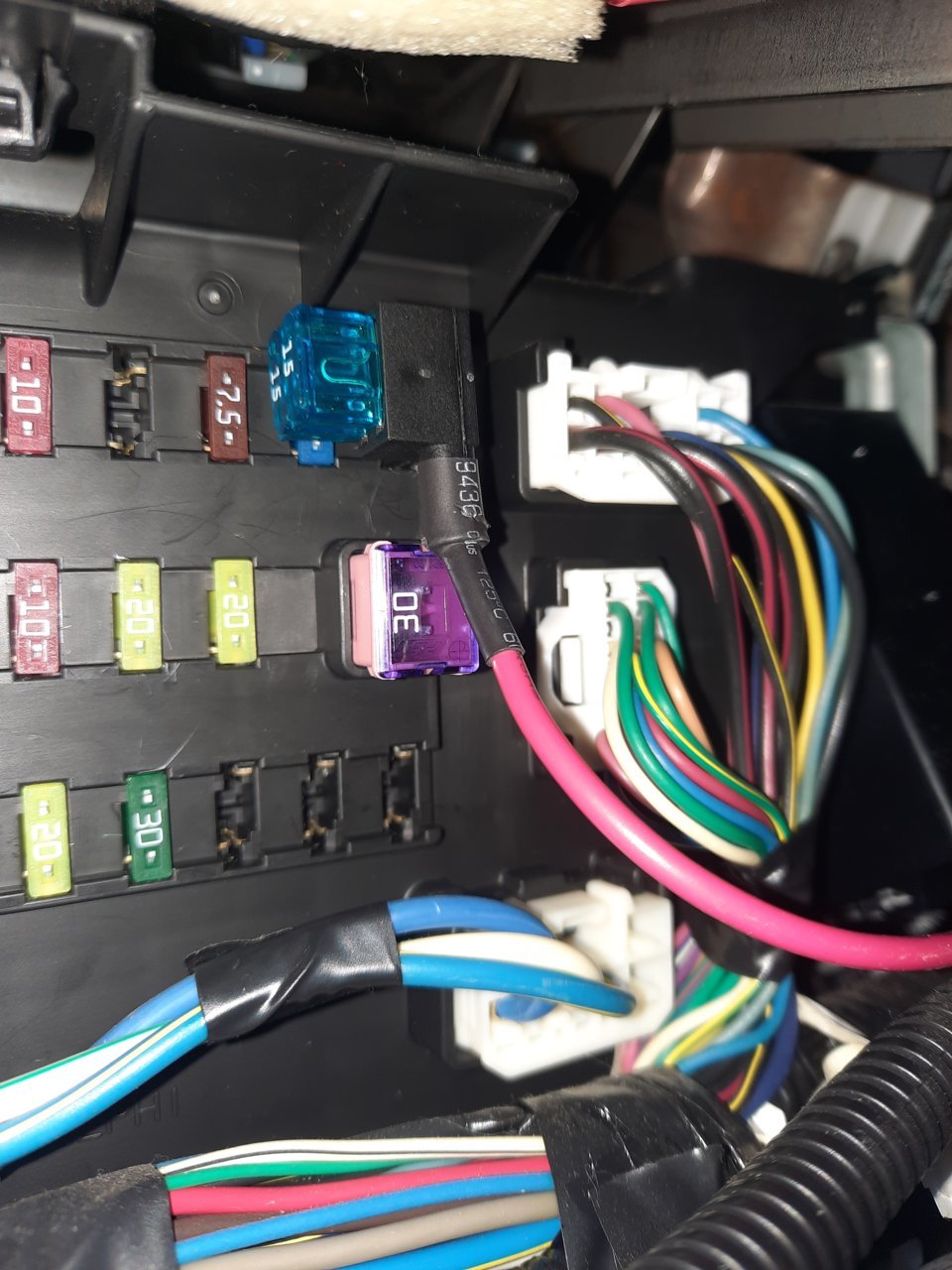

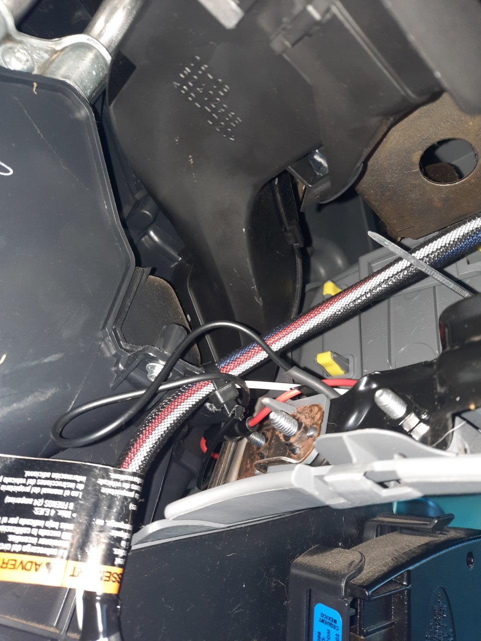

    Finished doing this yesterday. I had some venison summer sausage on the smoker and was canning a batch of sauerkraut at the same time so I only took a few pictures after everything was done.
    The only always hot fuse slot I found was for the power door locks, everything else in the cab fuse panel was only on with the ignition. I expected there to be more options but I didn't go under the hood, I didn't want to run this through the firewall.
    The red wire in the second picture is from the usb plug. I grounded to the dash bolt under the steering wheel that is covered by a small plastic panel.
