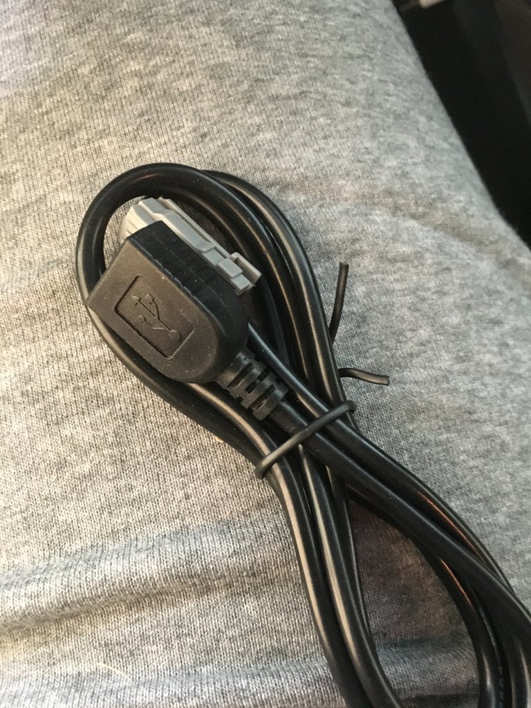

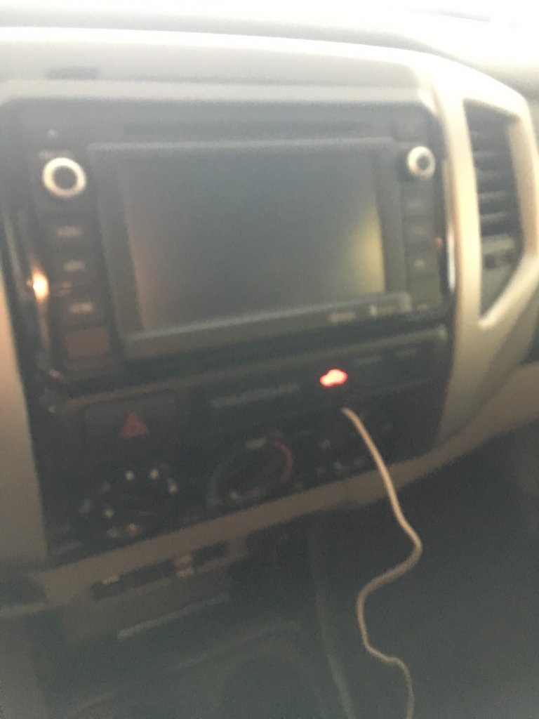

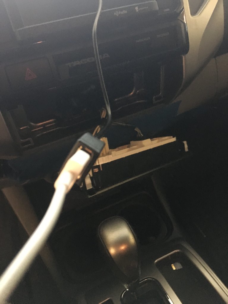

    Got the USB adapter today @nartmot . Took a while since it came from China and they sent me the wrong one, so they had to send it again. Got the correct one yesterday.
    Good news is that it works, phone gets recognized immediately, so that leads me to believe the issue is the oem usb port on the lower dash, but I don't want to claim victory just yet. I will be using it everyday next week to see if it continues working. If it does then I'll take this opportunity to move the usb port inside the center console and remove the oem usb port.
    Buy the 3.5mm stereo to toyota adapter for the radio also and wire an universal usb/3.5mm audio port and use the usb for power only, that way I'll have 12V usb charger and 3.5mm audio in the lower dash and usb audio input inside the center console.
