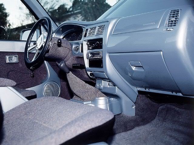

    Do you have an aftermarket stereo? If so how about putting a plate or something in the extra space there?
    And is this the kind of interior you're working with (aside from the god awful carpeting of random sections)?

    yes thats an interior very similar to mine aside from the cupholder beside the shifter and that carpeting thats scary. i want the usb port around the radio ashtray area ive narrowed it down to. dont want it in the center console. i have a double din radio so the extra space below the radio on a single din is gone.

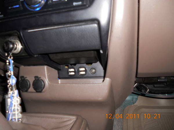

    i finally integrated usb ports into my truck. they are mounted up under the ashtray. I used 2 of the above for my ports. 1 set is for charging. the other i converted over for data. I just used the housing to have a nice look. made my own usb cable that i hooked to it that my radio can understand. For data i now how those to data ports plus i can leave my ipod plugged in like it is without using the ports i installed

    how did you hook up the data ports?

    the charger itself can not be used for data i tried. I robbed a dual stack usb port out of an old cheap usb hub. Desoldered the connecting pins. Cut the end off a usb cable and soldered the wires to the pins. I jumped the pins so that either port would be live

    heres what i did guys. i dont have any pictures from the process but if someone is interested or wants me to explain how to do it or I can make the usb ports for you and you put them in.

    have a newer headunit that has a usb port. I usually listen to my ipod which the cord is ran under the center console and my ipod lays in front of the cup holders. I wanted usb ports for charging. I have digital cameras, phones ipods etc. plus friends riding can charge up. I also added a set of usbs for data. made my own y cable going to my headunit. tried a usb hub but that wouldnt work so i used a y cable. i can only use one device at a time with my headunit which is fine. but friends sometimes have stuff we want to hear so this gives an easy place to plug in tunes and get power. the power ports are live all the time. I already finished this and have pics in the thread
