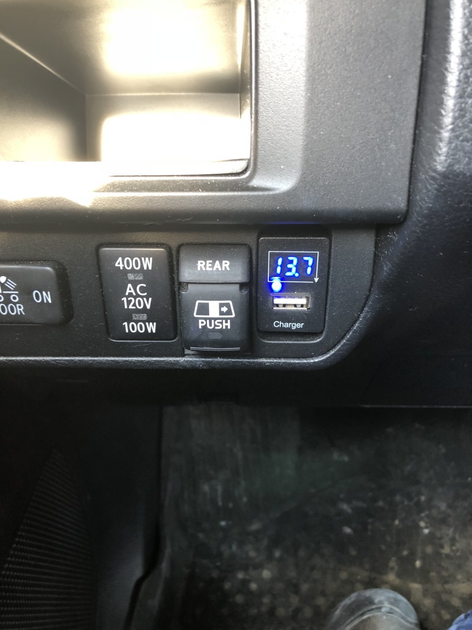

    Do you have the link to that USB charger? And if it take any modification to get it in the switch cutout?

    It’s not made specifically for the 3rd gen but it fit tight in the space without modification. I’ve been running it over year now without issue. It’s not loose and hasn’t fallen out just held in by tension.
    I’m happy with it.
    Cllena Toyota USB Charger + Voltmeter Tester 1.9ft Wiring and Fuse USB Power Socket(Blue LED) https://www.amazon.com/dp/B01EN5E3X2/ref=cm_sw_r_cp_api_i_.QSIDbJCXXS9V

    Yeah I tapped the wiper circuit with an add a fuse that way it comes on only when the ignition is on. If you want it on all the time you can do that. I would just stay away from tapping any engine management circuits.

    What is the volt meter for?

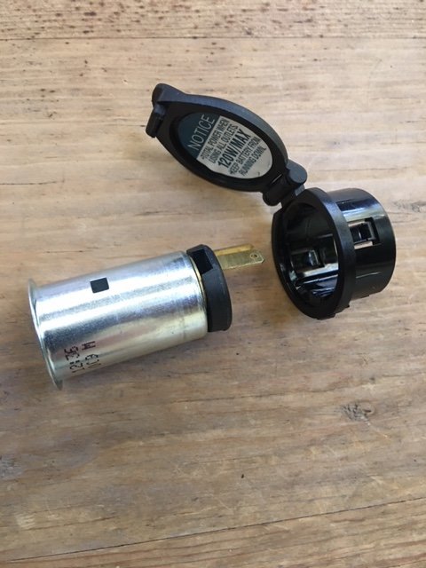

    I've got the radio bezel surrround and A/C cluster removed for another mod. Made an attempt to remove the cigarette port by reaching behind it and twisting/turning/pushing. No luck. What is the technique for removing the OEM cig port?
    Tacospike[QUOTED] likes this.

    There are little tabs inside the cig lighter that need to be pushed. I used a tooth scrapper (improvised) and some muscle to get it out. It wasn’t as easy I thought. Also, had to file the hole larger for the new usb to fit. Just did a little at a time and checked it till it fit

    I used a pick and caved in the silver liner and pulled it.
    I used an extension cord, added a fuse and ground. Threw it behind the head unit and run the cable right up to the mount.

    :thumbsup: Thank you. A right angle pick worked for me. There are two tabs, top and bottom. Pick (twice) and simultaneously push from the back side.
    Also worth noting that the silver female tube is latched independently from the black bezel/cap. The tube is latched to the bezel and the bezel is latched to the truck. Pull the silver tube out first, then release the latched bezel.
    The OEM hole is just shy of 1 1/8", so VERY light Dremeling opens it up for the new 1.125" socket.

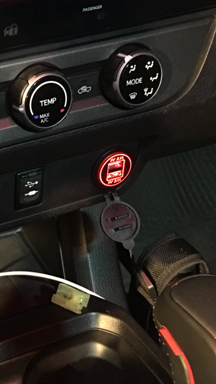

    Has anyone located one of these to the back of the arm rest facing the rear seat?

    Yes, they move the center console one and drilled a hole to face the rear seat location.
