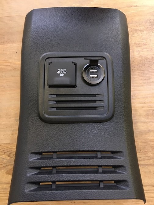

    This discussion focuses on installing a 110V port to the back of the arm rest, but it also ventures into adding another 12V cig port back there.
    The in-cabin 15A fused "POutlet2" circuit already extends into the console. By tapping this circuit and routing it with a ~20" cable (14 - 16 gauge wire is fine) above the inverter, you provide 12V to the rear seat location.
    The circuit can be switched or always on with other modifications.

    I have this same one in red works awesome I just found some connectors that fit over the OEM plugs and added some shrink tube to cover them
