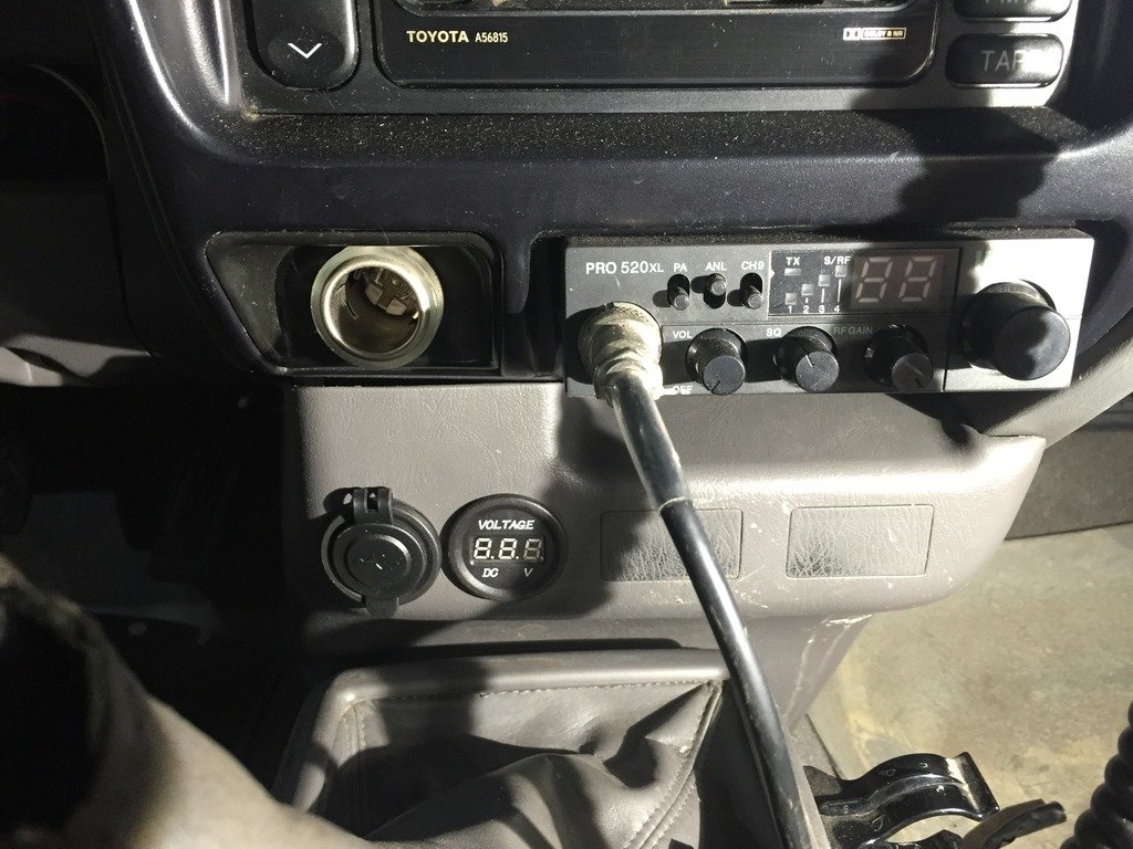

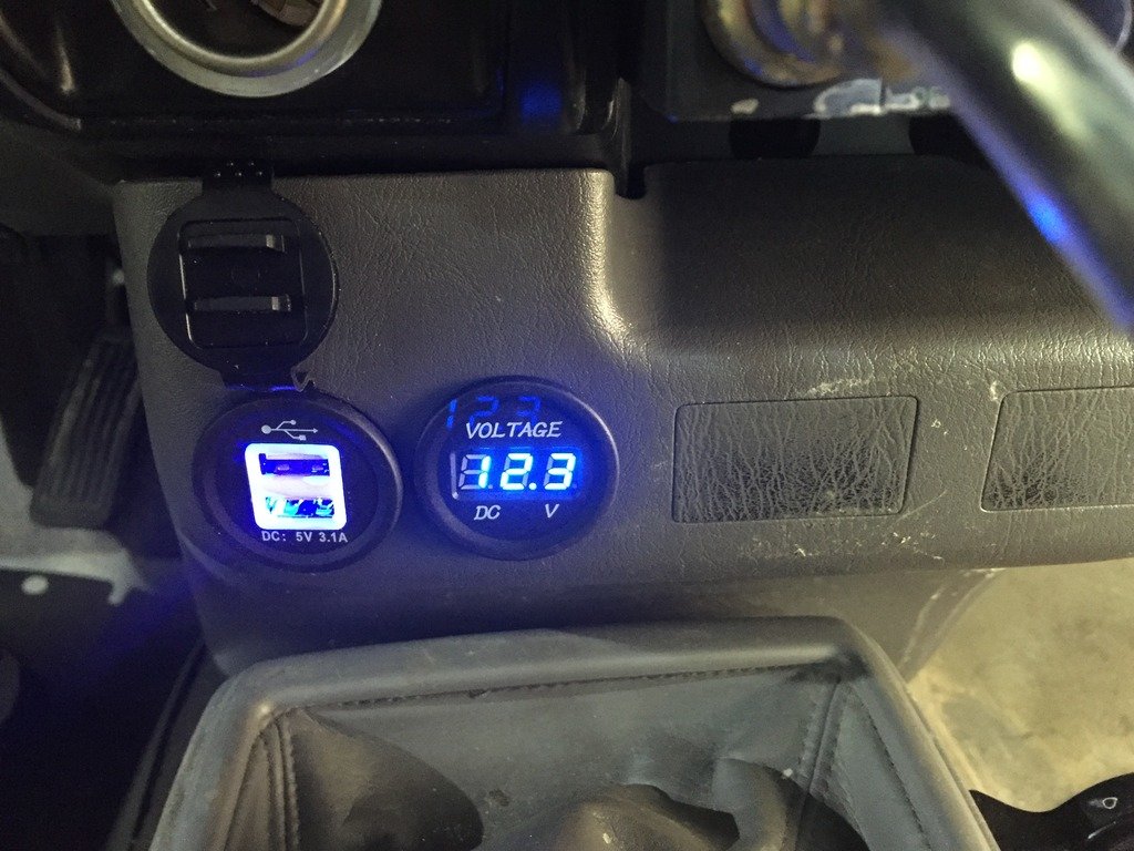

    That's the one - however I've an older Gen 1 so I installed into the center console just under the arm rest. I am going to install another one in the extra lighter hole.

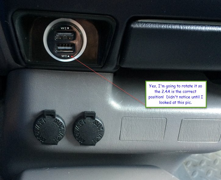

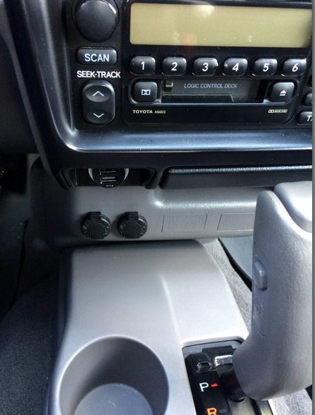

    Sorry I'm late to the party, this is the one I installed. It's hardwired in so it looks a bit more OEM/cleaner.
