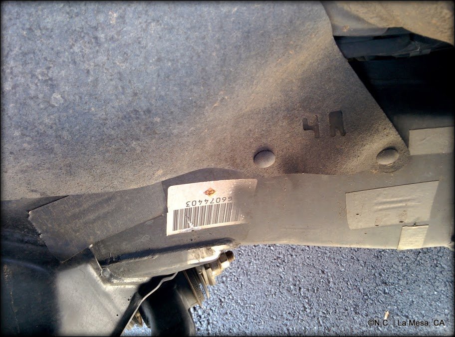

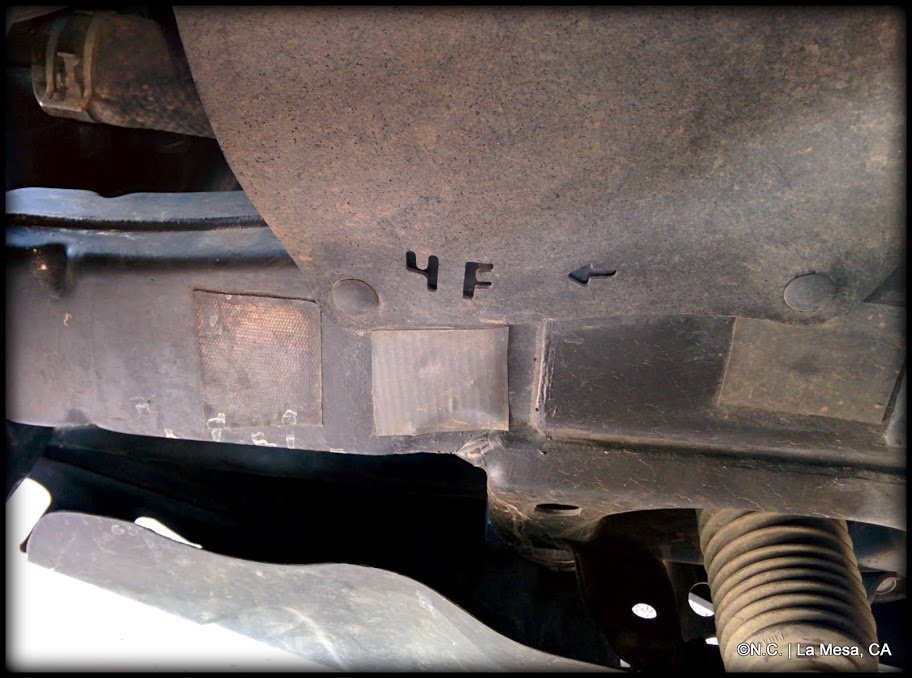

    This thread was about plugs in the frame, but I found duck tape works best and is cheap. It's been 11 months and all is good. (Installed Nov. 2014)
    Seal them all up except for the holes on the bottom side of the frame.
    Also, there is a huge hole (2-2.5" diameter) in the body mount perch that needs to be sealed too.
