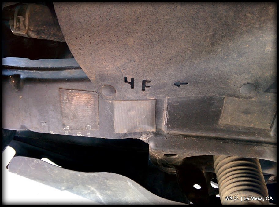

    Hmmm about $0.40 in duck tape and about 20 minutes to clean the frame and apply the tape. I monitor the tape and it's solid. No problems. I'll see if I can rustle up a pic.

    Seal them all up except for the holes on the bottom side of the frame.
    Here, just took some pics of mine, and thanks for the reminder about the big 2.5" hole at the body mount perch, I forgot to do that one! :annoyed:
