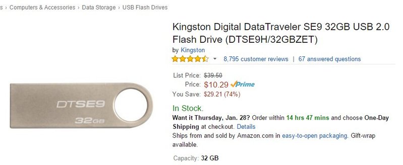

    Kensington makes a nice one. Try this one. It's about an inch long.
