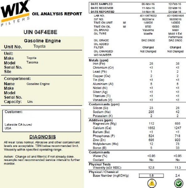

    My second report...even though Sodium is listed as a contaminant, it's also a common additive. I used Mobile 1 Extended for the first sample, and Valvoline MaxLife High Mileage the second. Used Mobile 1 Extended oil filter for both samples. Even though mileage was almost 1K less than with Valvoline, the TBN value was quite low compared to Mobil. Thus far, Mobil is looking like the better of the two oils. Replaced oil with Valvoline again, but with a Purolator Synthetic oil filter. Will change at 8K for this sample and then switch back to Mobil.

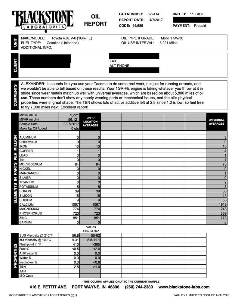

    2011 TRD OR 6spd, Mobil 1 Advanced Full Syn 5w30, 5,221 miles on sample. 11 TACO Mobil 1-170327.jpg

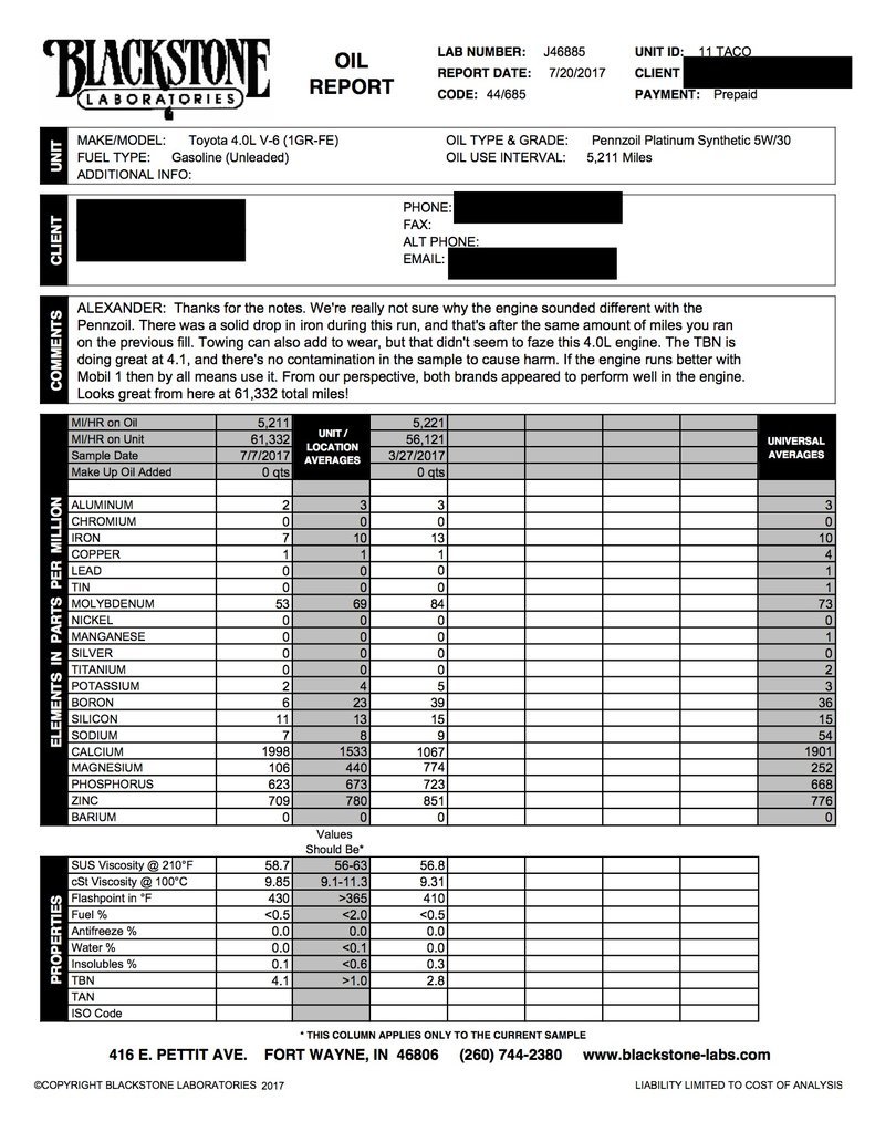

    2011 TRD OR 6spd, Pennzoil Platinum Full Syn 5w30, 5,211 miles on sample.11 TACO Pennzoil Platinum-170707.jpg
