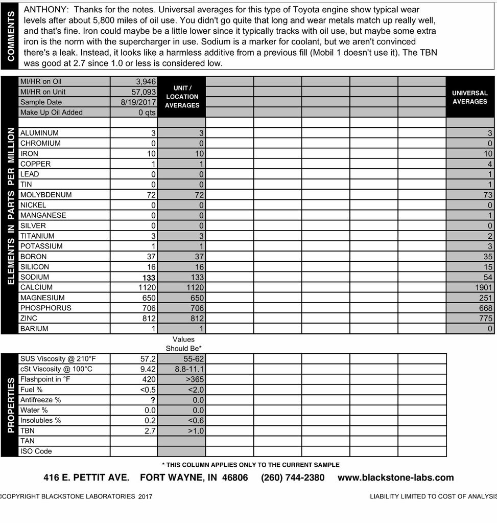

    2014 Tacoma 4.0 w/ supercharger. Used mobile 1 adv full synthetic 5w-30. 3,946 miles on this change. Sodium seems high but I guess I shouldn't worry about it yet.

    Blackstone is correct. If the last fill was an oil that used Sodium as an additive (Valvoline is one - but there are many others), it takes several changes with an oil not using Sodium for the Sodium levels to drop to or close to zero.
    If this was an internal coolant leak, I would also expect to see Potassium high too, but it is not. So what oil did you use prior to this fill?

    That makes me feel better, thank you for that information. I am not sure what oil was used prior. I purchased the truck at 47,500 miles and I had my dad look up the service history. It was always changed at the dealer on time. Then at ~50,000 miles when the supercharger was installed the dealership changed the oil. Not too sure what they use. I was pretty rough on the truck in those almost 4,000 miles so I'm not really worried about it looking like oil that has 5,800 miles. Good amount of idling done too.

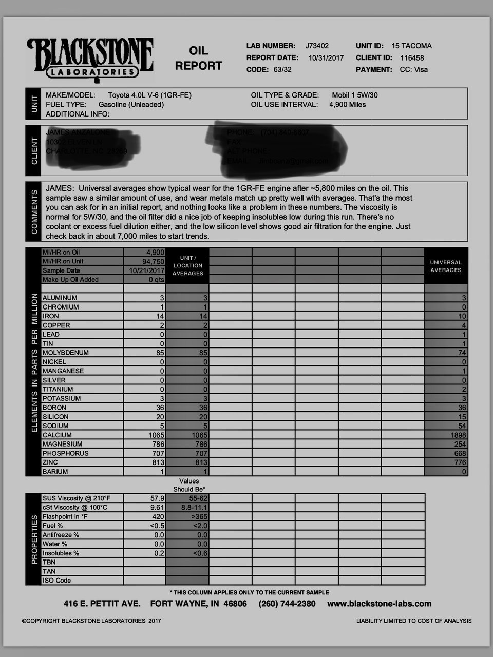

  8. Oct 31, 2017 at 3:13 PM
    #88
    JimboAnz
    JimboAnz #OldNorm
    Feb 3, 2014
    #122157
    21,607
    Jimbo
    Charlotte (Cornelius) NC
    2020 Ford F'in Ranger
    Got my first analysis back

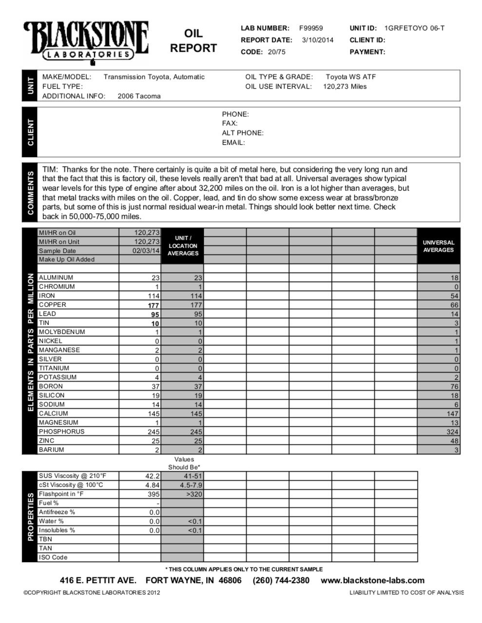

    Toyota OEM WS ATF 120,273 miles

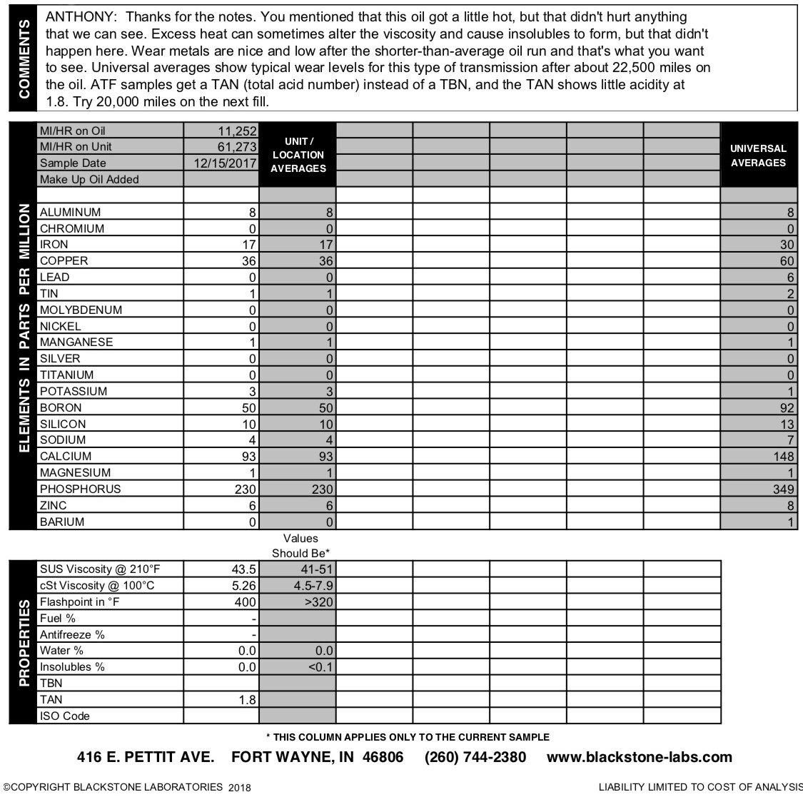

    Fluid was flushed at ~50k, this fluid was sampled when I had my valvebody upgraded. Used Toyota WS ATF both times for the refill.

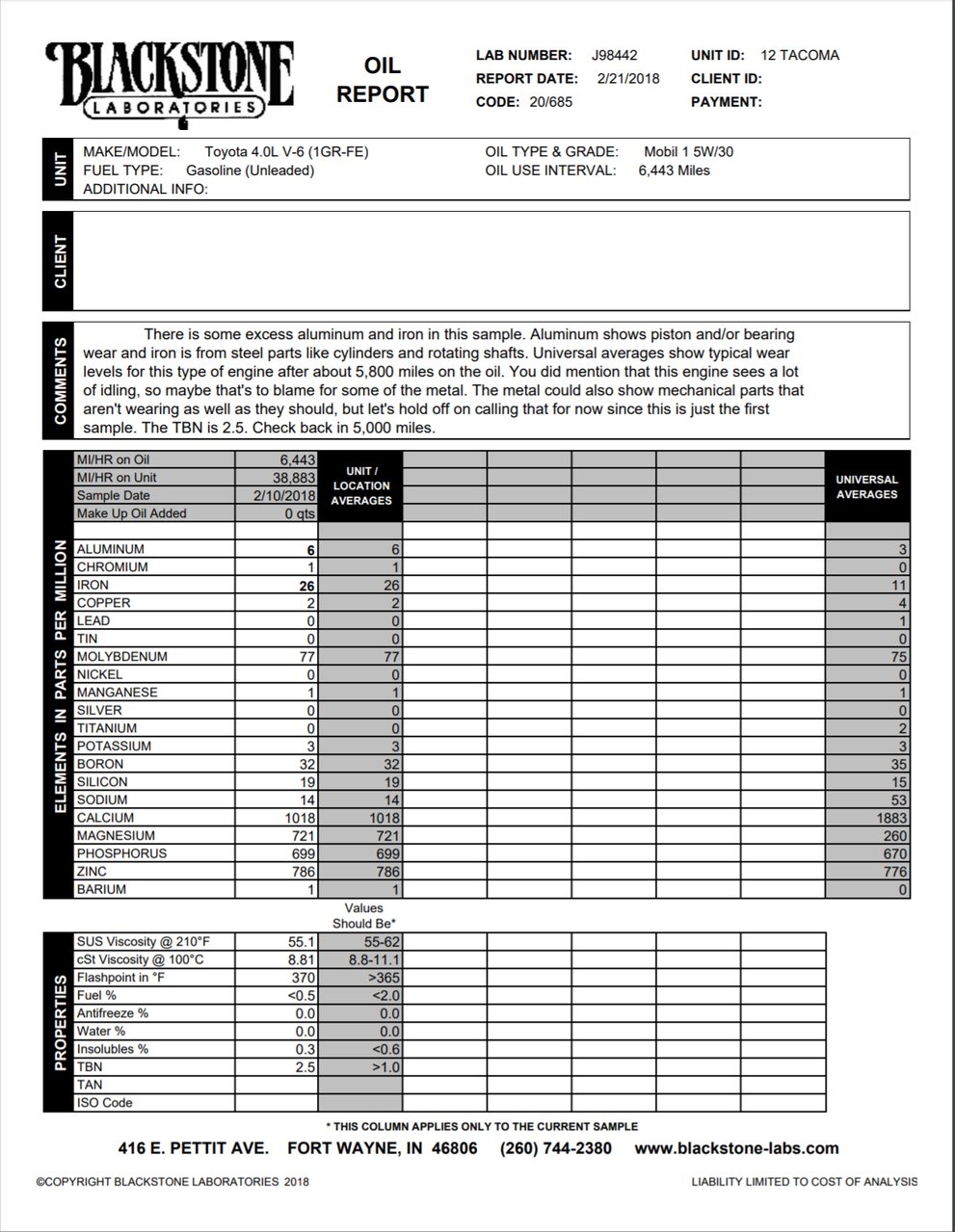

    Not the report I was hoping to see. I do have a lot of idle time and tons of short trips on this oil run. Being my first report, I'm not going to worry about it yet. We'll see what my next one says.

    My 06 w/ 175k got an aluminum reading of 6 too w/ a 4800mi run. They said it was just nit-picking and nothing to worry about. My Iron only read 8 though, so maybe it was the combination of the two that caused them initial concern.
