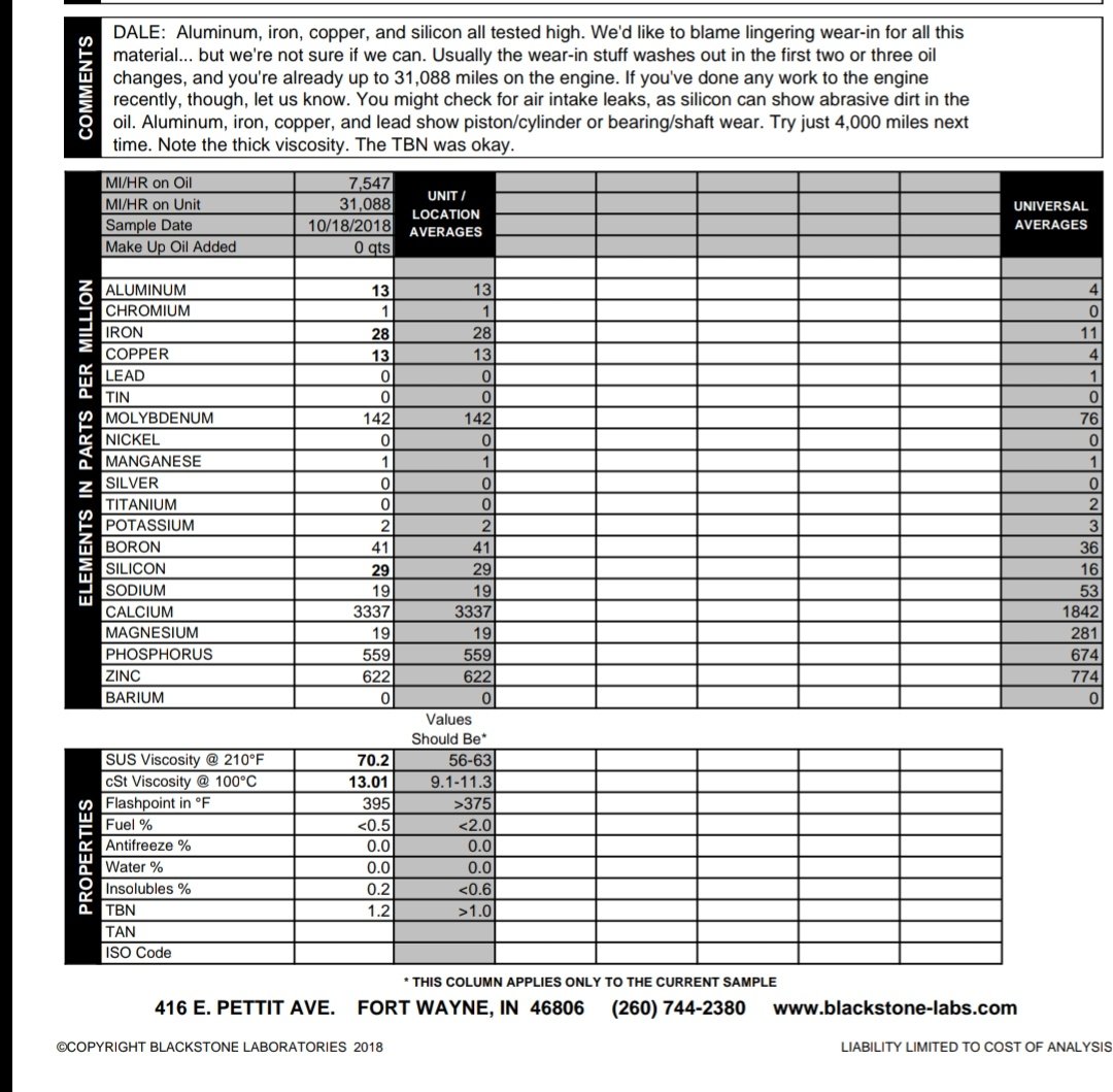

    Received my oil analysis results from Blackstone on the 1 year, 7500mile oil, amsoil SS 5w-30. Results were not good.

    This is a very unusual result for Amsoil SS.
    Do you change the oil yourself? If not, is it possible this oil was not changed when you last thought it was? In other words, if a shop changed it, is it possible they did not?
    I have never seen TBN this low after only 7500 miles with Amsoil. Either there are very unusual operating conditions, or the oil was not previously changed like you thought it was.
    Even if there was an air leak, that would not account for the exceptionally low TBN.

    I changed it all myself. I work about 2.5 miles away so my truck is subjected to lots of short trips. That paired with winter driving is the main reason I started sending oil in for testing.
    Granted, I changed it while it was cold, probably about 50° but the oil was suuuuuuper thick. Took a good 30+ minutes to drain it from the fumoto valve. There is a chance that I pulled the sample from the oil kind of early in the draining process as well.

    OK - so it is certain that this oil really went only slightly above 7500 miles. Still - I wonder if something else is wrong. Even accounting for short tripping, TBN is still unusually low, and the thickened viscosity indicates possible oxidation.
    I think I agree with Blackstone, I would shorten the interval, or at least take a sample earlier - perhaps at half the time, like at 3750 miles and 6 months, and compare those results. It could simply be the oil won't hold up for an entire year under your conditions, and you should change it earlier.

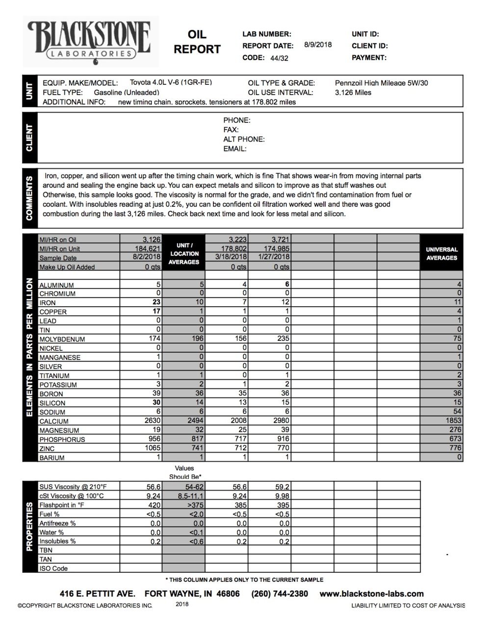

    Here's a series of 3 oil samples from my '07 4Runner, 1GRFE engine. First sample was Amsoil Signature Series 0W-30 with LubeGard Biotech moly additive, second sample was straight Pennzoil Platinum High Mileage 5W-30, third sample was the first oil change after replacing all the valvetrain timing components due to elongated timing chain (original owner wasn't big on oil changes). I haven't pulled a sample since July, it's had 2 oil changes since then so hopefully the break-in metals are flushed out by now.
