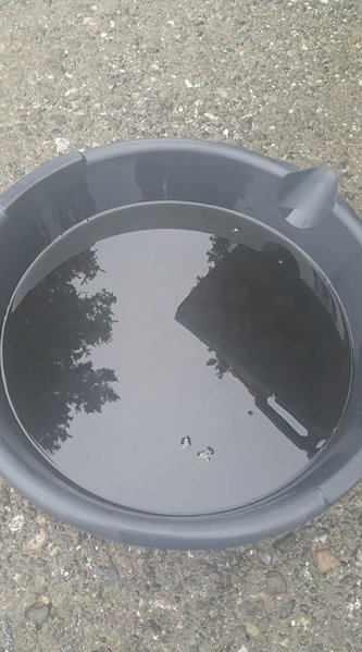

    You may however look into changing out your Differential fluids too; I changed my Front/Rear & Transfer case fluids at 20k miles. Both front and rear were BLACK! and my rear was missing 1 quart of fluid, so much for the dealership to say they've checked my fluid levels every time, that's a big lie because if they did, they would've notice I was missing 1 quart of gear fluid in the rear from the factory. The transfer case was still nice and golden, but I changed it anyways. Went with Amsoil Severe Gear fluid 75w-90 in Front/Rear and Transfer case, good stuff, feels so much smoother after the change.
    Here's a photo of my gear fluid at about 20k miles_ It was really bad; lots of tiny metal particles too.
