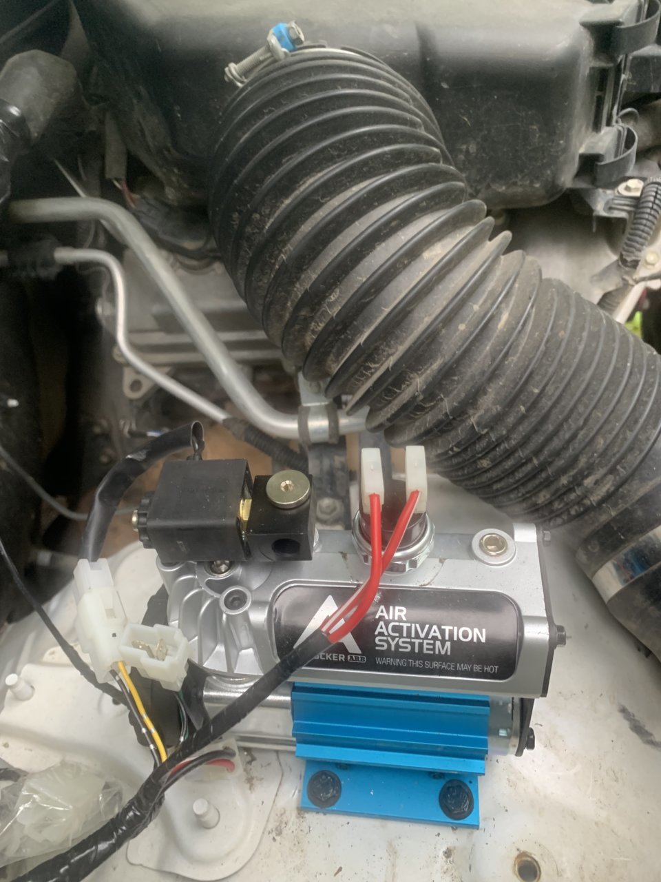

    Compressor is mounted, waiting to get a full day in the shop before i do anything else.

    Mounted, or just sitting in there?

    So the wiring harness for the compressor, did it include hookup for 3 switches? On/off for compressor, then one for front locker and another for the theoretical rear? I cut the f/r locker part from the harness and then shortened the total length to keep it tidy and simple. If I do ever get f/r lockers, I can splice it back in.

    The solenoids are included with the lockers themselves, the Compressor has two deadheaded ports in it allowing you to hook up front or rear locker solenoid when you get the locker itself. The OAL on the wiring portion would be the same regardless of what wires you cut

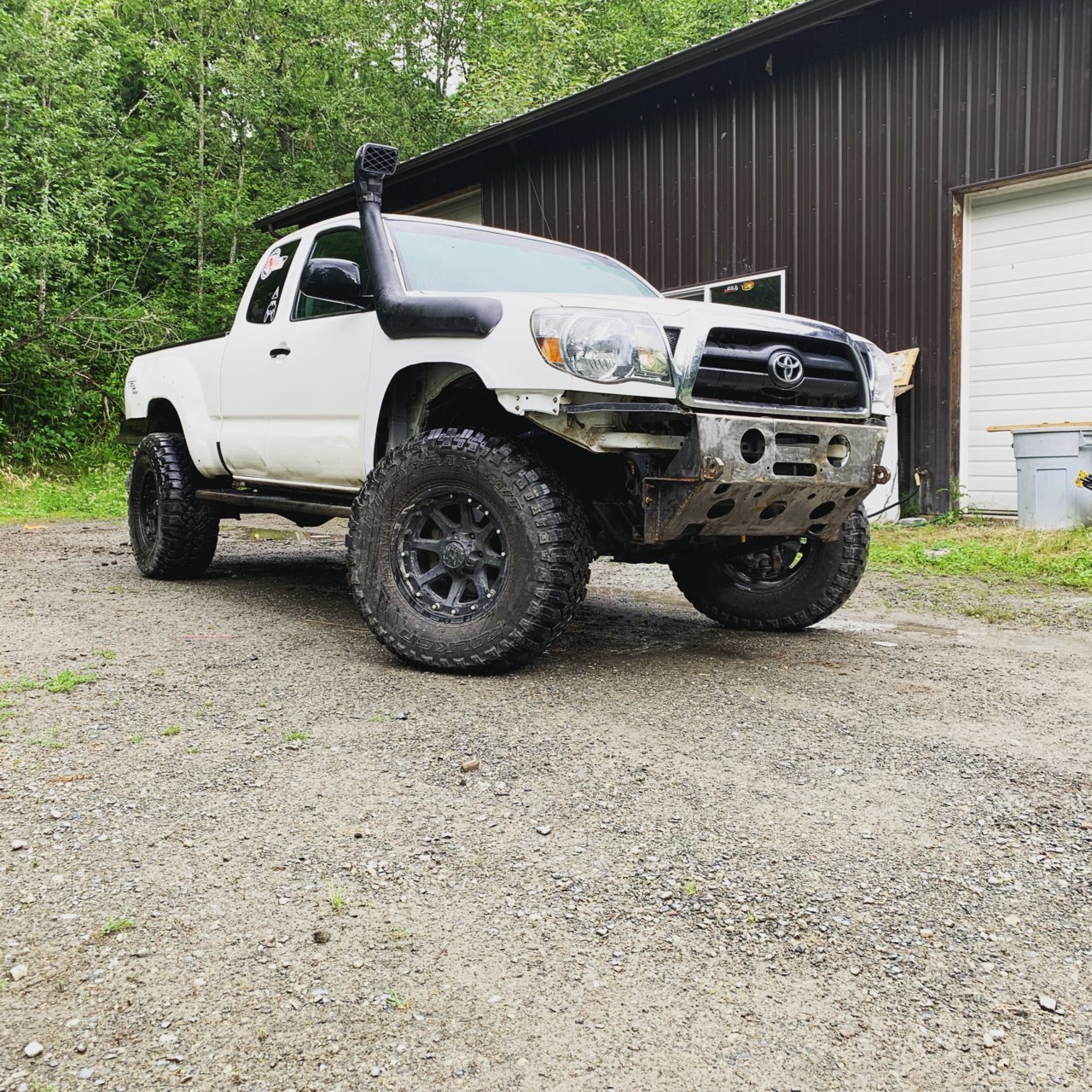

    2wd fenders are painted and installed. Still waiting for some free time to redo my bumper and lockers/gear install.A1FC240A-556C-4B08-94E6-428F523CD39E.jpg

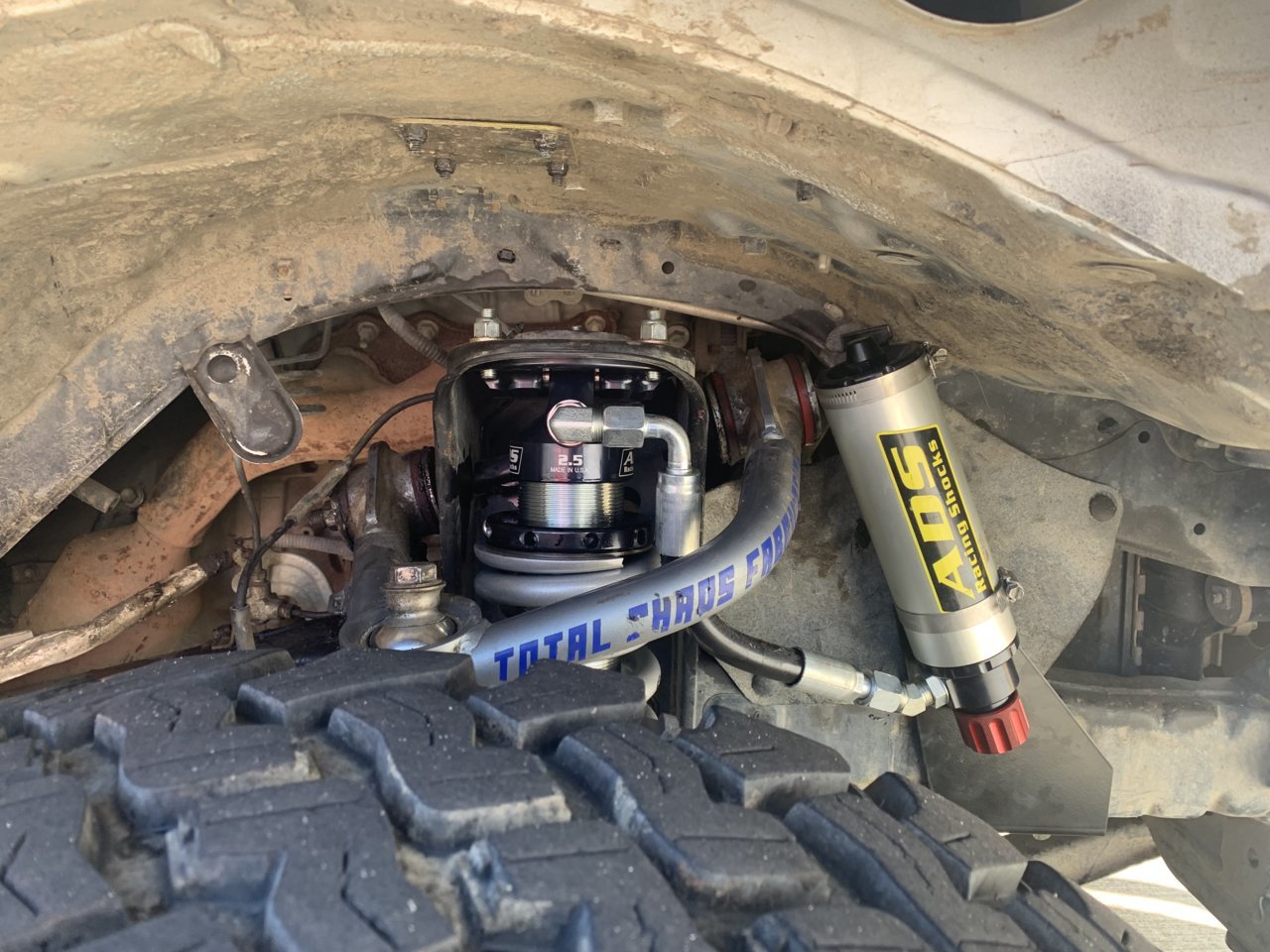

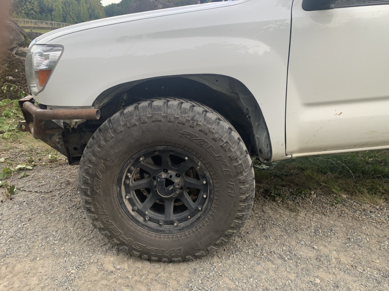

    But i did do this

    Testing

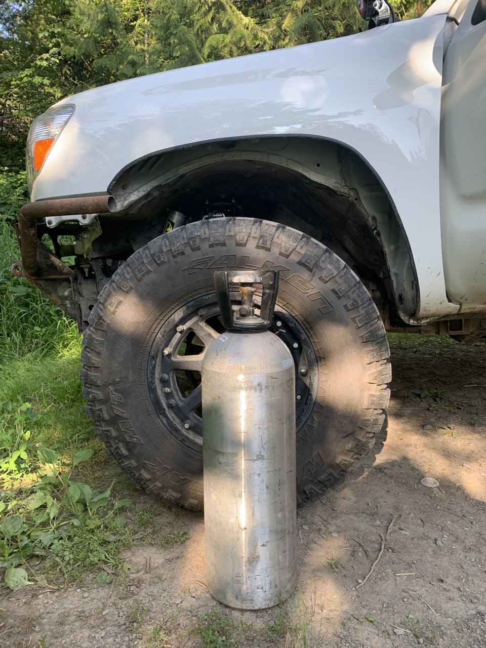

    Got hooked up yesterday, 20# C02 tank for free
    Going to get it filled after work today :bananadance:

    Got the tank mounted...10 to 34 psi in less than a minute. pretty happy with the results
    also i ordered a SOS concepts skid plate

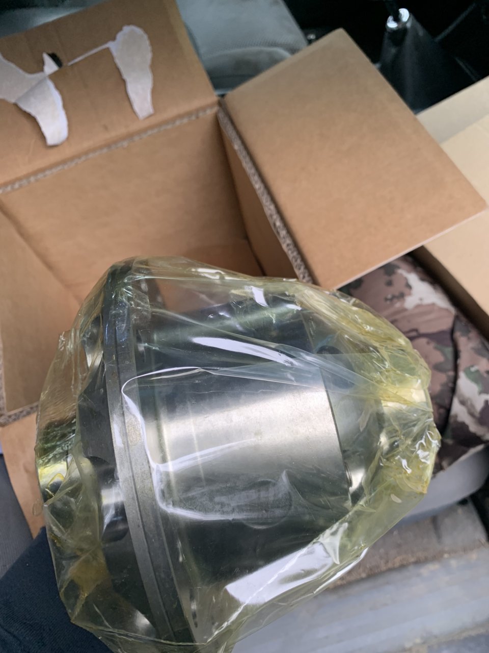

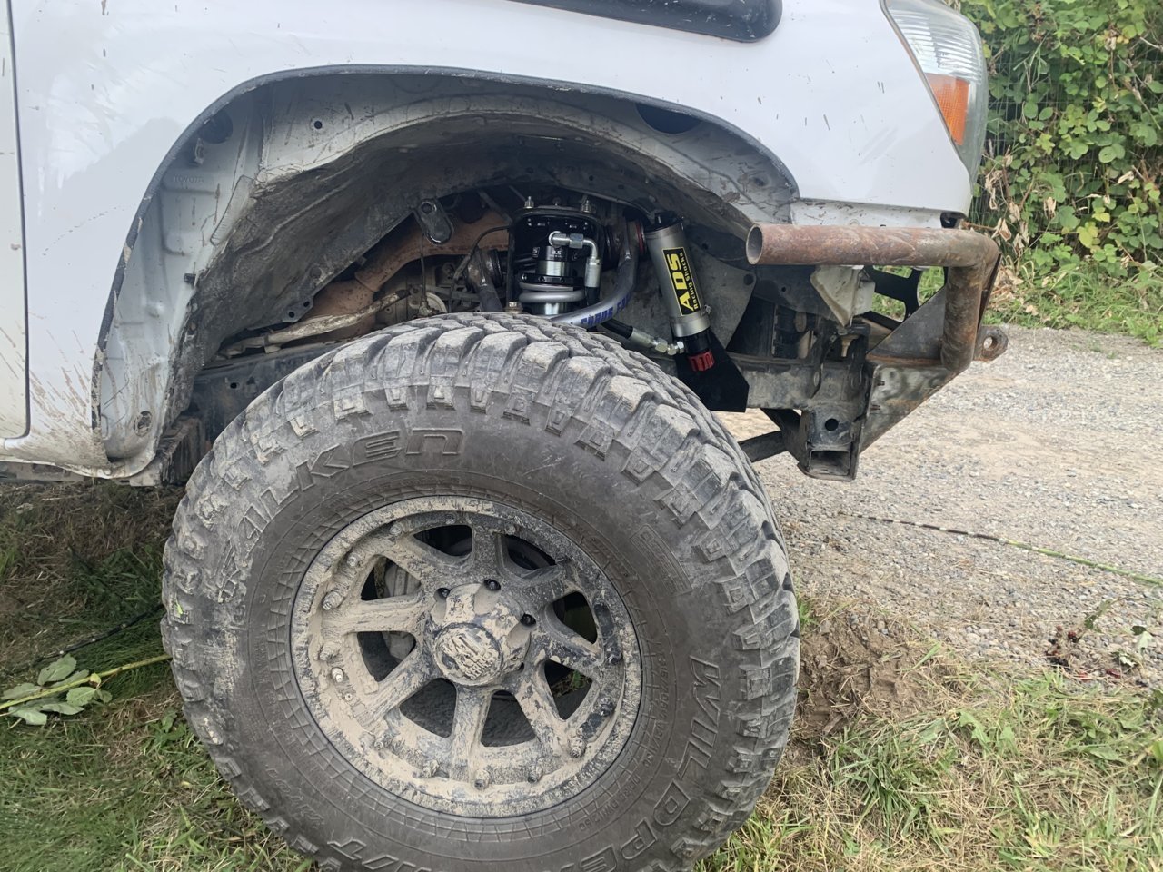

    Welded metal

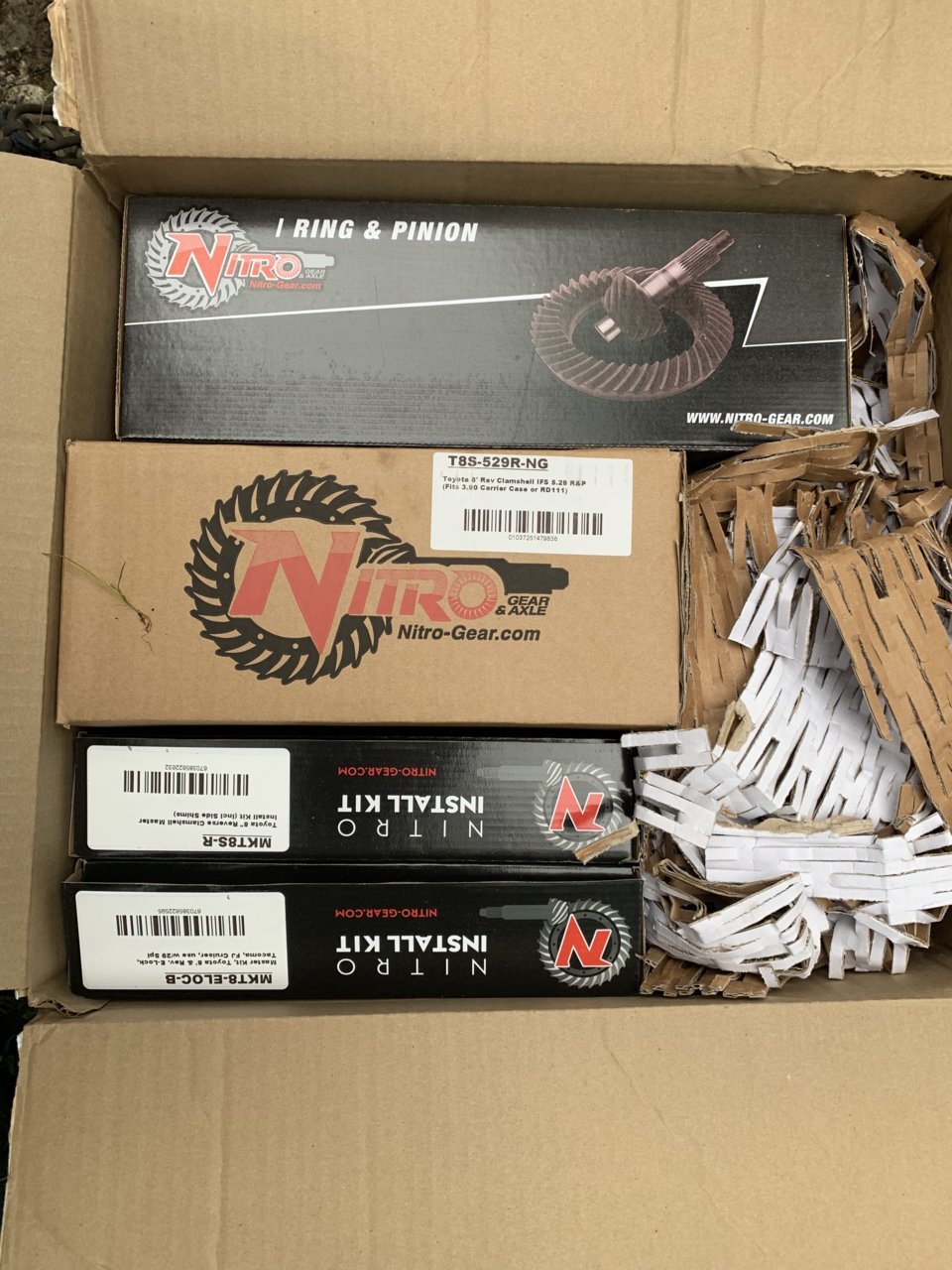

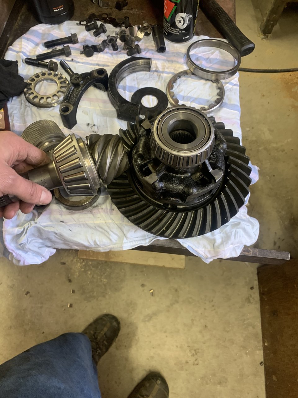

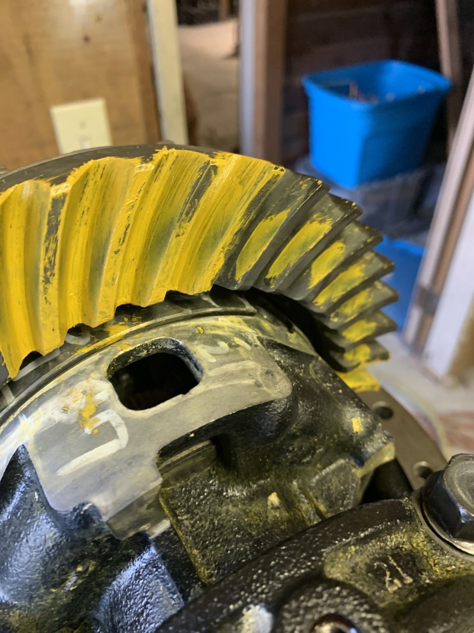

    Well boyo’s it took almost a whole goddamn year but the 5.29’s and from locker are in. Not without its issues. I set up the rear by myself and it was fairly straightforward, the front was a different story...it’s done though. I’ve already noticed a mileage increase and have decided on chopping up the front end for 37’s. Here are a few various pics of the process

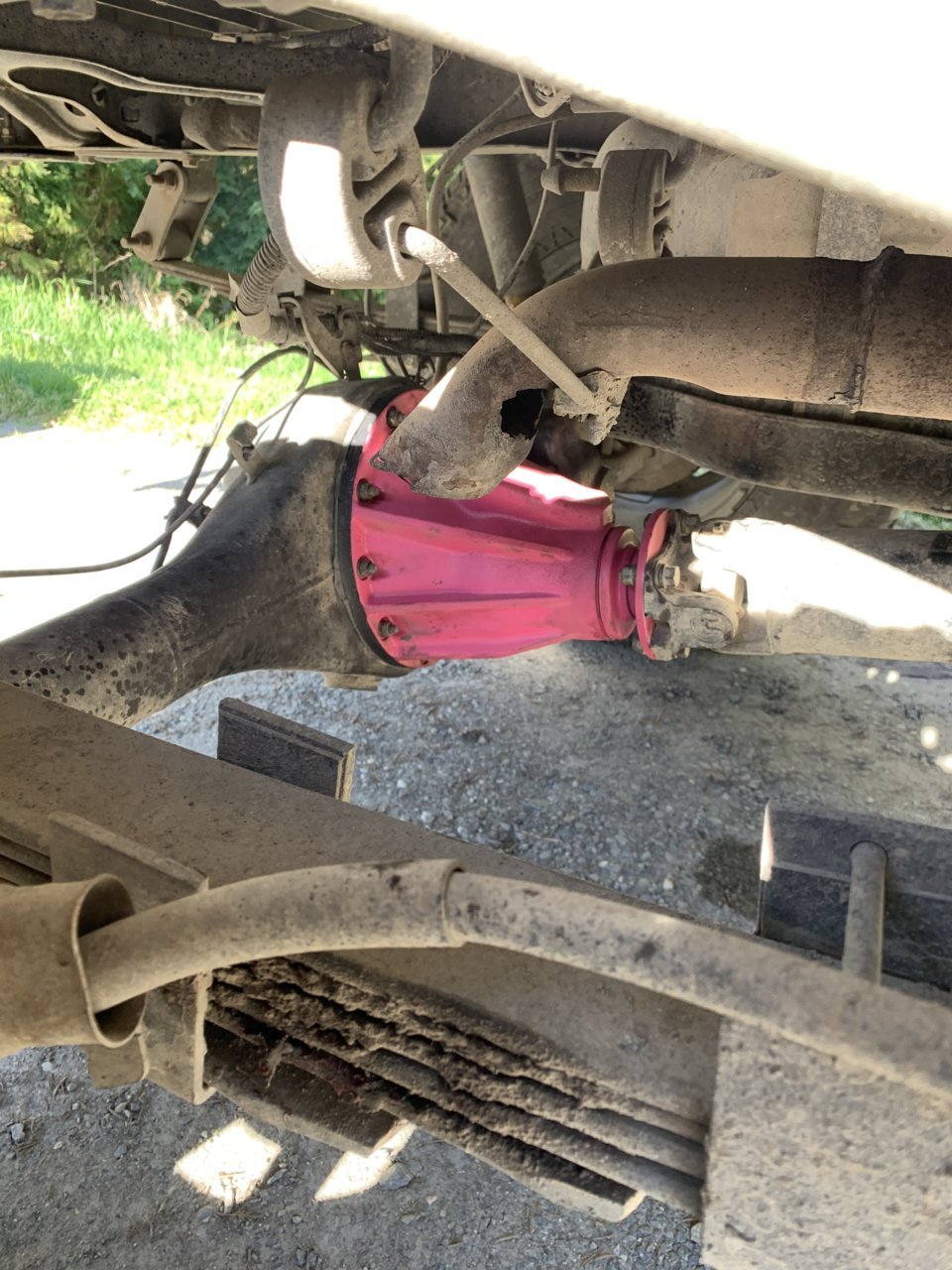

    0D254BBF-6682-40BC-AFBA-818624B475BD.jpg 8520145A-9A1D-42D9-9669-9D30B0F064BE.jpg
    painted it hot pink cause :brianr:
