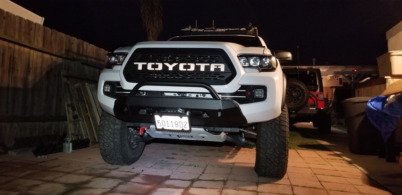

    picture truck almost 90 degrees nose up and in sketchy obstacle. Lots of fuckery involved opening that hood. First, get ladder to open hood since it’s so high up, second, have people holding hood making sure it doesn’t swing all the way open. Not being lazy, it’s the safety, etc involved.
