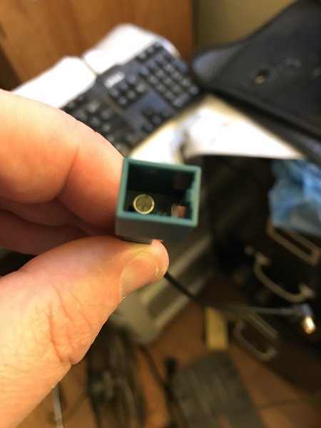

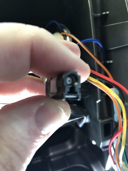

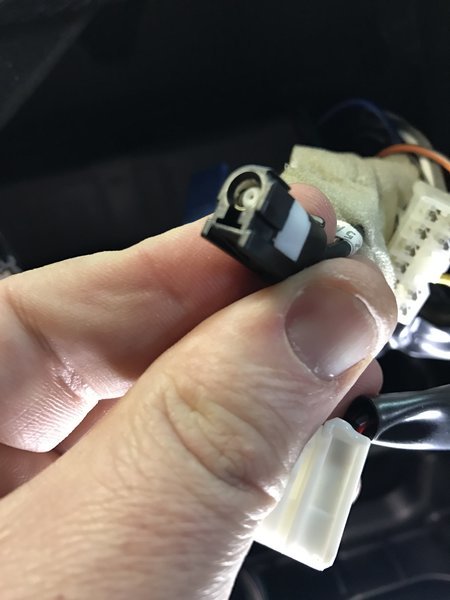

    Not sure if this helps

  5. Jan 28, 2017 at 12:52 PM

    Thanks. just ordered it, and will give it a try

    I just install a new head unit today. Looking at the connector it looks identical to his photo. However I wouldn't be surprised if Toyota changed it just slightly. If so just remove the connector and plug the cable in without the housing. Hot glue it in place and you shouldn't have a problem. I did the same thing when I had my Mazdaspeed3. never had a problem with connectivity.

    Well, i just got the adapters in today, and i believe its going to work. Its kind of like a universal plug that will accommodate and subtle changes to the "pin" and "roundness" of the factory sharkfin plug. Also, it came with the adapter for the factory GPS to my ken wood headunit, so that's a bonus too
