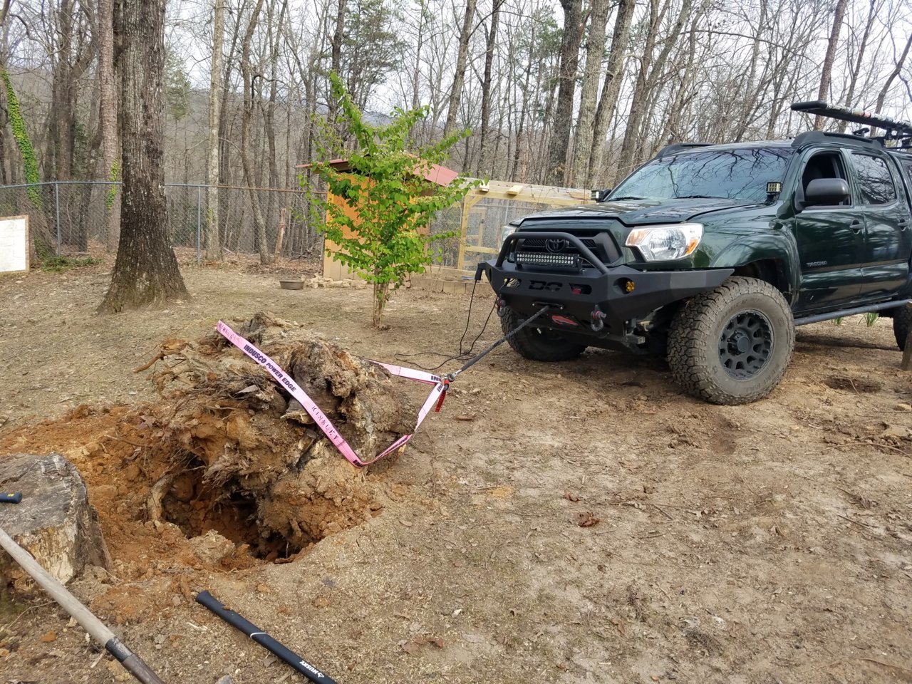

    I put a shorter strap around a stump in our yard and looped both ends together onto my winch, worked pretty well. I had to dig out some of the root sections to give it something to grab onto but I would imagine same principle would apply if you were pulling it out.

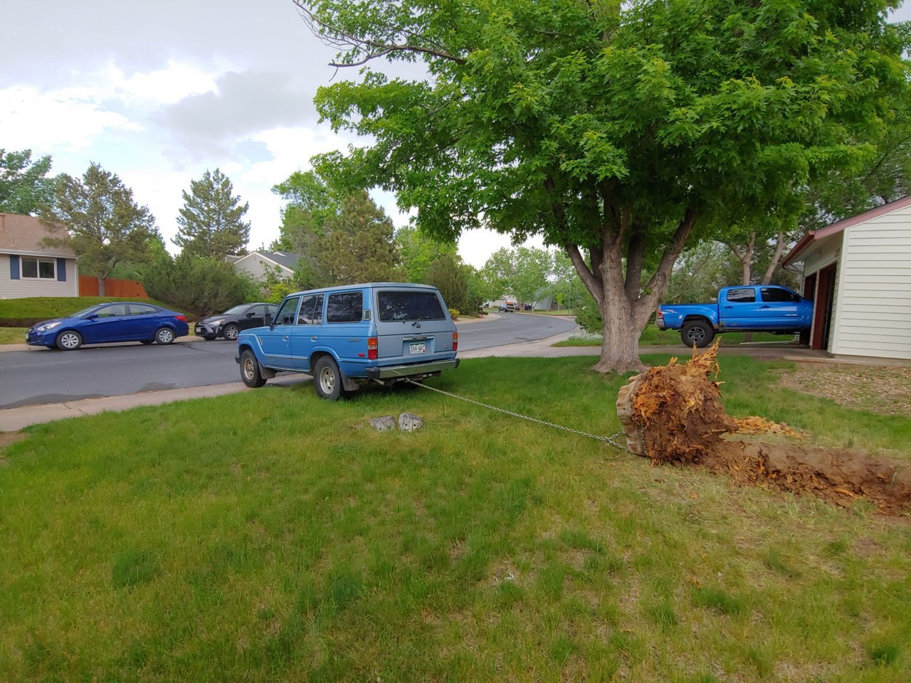

    It's not about power. My fj60 probably doesn't have much more than 80 HP at this point. I use a chain so it doesn't stretch. Slack the chain, get the truck moving about 5 mph and clutch in until the weight of the truck tugs the stump. Back up and go again. I wrap the chain around the tow bar. I've pulled about 20 stumps this way.
    I park the fj on the street and had to move it to pull this stump. I decided to just use the fj since I had to get it started anyway.
