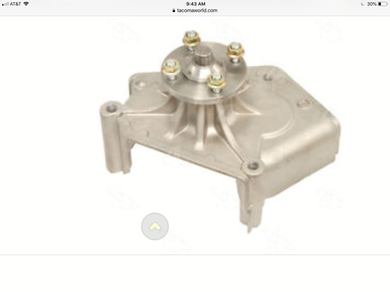

    #140466
    424
    Where did you find the p/n for the fan hub bracket? I am looking at my Toyota part catalog and all I see is the p/n for entire fan hub assembly ($517) (16307-62030).

    Don't forget a new thermostat and gasket.
  11. Aug 16, 2018 at 8:33 AM
    04tacoma trd
    04tacoma trd Well-Known Member
    Oct 16, 2014
    #140466
    424
    It comes in the kit.

  16. Aug 16, 2018 at 8:43 PM
    #16
    04tacoma trd
    Oct 16, 2014
    #140466
    424
    Talked to a couple of dealers today and you have to buy the whole clutch/pulley/bracket assy from Toyota. Anyone have the Aisin part number?

    There are lots of aftermarket ones available, not sure the Aisin number, essentially it’s just a 10.00 bearing on a bracket, I never
    looked into the possibility that maybe there is a way to press a new bearing on there?
