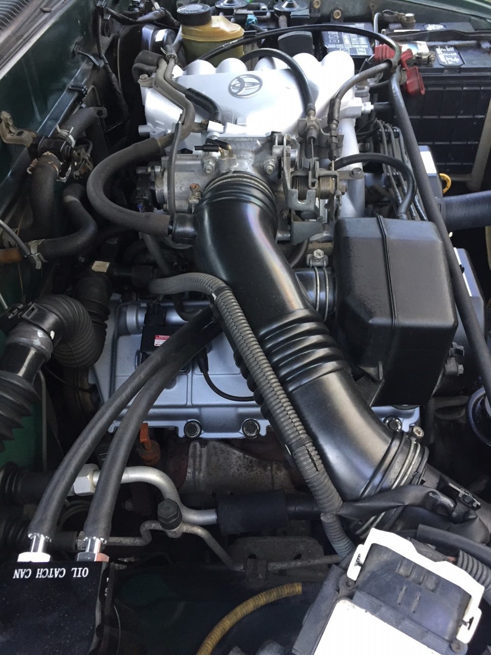

    Just finished my daughter's truck and I took my time and cleaned and painted as I went along. Took me about two days but it looks really nice and clean now.

    What did you paint?

    Intake and valve covers.....did the whole teardown...

    '03 V6 4x4 AC TRD
    Looks awesome!
