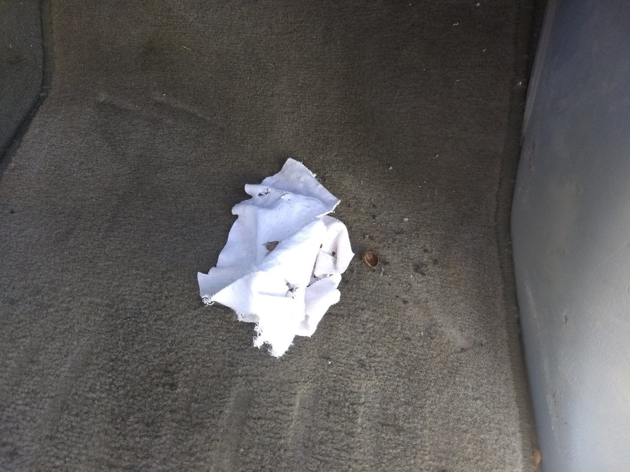

    My fan motor, a few months back.

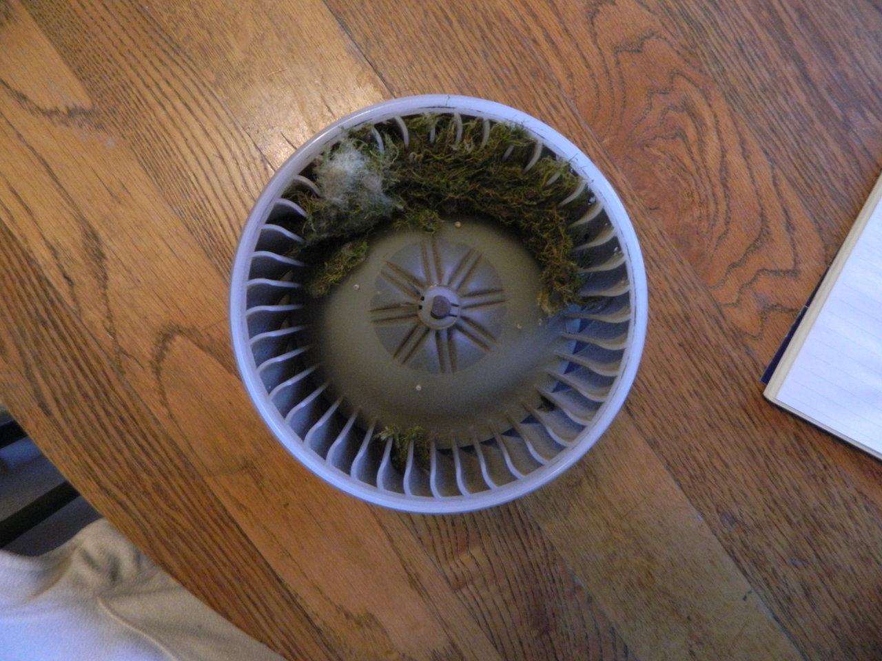

    The problem is my fan motor is fine. And when I remove it and drive around I don't hear the noise. So I'm sure the debris is in the evap housing

    Damn rodents

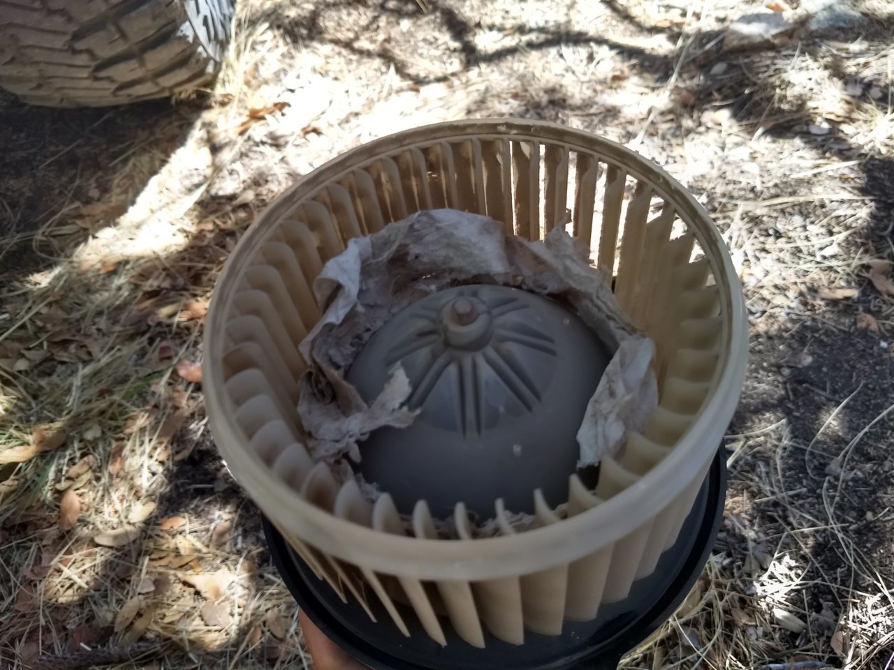

    It's not the hugest pain to pull the dash and disassemble. But it's a half day job. It'll probably be worth the effort to do to get it all cleaned out fully.
    When I parted out my donor truck (54k miles supposedly garage kept) the evap housing was full of crap.
    Actually pulled the blower motor a few hours ago because it sounded like holy hell on any speed:
    Goddamn rodents.
    And what fell out when I opened the recirc door w/ blower motor removed:
    BTW I usually keep the recirc door closed. All this crap fell in once I opened it.
