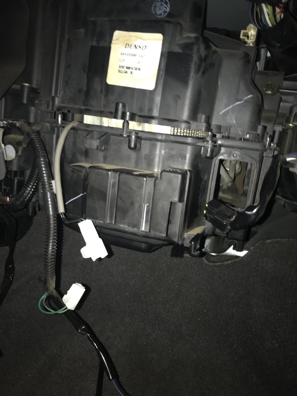

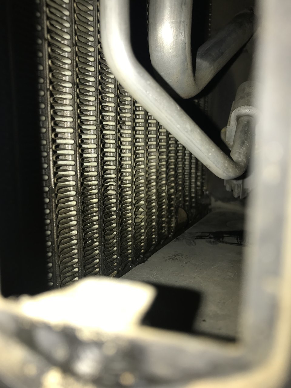

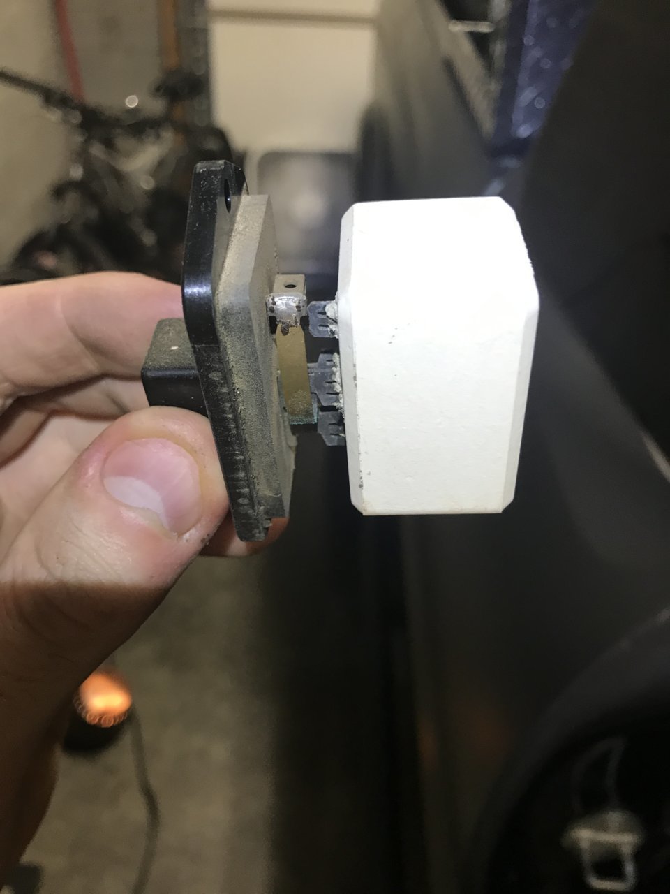

    Just did it. But I pulled the glove box and bracket to pull this thing out to get a little better access. Too many twists and turns otherwise. Definitely some gunk in here.
    What the heck is this thing anyways??

    Have a front-ways view of the electrical connector? Should be a p/n close by. But honestly don't know what that is? Looks like an element or thermostat.

    No clue. But now I'm trying to separate the bottom half of the evap box..

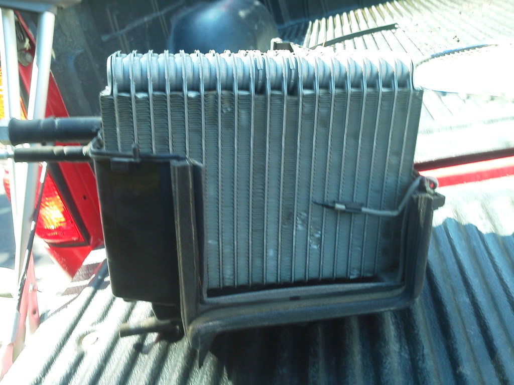

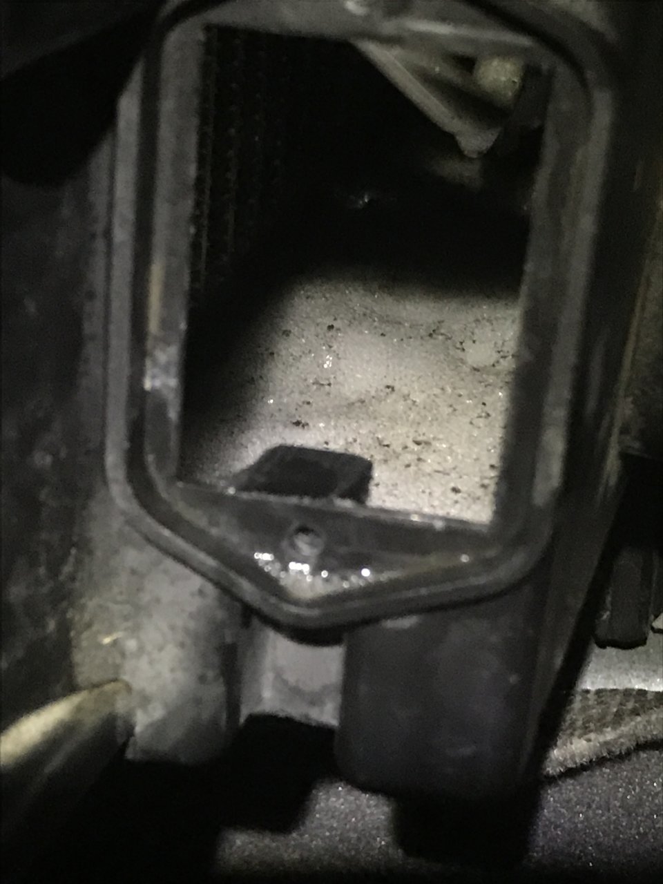

    This shit is idiotic. Here's a pic taken from another write up.
    You would think they would have made it so you could remove the bottom half to clean debris without removing the entire damn thing. Ergh.
    I saw some much smaller vacuum tools at HD that I will try to pick up tomorrow. I can pull down the front half of the casing enough to suck some shit up... not much but better than nothing

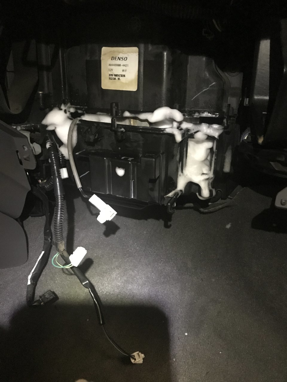

    I'll be sure to report back. It'll at least be easier to spray the foaming stuff in there with the case slightly spread apart.

    That part is the blower motor resister for the fan speed operation. The white ceramic is in the air stream to cool it off.

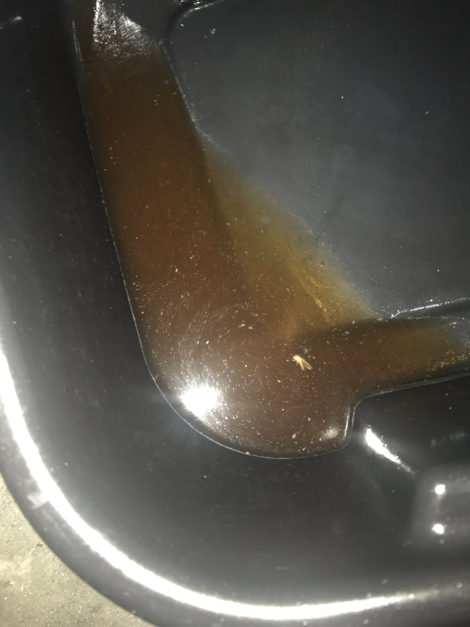

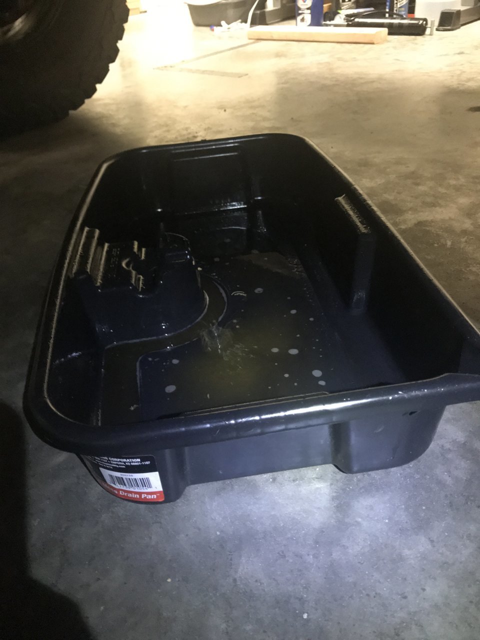

    Here is what is coming out of the drain hole using some AC safe foam cleaner from HD ($6)

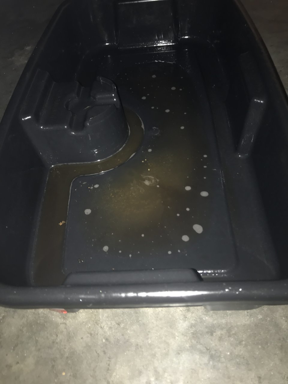

    My poor vacuum.

    Second dose.
