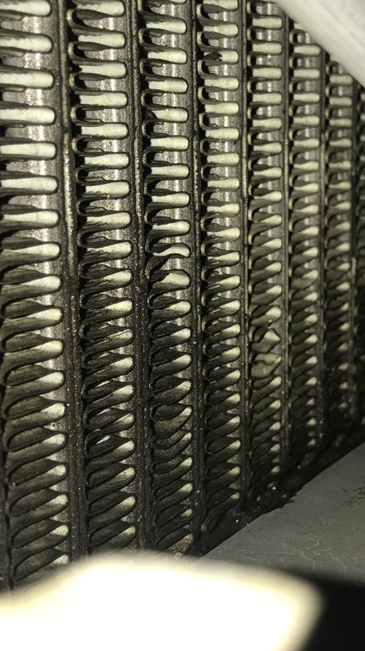

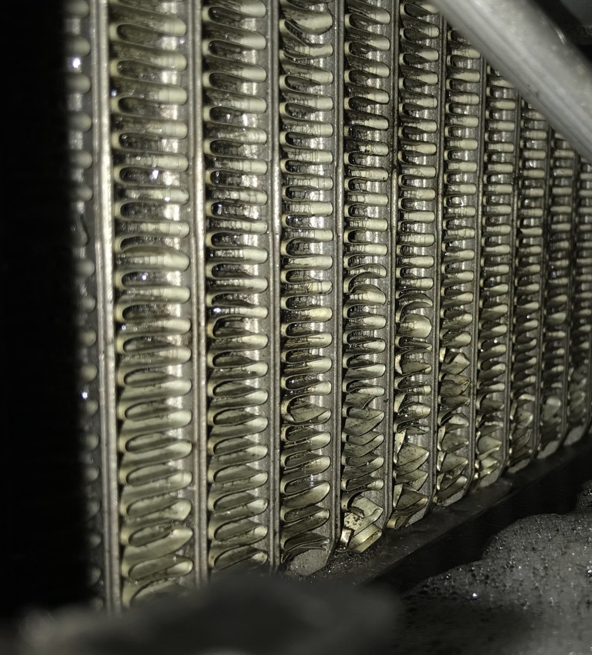

    Putting a third dose in. Evap fins look a lot better. Still debating doing a light flush with the hose.

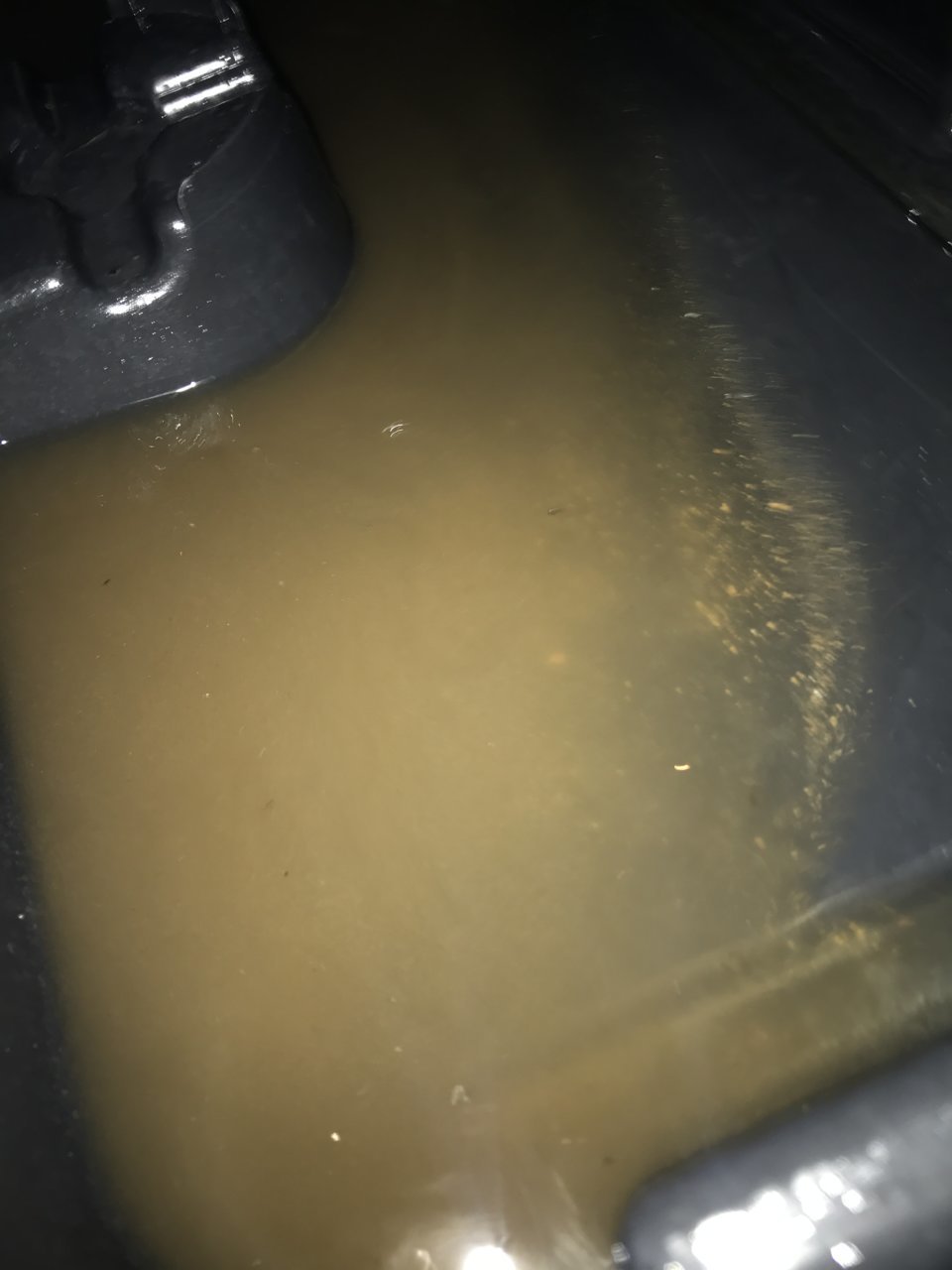

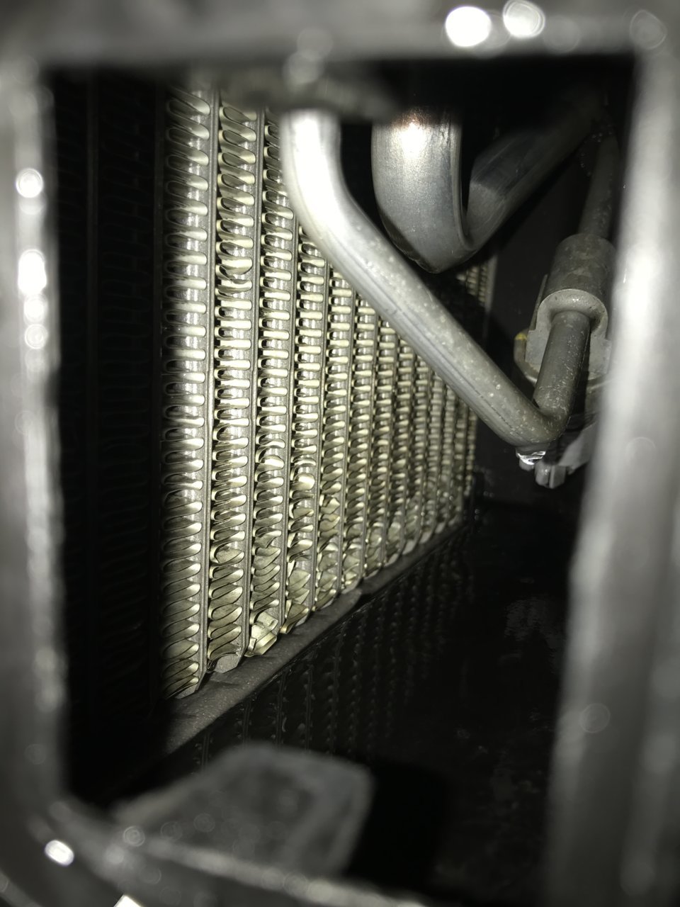

    Before and after

    I decided to do a very light rinse of everything with a water hose to remove the soap and loose dirt. I'll blow out with the small hose attachment and let it dry overnight.

    Unfortunately no gold came out :( that would have made this more worthwhile. At least I know my evap is free and clear of mold and mildew for another few years.
