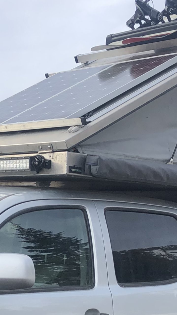

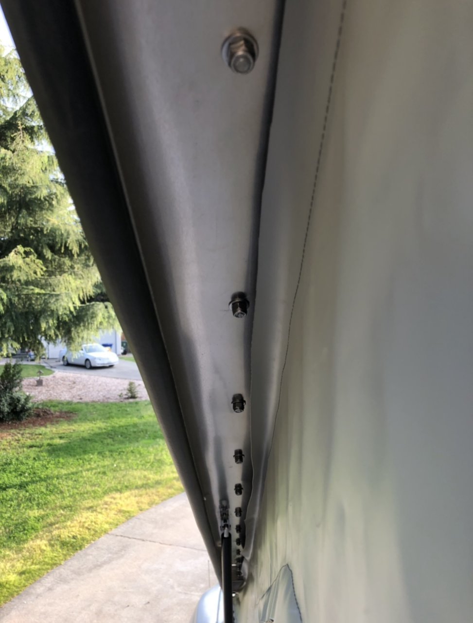

    Yea I used two of these since each wire for the solar is 10 AWG. Outside perimeter of the lid so that its outside the tent
    For people that don’t have a Drifter yet, here’s a pic that shows the outside part of the lid that is outside of the tent. I attached the roof L-track in that same space

    from there did you just slip the wire through the front corner of the tent/

    Precisely, there’s a small opening in the tent in the front corners of the tent
    Edit: kind of a crappy/zoomed in pic, but you get the idea

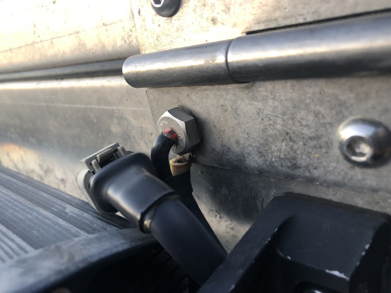

    Really digging the way you cleaned up that extra lightbar wiring :p

    Haha ya bish! That pic was from before it was wired up. Used one of those hollow stainless bolts to clean it up

    Here's a shot of the LED bar wiring for any interested. Slightly bigger bolt to accommodate a 10AWG wire, then grounded it on that exact bolt to minimize the wiring as much as possible.
