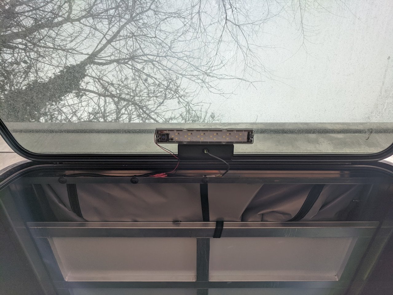

    Finding time to work on the Drifter has been tough with the baby, but I found some time for two small mods today.
    Small red/white, dimmable LED for cooking on the tailgate:

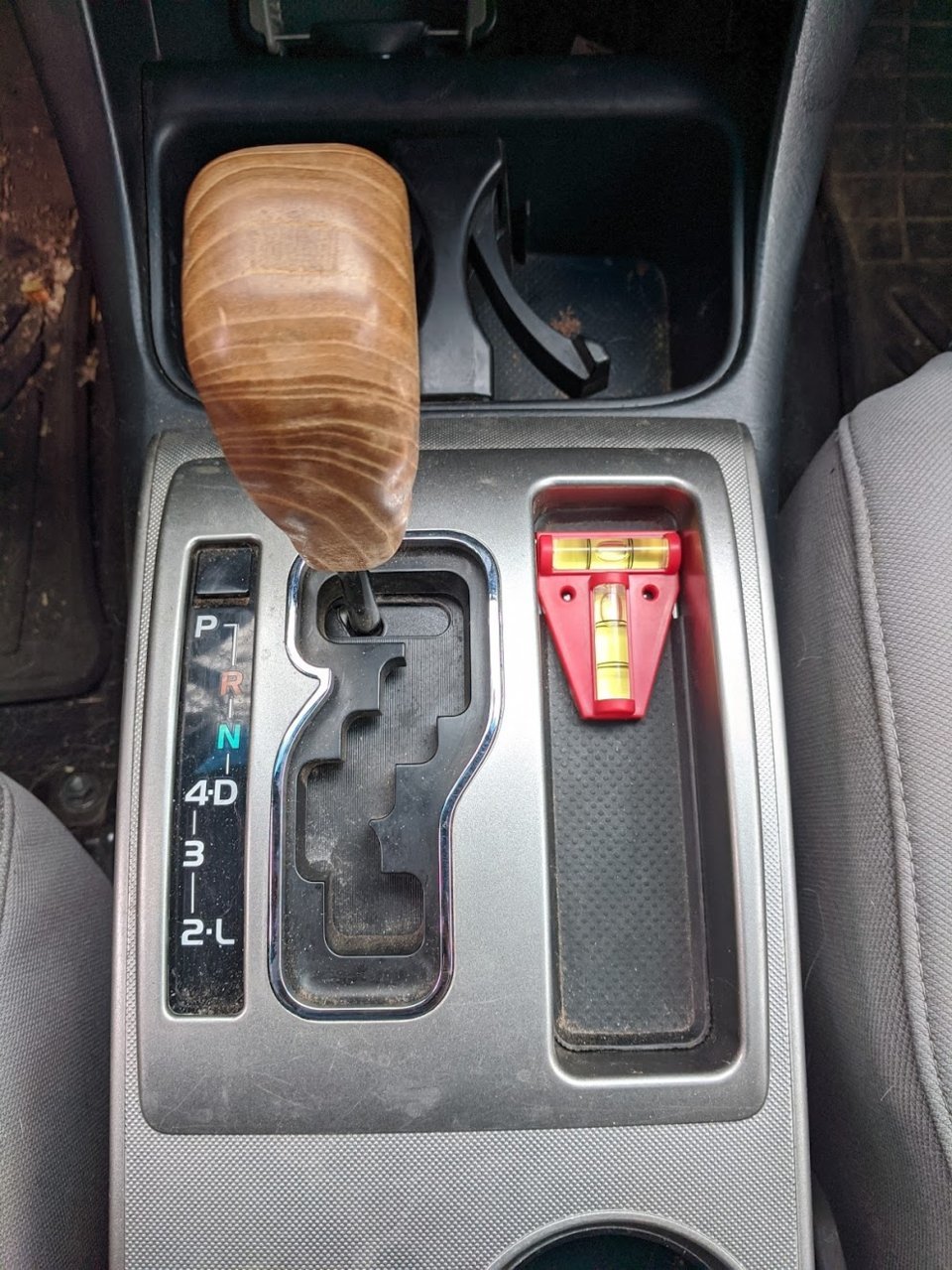

    And a bubble level in the cab for parking at camp:
    n1JXcZG6Tkr-VPyrvUwR0jX80L1xrt_F0CJ1d7tV_f4cec6f7189decc4499fc70363cc92cfbaddfbb3.jpg

    I like the shift knob. Did you make that?

    Yep. It’s basically just a widdled down, sanded, and sealed piece of scrap wood.
    I do have about 23 more threaded inserts that should fit any 2nd gen auto shifter. Happy to share if anyone wants to make themself a shift knob...

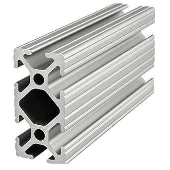

    I mean, just use two 2" x 1" extrusions as cross bars on the L-Track and mount the supdawg on it. :notsure:

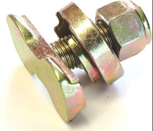

    Well there's one minor thing. If you get L-Track stud, you'll need to check to see if the threaded stud fits into the Corner bracket.
    https://www.amazon.com/Isafe-Track-Fitting-Airline-Track-10packs/dp/B07DJ75RVX/
    https://www.amazon.com/Gripon-L-Track-Double-Threaded-Fitting/dp/B07V4WQTZ7/
    Usually in M8 or 3/8".
    You can always make your own custom end bracket with a bar of aluminum and a drill press.

    https://8020.net/14075.html
    M8 compatible
