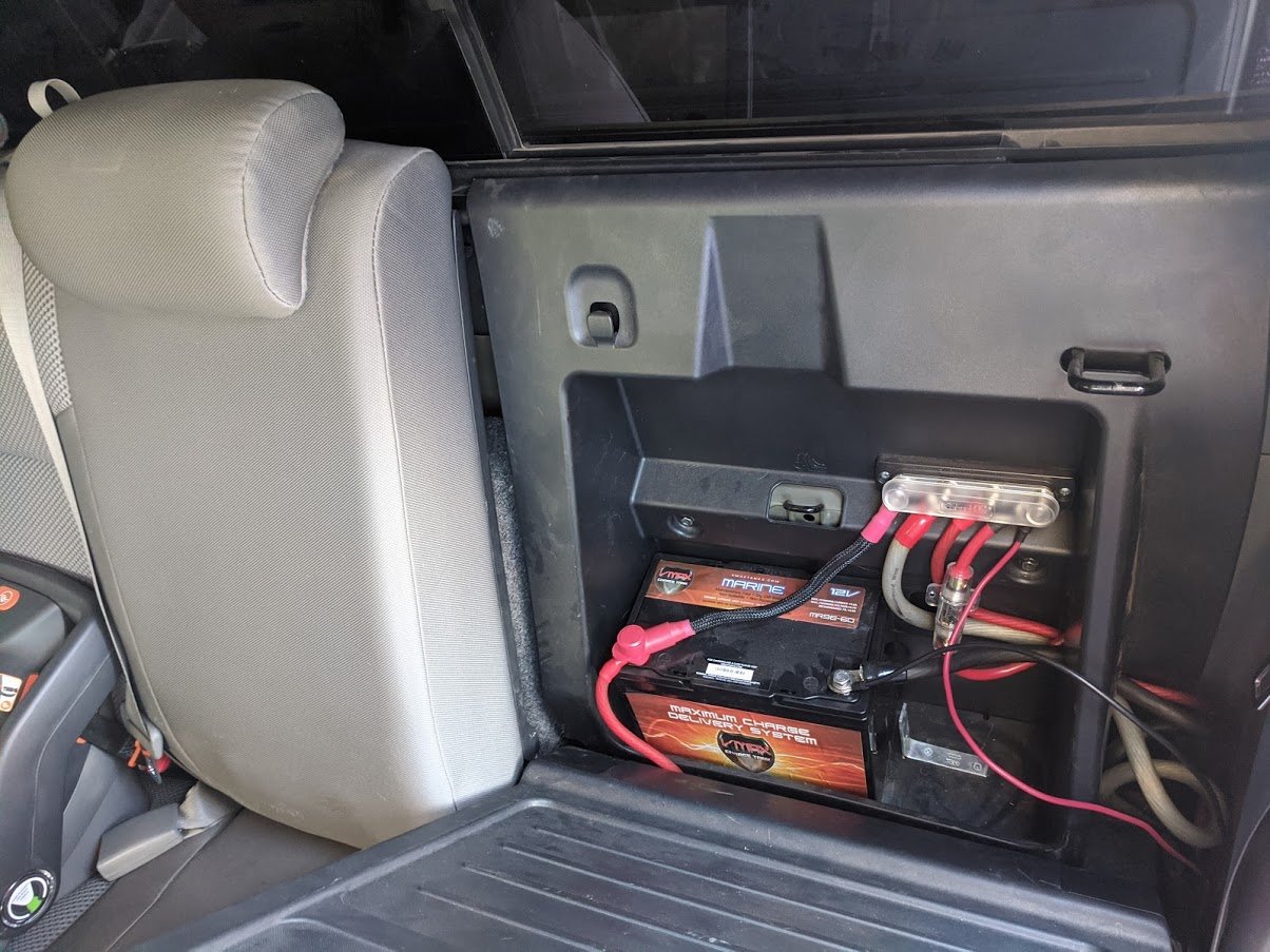

    My house battery is behind the driver side rear seat. It's a 60ah, but I'd probably remove the plastic bin and go bigger if I did it again. I ran the cabling through what I think you're describing as the smallish hole in the back wall of the cab. I used a rubber grommet and corrugated plastic loom to protect the wire.

    Working on a similar project while I wait for my Drifter to be ready. Did you wire your house battery to the alternator?

    Oh this is excellent, so thank you for the info. I was worried about passing that much wire through the smaller hole but it looks like you certainly have done so. Are you tied into your starter battery as well, or are you just solar only? I plan on using the same battery (just a 125ah version) and 6 gauge wire for my runs from the starter battery to the house batter/DC charger and for the run from house batter/DC charger back into the bed/safety hub.
    Just curious, did you have all this wired up before you went to pick up the Drifter? I am hoping to do so, that way everything powered in Drifter can be hooked right in at installation.

    It's wired to the starter battery via ML-ACR. I run some lights, fan, USB charge ports, and fridge via that battery/charging method. We never stay put for more than 48 hours, so that setup has been sufficient for my needs in our van for several years so I haven't bothered investing in anything fancier yet.
    I had this all wired up and run to a fuse box in the bed before the Drifter was installed. Phil provided a loom with all the Drifter's power needs wired at install, all I had to do was add some ring terminals and wire in to my fuse box for power.

    Any chance you documented your wiring setup somewhere or have photos? I did a rear seat delete last weekend and added my Dometic fridge. Now on to figuring out how to power it and this seems perfect :thumbsup:

    I didn't document it and I don't really have any photos of the process. Let me know what you'd like to see/hear about and I can get pics and write something up.

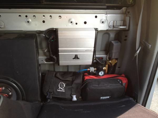

    I have wires for various mods going through pretty much every floor hole with the grommets. If your wires won’t all fit in the one hole at the back seats, use the ones on either front driver or passenger and feed them through the side panels to the back.
    With that one floor hole at the back seat, I wired up an amp, wiring for the OBA pressure switch, along with all the plumbing to/from the air tank and locker

    Thanks! Mostly wondering what products you used for the ML-ACR, fuse box, and other items needed for the job. I have done a little wiring but not much experience so want to be sure I don't miss something and it's all safe / functional.
    I do plan to wire in solar once I get the Drifter, and want to have it ready once I pick it up. Sounds like @wackyhacky76 and I both have the same plan so this would help us both!

    ML-ACR - I don't have the manual switch wired in to my cab since I don't find it too hard to pop the hood on the rare occasions I need to manually link/unlink batteries
    https://www.amazon.com/Blue-Sea-Sys...XLRO/ref=cm_cr_arp_d_product_top?ie=UTF8&th=1
    Fuse block - I used a 6 fuse w/ negative
    https://www.amazon.com/Blue-Sea-Systems-Blade-Blocks/dp/B000THQ0CQ?th=1
    These are useful for managing lots of terminals, but you'll definitely want to be careful about fusing runs of wire:
    https://www.amazon.com/Blue-Sea-Systems-BusBars-100A-250A/dp/B01IHPJAUK
    I ran 1/0 AWG wire from the ML-ACR to the house battery and 4 AWG to the fuse block in the bed. You should really read this thread for info on installing a second battery...https://www.tacomaworld.com/threads...ts-see-them-multiple-batteries-thread.295653/
