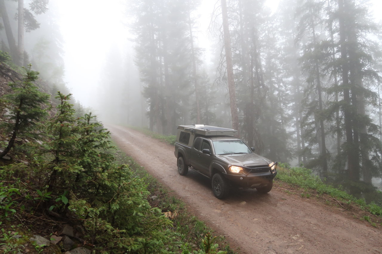

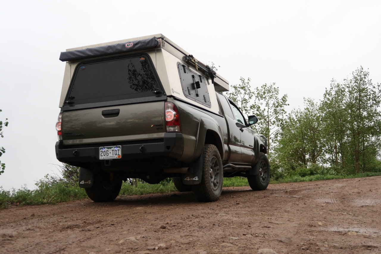

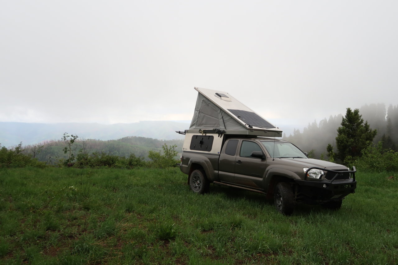

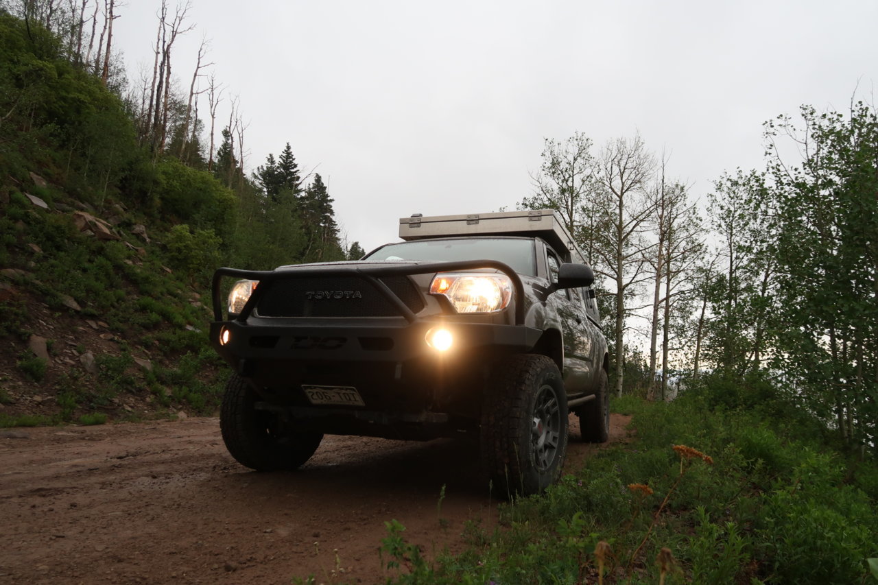

    Things are finally close to done! Painted and installed the bumpers and sliders, and the power system is dialed in. Made some Rotopax mounts for the FrontRunner doors. Drilled one set of the Smart Touring awning brackets to create a HiLift jack mount. I have a few things I'll revisit - removing the airbags I used for my FWC (keeping the Alcan custom leaf pack), potentially redoing the insulation so that I like it better, maybe upgrading the shocks (again), odds and ends - but mostly I'm set for summer in the high country. :)

    Does the hi-lift prevent the frontrunner door from fully opening?

    Yeah, yeah... you're right. Already looking at different suspension setups after 20 miles of washboard today...
    Nope! There's plenty of clearance between the jack and door. There is a little interference with the jack when I have the Rotopax mounted, but that won't be often, only long desert missions with no fuel stations...

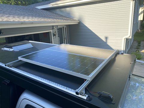

    Because I am utilizing modular and portable things, I built a portable box. It has solar, alternator, and AC inputs. Have 2 each USB and accessory ports. I wired the Drifter to it using an accessory port and move it back to cabin battery when I pull the portable. On this maiden voyage I have the box in the passenger front corner of the bed. So far so good. I’m sure tweaking will never end.
    I am quite sure my 2012 is not VV. I think I found some YT channel that explained it using a volt meter. So far the Redarc seems fine.
