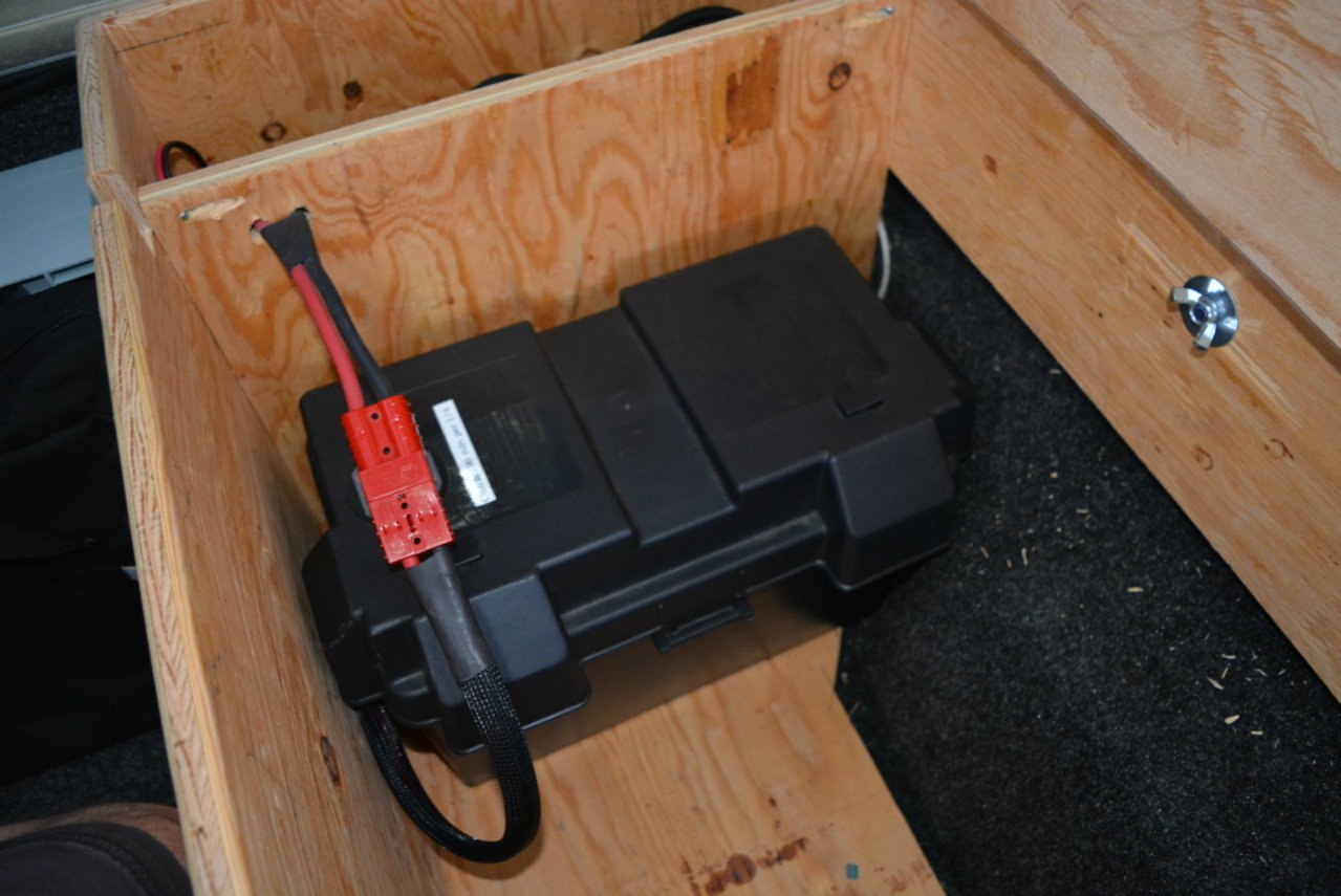

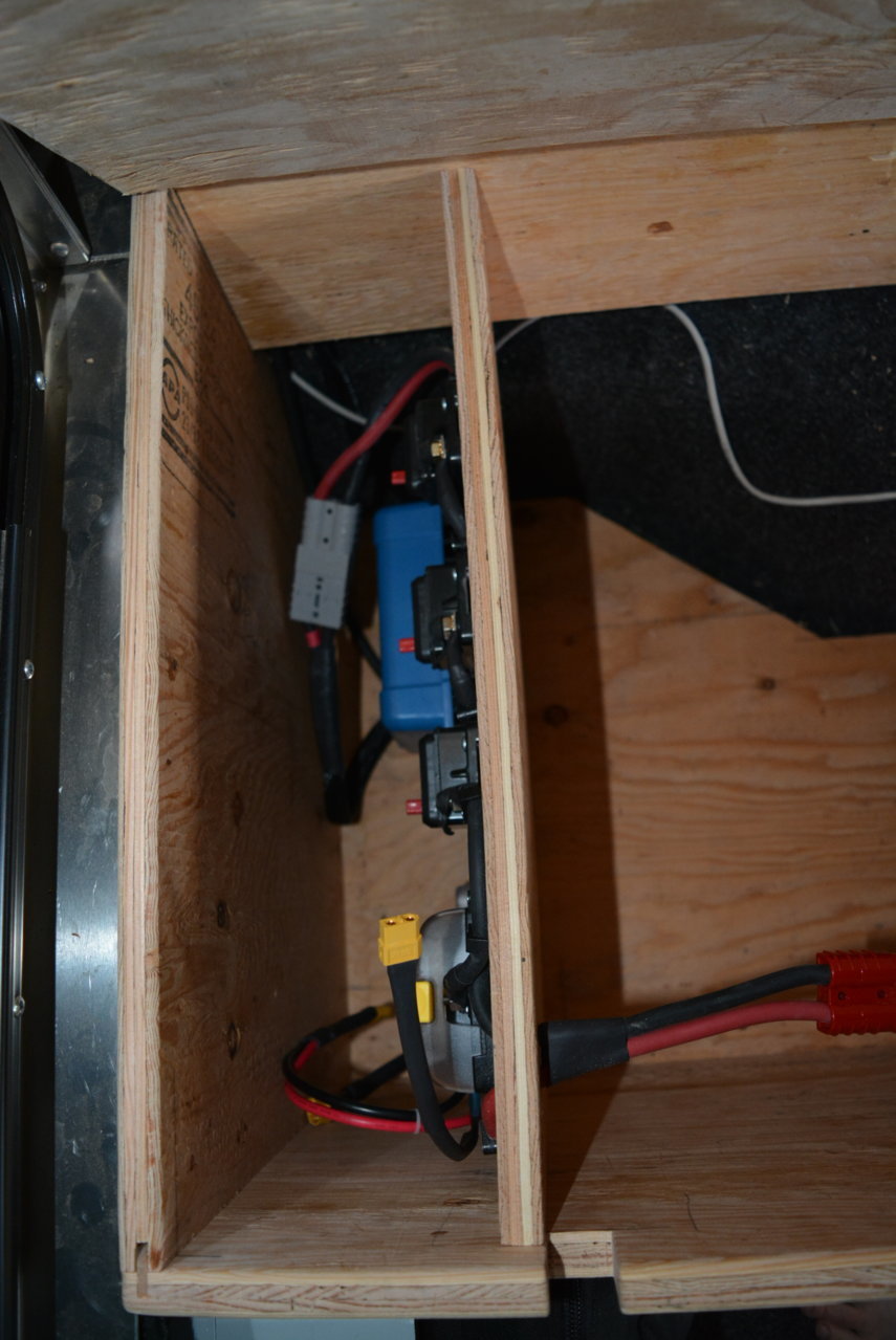

    02FE72C8-D50D-4232-81D2-B5D83B9743AA.jpg @ns7i,
    I am a big fan of a house battery in the Drifter for a couple of reasons.
    1) You lose a lot of voltage running from the hood to the bed and from the panels on the roof to the battery. Lots of people complain that their Solar panels never get anywhere close to their rated output. This is often because their solar run is too long for the size of cable.
    I installed my battery in a removable bench seat module. See my build thread with some photos below.
    I used Anderson connectors so I could quickly disconnect and remove the bench seats from the bed.
    2). Extended battery life. I am running Lithium batteries, so I also like the Drifter bed to keep the heat down. Lead batteries also have better lifespans with cooler temps. If you ever plan to use Lithium, I would recommend the bed option. Lithium batteries are lots more sensitive to heat than lead-based chemistries. If you spend $1000 for a lithium battery to last 10 years, you probably don’t want it under the hood where it’s lifespan will be much shorter.
    That is my two cents.

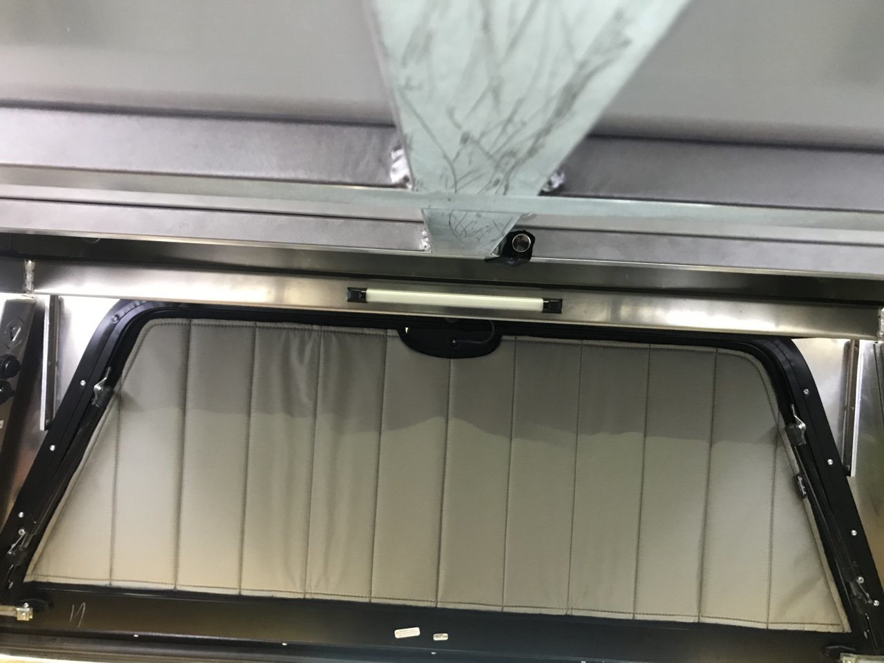

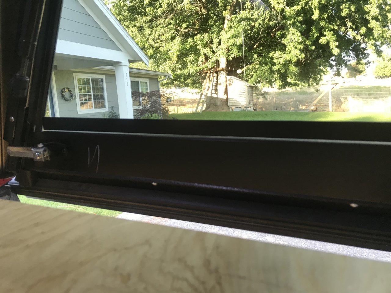

    I recently installed the Strawfoot rear window cover. We absolutely love it and I thought I would post some photos.
    We wanted a way to feel like we had some privacy when in the Drifter and Strawfoot cover seemed like the best option. I will walk through the install process and point out features I like.
    The cover uses magnets on the window and in the cover for attachment. Since the rear hatch is made of aluminum, you have to install some magnetic strips on the window itself.
    If I were installing again, I would pay more attention to sticking these down. Note the small gap between the edges of the hatch and the magnetic strip. This is a source of light leak at night that I don’t know how to resolve.
    There are big gaps at the corners. I used some black electrical tape to seal up these corners. My goal is to be able to have the light on inside the camper with the top down and stealth camp.
    9944863A-E750-4208-A0E5-3530AC6365E3.jpg I also sealed up the gaps around the third brake light.
    When the window cover is installed, the magnets in the cover stick to the magnetic strips on the glass. It sticks so well that we have driven some very rough roads and it doesn’t slide, at all. We chose a lighter color for the interior color so that it would feel too dark inside.
    Here are some closeups of the perfect fit that the cover makes in the hatch window.
    As you can see, from the outside the black side of the window cover makes it look like it is tinted.
    Of course, the proof of the pudding is the night shot. Can you tell that the light is on in this photo? You can see a little spec of light near the third brake light. The spot at the bottom left is the tailgate gap. I am planning to install a tailgate seal to eliminate this point of light leak. From a distance, you couldn’t tell any light is in inside.
    Best of all, the cover folds down into a storable size. The internal magnets cause the cover to stick to itself, making the Velcro strap redundant.

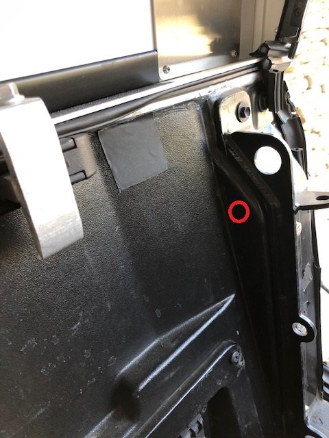

    I'm 90% done with my 2nd battery Redarc install and what left to do is the easiest part but seems like the hardest part. Running two 6AWG wires to the back of the bed. I am not exactly sure where these two wires should enter the bed for a clean sealth look.
    What is the best location to drill a 3/4" hole in the back of the bed? I am thinking of drilling here but I am having a hard time finding a 3/4" OD grommet that fits in this location (see pic).
    Any suggestions and recommendations appreciated!

    I used this guy, but I had like 4 4ga cables to pass through.
    https://www.amazon.com/gp/product/B004K2285E

    I used one of the factory drain holes up in the front of the bed, closest to the cab. I used a plastic wire protector and then caulked it.

    X2 on the bed drain holes, I used those as well to get power from my house battery to the fuse panel in the drifter :thumbsup: I did open it up a bit though
