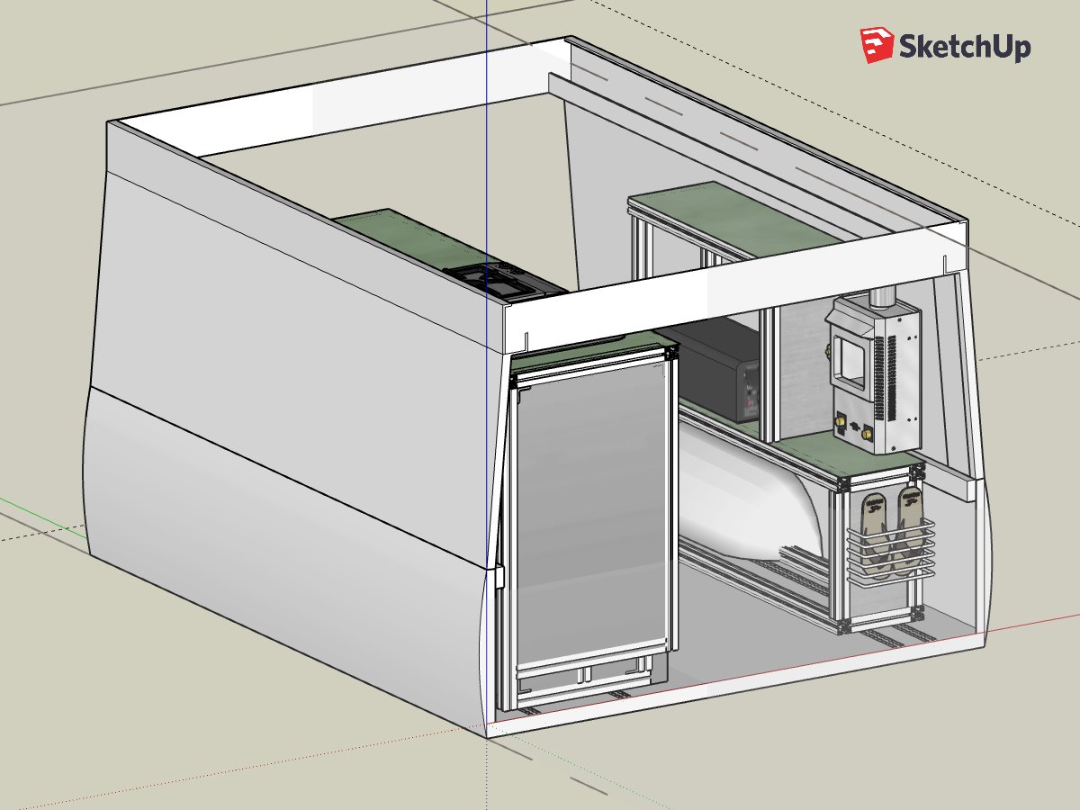

    I’m going to add some heat to the Drifter. A propane fueled “fireplace” made by Dickinson Marine, for sailboats. It’s called the Newport P9000. You may have seen the ZR2 Bison with Alu-Cab camper on YouTube that has one of these installed. I studied the options; diesel or gas-fired, or propane, forced air units, or even the trusty old catalytic heater. After looking at specs and reviews for everything, this little fireplace was my favorite. Similar to the forced-air box furnace types, it is a direct-vent appliance so it brings in combustion air from outside, and exhausts the flue gas outside; no air is exchanged inside the living space. Here are a few bullet points that make it a good fit for my particular application:
    • I have a small area to heat (maybe 250 cu. ft.) The output for the P9000 is 3200-4500 BTUs. By way of comparison: Buddy Heater (4000/9000 BTU), Propex HS2000 (6500 BTU), Webasto Air Top 2000 (3100-7000 BTU). My camper is insulated in the places where it can be, and I just want some supplemental influence on thermal comfort; I don’t expect it to be super warm.
    • The P9000 does not require electricity to operate. It ignites manually, and has a small 12VDC 2-speed fan that is optional to run if you want to circulate air, but it’s not required.
    • I will have a single 105AH auxiliary battery with 200W of solar panels. It is not uncommon for cold camp conditions to be coupled with overcast days, so conserving battery power is important to me. The forced-air units require power draw for the controller, thermostat and fan. The Propex HS2000 specs state 1.6A while operating and 0.04A standby. That’s sort of like having 2 fridges running at once, if your like me and also keep a fridge on board. I like the idea that I can supplement dry heat to the Drifter without using any electricity.
    • Related to above, it is possible to provide heat with no (fan) noise.
    • Sealed (direct vent) unit, so no condensation issues like the catalytic heater.
    • Runs on propane. I decided this would be my fuel of choice for cooking / heating. I’m not concerned with the potential altitude / temperature related issues for my particular situation.
    • Very frugal with propane. Runs 7 hours on 1 lb of propane (low) or 5 hrs (high). The Propex runs for 3 hours on 1 lb of propane (adjust these specs for altitude). I have a single 11 lb. Propane cylinder, so this is a plus for me.
    • Perhaps the thing I like most is the ambiance-factor provided. Enjoying the flicker of flames from a tiny fireplace inside the camper.

    Very Cool. I have been waiting to see one of these adapted to the Drifter ever since I saw that Alu-cab video w/ one. Good luck & anxious to see how it turns out.

    I love the Dickensian unit, but couldn’t figure out a good way to cut a hole for the vent tube. Where are you thinking of sending the exhaust? I am currently leaning toward a Propex mounted under the pickup.

    You should ask Phil and Iggy about the propex setup they have been working on. I think they may sell it as a kit? I’m not entirely sure though.

    That is certainly the main challenge with this project. Dickinson provides a semi-flexible stainless steel direct vent that is a tube inside a tube but you can't bend it in a tight radius. The outer tube is 2.5" diameter and used for fresh air intake while the inner tube is 1" diameter exhaust. The inner tube is held in the center position by a spring coil that goes between the two tubes. The distance from the top of the heater to the location where the vent needs to penetrate the Drifter wall is very short. So, the plan is to use a short section of the tube, fitted to a modified / custom piece that will be attached to the camper wall using flanges. I'll have to create a 3" hole in the Drifter. On the exterior side, the flange will provide a mounting surface (sealed weather-tight to the camper) with mounting studs. When the heater is not in use, a low-profile cap will be attached at this spot. When the heater goes into service, the cap comes off and the remaining length of the Dickinson flexible tube will get attached. It is rigid enough to hold shape while being able to extend out and away from the side of the camper slightly. Dickinson provides a special flue cap fitting with separate inlet/outlet rings for intake / exhaust. This will go on the top of the tube. So, if all goes as planned, this exterior "chimney" will be removable and stowed when not in use.

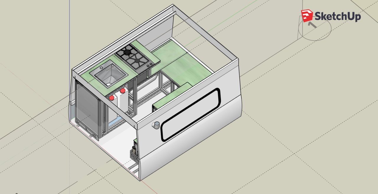

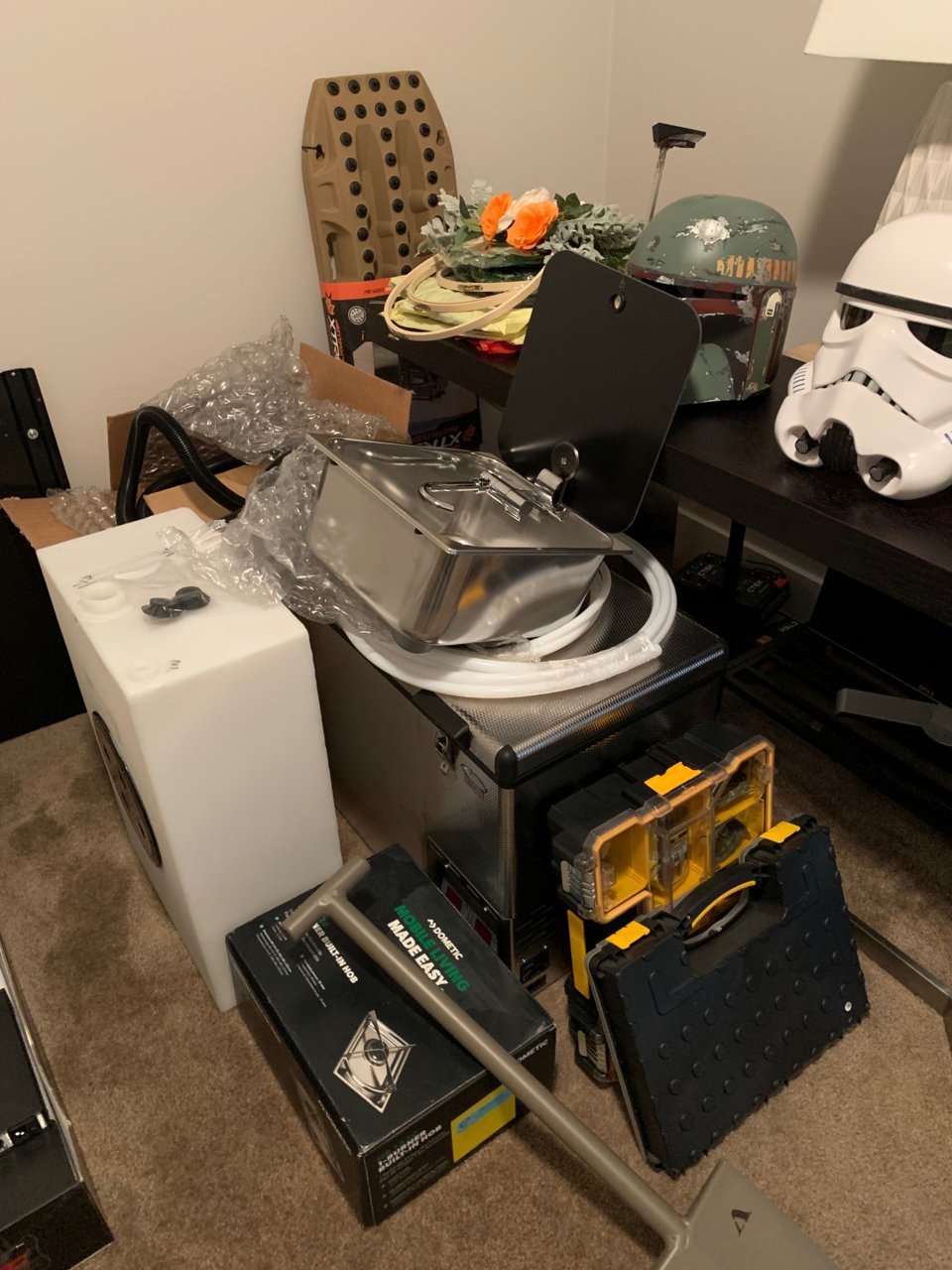

    Wish I was skilled enough to use sketch up. I am doing an 18" deep-34" tall counter on the left side with a sink and dometic burner. My National Luna 60L Fridge/Freezer will be elevated so that the top of the lid is even with the counter also installed on the left. I already ordered the 8020 for the fridge base. My house battery will go under the fridge. There will be a 20" aisle and then a 65" x 24" couch on the other side with a Lagun Table mount that can be elevated to 34" for additional kitchen counter or used as a dinette. A 15 gallon water tank hides under the couch. My wife hates getting out of tent/camper on a 40 and below morning to make coffee or cook breakfast so one of her requirements was that we were able to do that inside in the warmth of the Propex.
    This is my Nomad staging area. Please hurry Phil... my wife has other plans for the second bedroom.

    Very cool. We are working on some similar things. I'm also planning for a full-height cabinet on left, with a sink and burner, using 80/20 for framing. I've had a heck of a time finding a single burner that looks decent, though. Yours looks really nice. Please share your model # if you don't mind. Seems like Dometic is out of a lot of stock when I was looking at their built-in cooktops and sinks recently. Did you have any issues getting it? I also have a Lagun table sitting here waiting patiently to get involved. No fridge in the Drifter for me, though. It lives in the Xtra Cab.

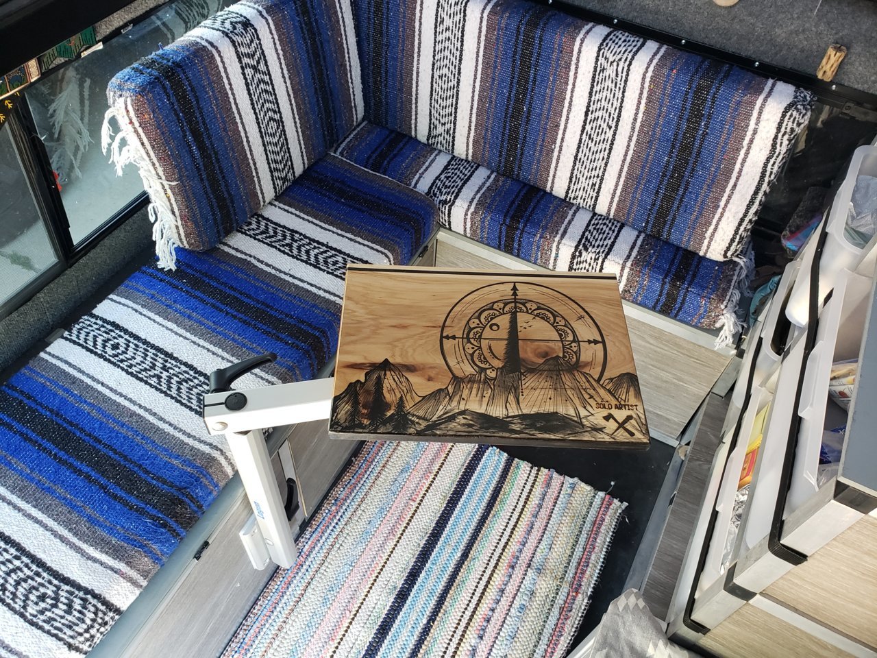

    cwhet10
    cwhet10 IG: badassbrunette
    Aug 11, 2015
    #161566
    789
    Cristin
    2015 Barely Stock TRD Sport
    Lagun Table FTW!
    ORMarine, Toynado, Eazy.E and 9 others like this.

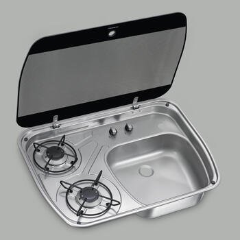

    That's awesome! I bought this... https://pantherrvproducts.com/dometic-smev-hb1320us-euro-single-burner-rv-propane-cooktop. It has been out of stock for months. I actually had a link that I OCD'd checked several times daily. Finally, after 4 months of that I called them and asked when they expected them. The person said "I think we have one left in the back... let me check." They did and I snagged it. :)
    I wanted a burner that had a glass cover like my sink but they were all too big for both to fit in a 30-inch long counter and still have a bit of working surface.
  16. Oct 3, 2020 at 1:18 PM
    #4276
    kalieaire
    kalieaire i didn't know they stacked sh*t that high.
    Jun 30, 2012
    #81653
    2,866
    Santa Clara County
    '12 TRD Off-Road 4x4 AC V6 6MT
    Adventure Trailers Atlas, Demello Sliders, BAMF Skids, PelfreyBilt Bumpers, SCS Ray 10
    I like the 9722R. It's for my Habitat build. Haven't quite gotten around to installing it, but it has a glass cover for increased counter space, plus it covers the controls so there's no chance of turning the gas on by accident.
    But maybe the HSG 2445 is more your style? @OG_BajaTaco
    regarding stock, you have to to be creative in where you source it:
    These are Chinese copies of the Dometic stuff.
    https://www.ebay.com/itm/Boat-Carav...-Combo-Cooktop-Tempered-glass-US/402464371250
    https://www.ebay.com/itm/Boat-Carav...Sink-Combo-With-Glass-Lid-US-STO/392963262071
    They ship it from China, which takes like 3-5 weeks. Once it gets to their distributor in Rowland Heights, they ship it to the end point in the USA. It's the same thing with all the Cheap Chinese Diesel heaters.
