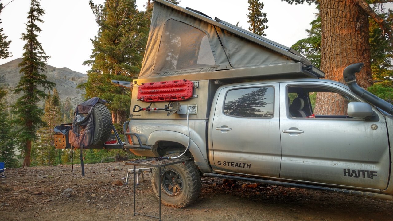

    For those of you who had L tracks attached to the side of your drifter. Will you send me a list of items I would have to get if I wanted to mount MaxTrax to this area?

    I haven’t done the project, so I don’t have a full bill of materials, but:
    Aluminum flat stock, L-Track bolts & nut to bolt the flat stock vertically.
    Then the MaxTrax mounting pins attached through the flat aluminum pieces.
    Drill bits for making holes in the aluminum.
    Debuting tool or round file to smooth the edges of drill holes.
    Blue LocTite to make sure nothing ejects on the roadway.

    Pretty much what I did. I have one of those indoor/outdoor thermometers and the outdoor sensor is on the Drifter wall behind the Maxtrax - kind of sandwiching it in place so it’ll never come off while on the trail. And the L-Track is so damn versatile. I also have a DIY shovel mount and shower head mount attached to the it.

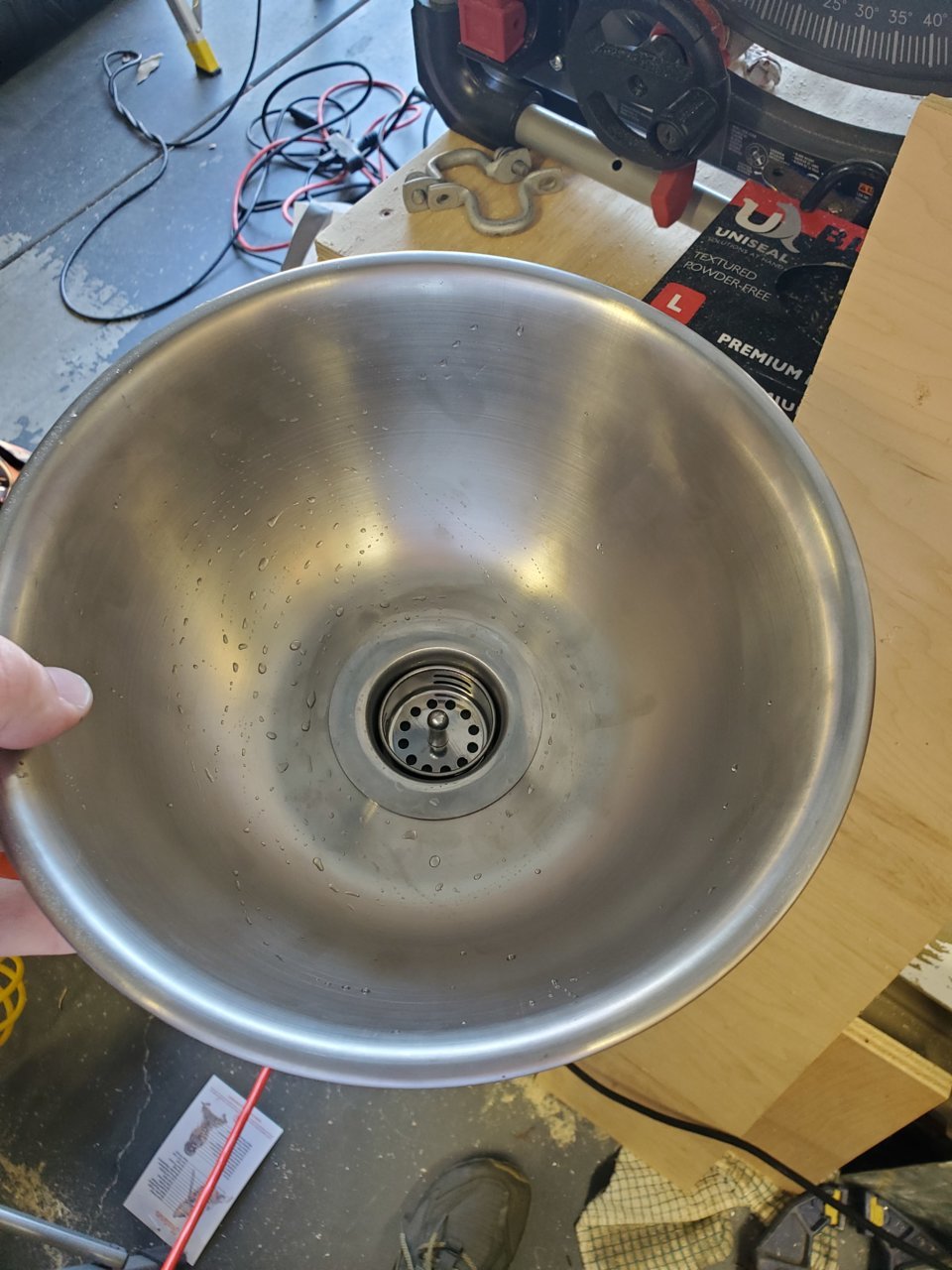

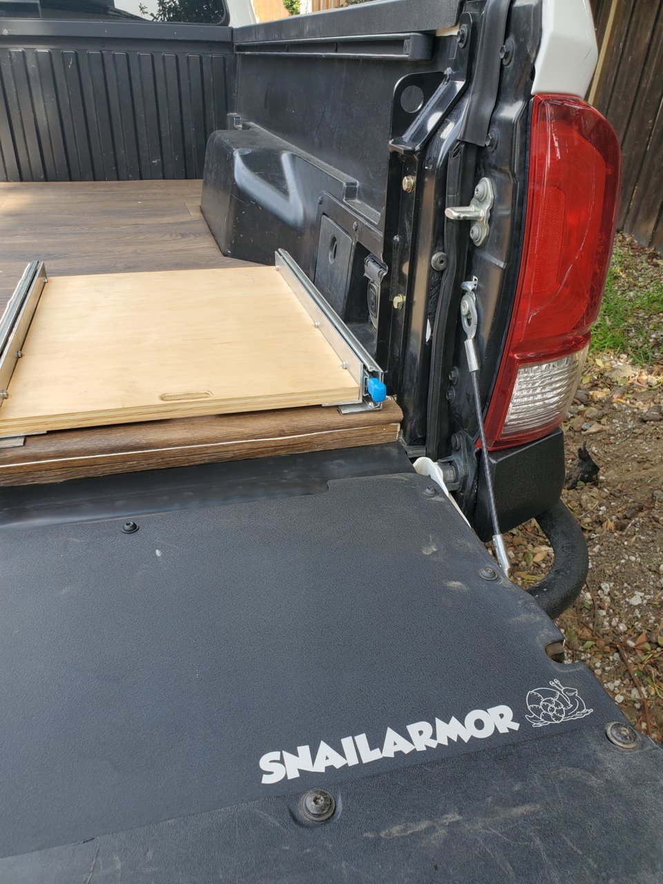

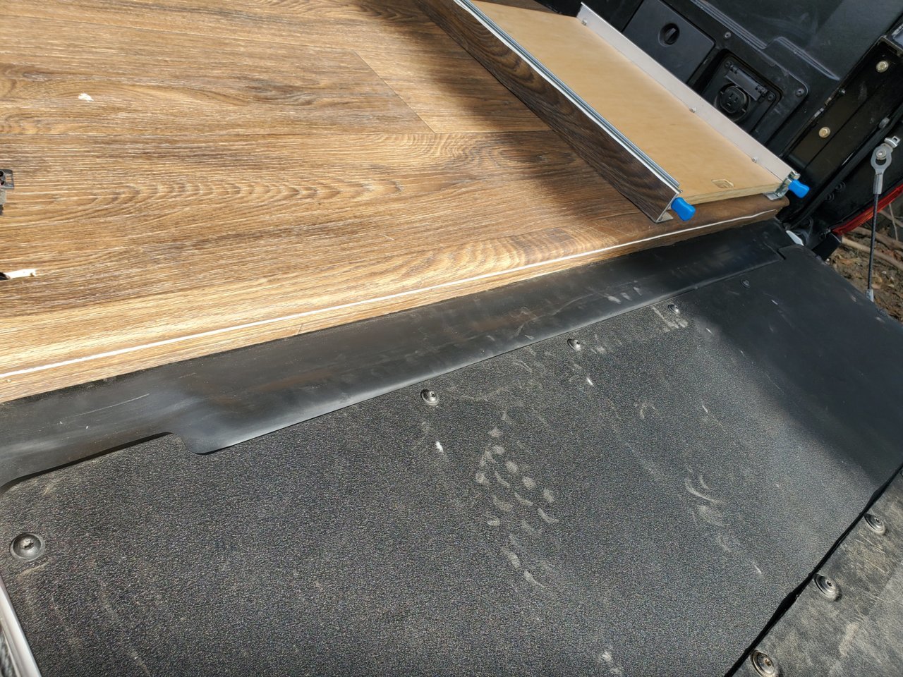

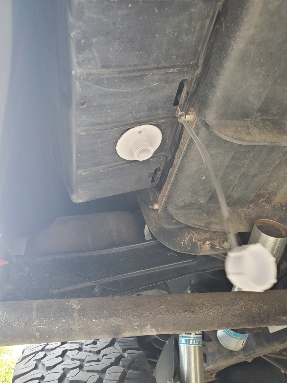

    Preach!!!! Running out of projects that can be done pre-drifter
    Tailgate seal kit fit nicely under the snailarmor flat tailgate pannel. Sink is assembled and the threaded drain is installed.
    20210303_130638.jpg 20210303_130648.jpg 20210303_130835.jpg 20210304_105705.jpg

    What tailgate seal kit is that? I have the perimeter kit already but am looking for something for my Mountain Hatch.

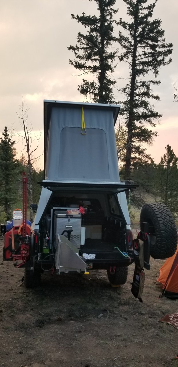

    Nobody's building a slide in stove setup beneath their fridges??

    https://www.amazon.com/dp/B00R8KBV9Y/ref=cm_sw_r_cp_apa_fabc_R0XJZP3XZ08F9NSFKMVC?_encoding=UTF8

    That's pretty much all I have. Sorry for the bad angle pics, all I had. I wasn't in a position to be able to build anything so I installed a GooseGear camp kitchen.

    I am. Puts the fridge up pretty high while on the ground, but I figure it's worth it

    I had plans for this but abandoned it due to the height concern. Are you planning on sitting on the fridge as a bench too? You are adding 3inch minimum to height.
