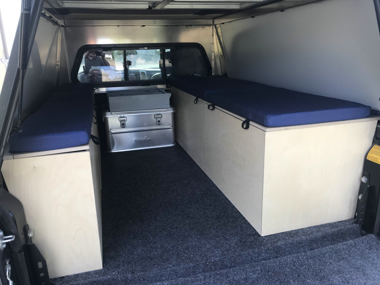

    I used some 1" foam insulation boards to DIY insulate my walls. Make a cardboard template first and then trace on to the insulation board and cut with an exacto knife. I covered mine in carpet and then attached it to the camper with spray adhesive. I'm not sure it works as well as Vagabond's version, but it was a lot cheaper and took me an afternoon.
    I haven't insulated the bed itself since we're never actually standing on the bed and I figure all of our stuff and the build out keeps us somewhat insulated. We're also only using the camper for up to a week at a time in mostly nice weather.
    It's also nice cause I can Velcro things to the walls!
    H8If7Iub1he3QUansXa8ef3NnZ2JPiytQOGAqILg_e69488cf7c824d1985ab36a961874cb3862fa18c.jpg

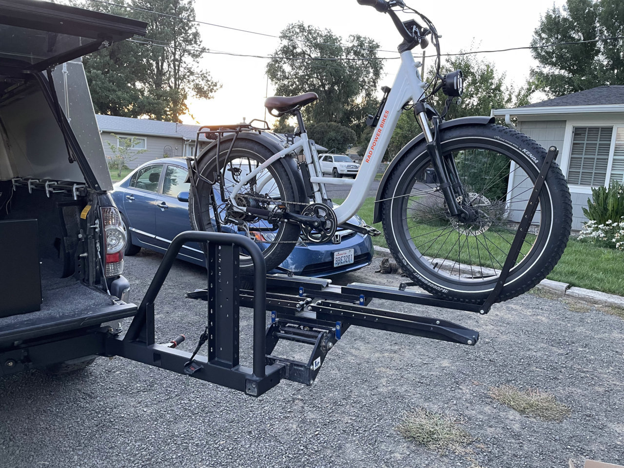

    I have been puzzling over this since I picked up the Drifter a few years ago. I looking into a $4000 rear swing-out bumper and many other ideas. I have a Propex and love its reliability. It has not failed to light, even after being off for a summer.
    In the end, I settled on the humble Ultra Swing. Half the price of the bumper, and allows my bikes to swing on a 1UP rack as well. I plan to put the propane tank on the swing.
