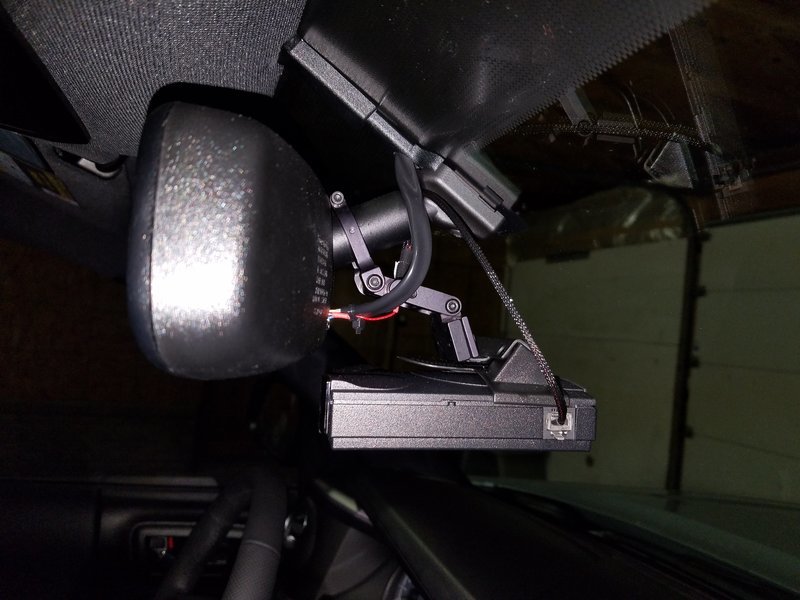

    Searched the forums and didn't see this posted for the 3rd Gen or for a HomeLink Mirror so I thought I'd share.
    Red wire connects to the Tan wire for the 12v
    Black connects to the Black/White for the Ground
    BlendMount #BV1-2002
    MirrorTap MT-2009
    (*these parts were re-used from my previous car and they just happened to fit)

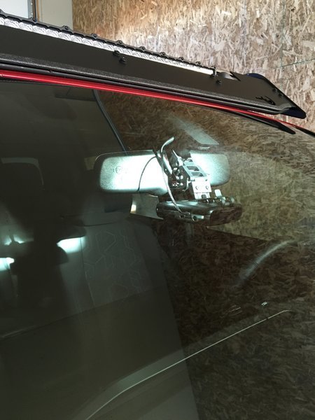

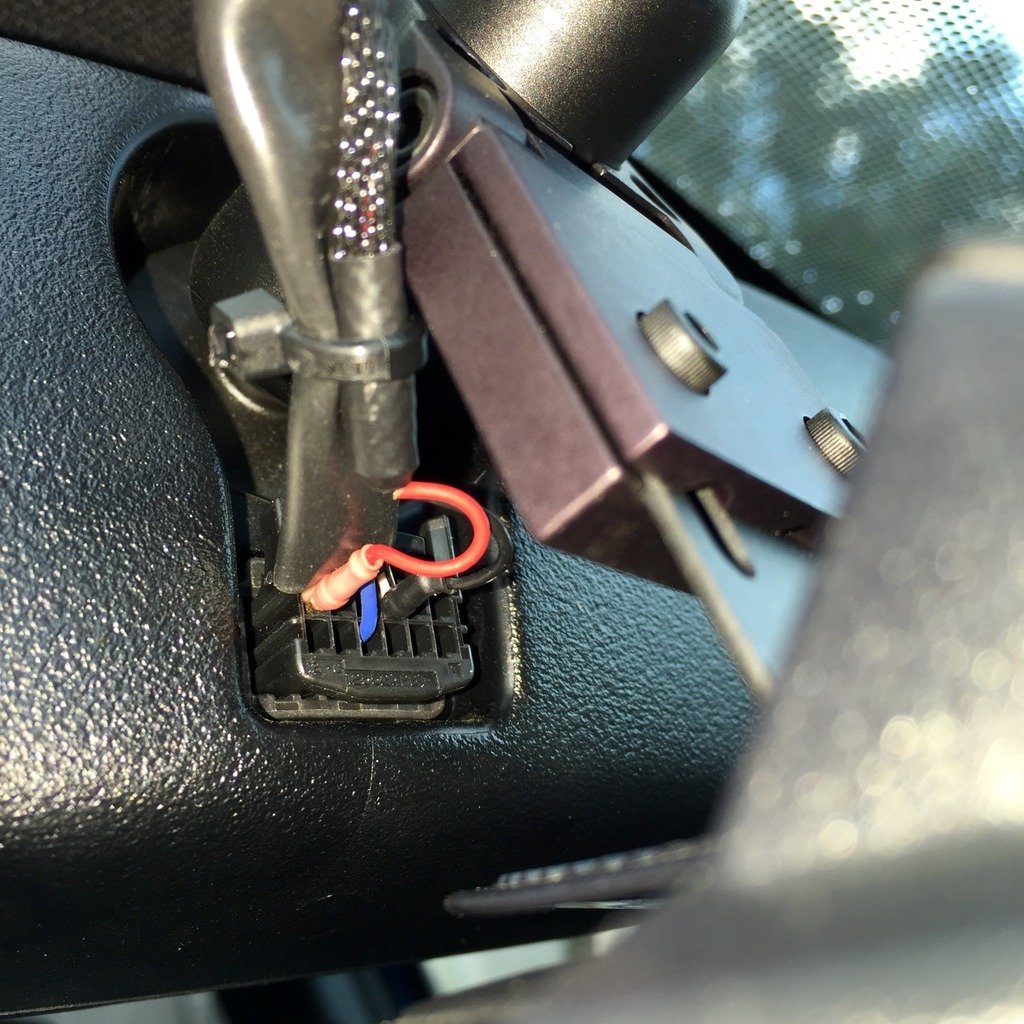

    Blend mount is the only way to roll. Its a clean install, turns on and off when you start your vehicle.

    Another clean install with pictures, very nice!

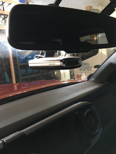

    I looked at this mount when I was setting mine up. Nice product, but stupid expensive.
    I ended up with an identical solution using RAM parts. And a bit more flexibility in positioning, too.
    1. http://www.gpscity.ca/ram-mount-diamond-plate-with-1-inch-ball-ram-b-238u - Diamond plate's holes line up just about perfectly with the OEM suction-cup bracket that comes with the detector. Pop the suction cups out, use any hardware on hand to attach diamond plate.
    2. http://www.gpscity.ca/ram-mount-medium-arm-b-socket-ram-b-201u - an arm.
    3. http://www.gpscity.ca/ram-mount-zinc-u-bolt-motorcycle-mount-base-ram-b-231zu - u bolt base.
    This might work as an alternative to #3, but I haven't tried it - http://www.gpscity.ca/ram-mount-plastic-rail-mount-base-with-1-inch-ball.
    $40 CAD which should be roughly $0.50 USD. Bonus is you can reuse the RAM parts in future projects (I've been reusing the parts I bought some 6-7 years ago ever since).
