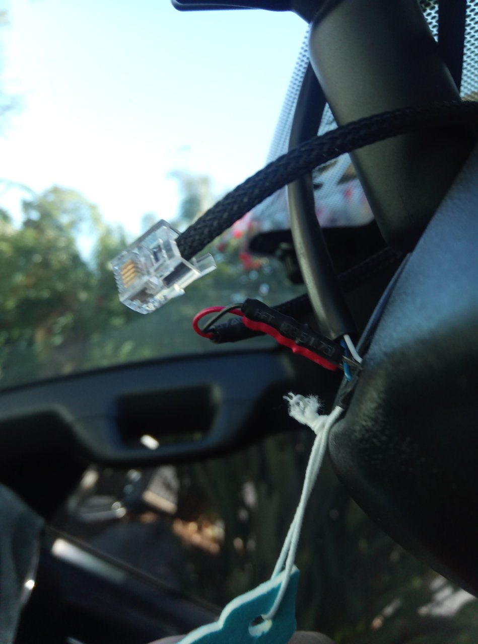

  4. Mar 30, 2017 at 4:59 PM
    #24
    Cclogan8
    Cclogan8 Well-Known Member
    Oct 1, 2016
    #198683
    193
    Logan, Utah
    16 Taco DCLB
    Its getting bad, Im almost broke.
    I've have detectors installed the same way in 3 different cars for many years now. No issues
    helix66 likes this.
  5. Mar 30, 2017 at 5:03 PM
    #25
    Persnickety
    Persnickety Well-Known Member
    Aug 7, 2016
    #194006
    115
    2016 TRD Sport 4x4
    I've been using the wire tap on several different vehicles that I've owned...as far as mounting goes, I mix a two part epoxy and set the suction cups and bracket where I want it. A couple of hours later I'm in business.
    The suction cups, w/epoxy, remove easily with a razor blade when the time comes.
  6. Mar 30, 2017 at 6:12 PM
    #26
    0210
    0210 Well-Known Member
    Feb 12, 2016
    #178004
    2,564
    Vancouver, BC
    2016 TRD Sport Upgrade DCLB
    Without a fuse to protect the radar detector, any fluctuations from the circuit can make their way to the detector and fry it. Similarly, and arguably more likely, should something go wrong in the detector and cause it to draw a large amount of current, without a fuse that current draw will transfer to the truck's wiring, and that'll be a nightmare and a half. I'd (at a minimum) put an inline fuse on the mirror tap's positive terminal.
    Will the worst case scenario ever happen? Of course not, that happens to the other guys. But if you don't want to ever be that other guy, spend the $2 on the inline fuse holder and an extra five minutes of your time to wire it in.
    And as always, the tap results in more current being drawn through a circuit not designed for the load, so that's another potential issue that (in an ideal world) would be avoided via a dedicated line from the battery + new fuse box for your accessories.
    EagleUSMCRet likes this.

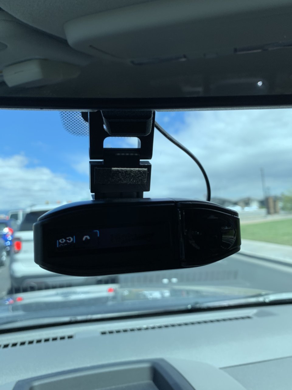

  11. Jul 21, 2019 at 9:20 AM
    #31
    trdmikey8
    trdmikey8 Well-Known Member
    Jul 8, 2016
    #191539
    374
    2016 Tacoma TRD Sport
    Snugtop Camper Shell
    I just did mine and it took 2 minutes. I see the mirror tap brand is more of a clean look and goes in all the way. I found one laying around the house luckily but I'm not sure what the brand is. Plugged it in but seems to be protruding than the mirror tap brand. It works though
    illogical[OP] and EagleUSMCRet like this.

  14. Jul 21, 2019 at 1:24 PM
    #34
    helix66
    helix66 Well-Known Member
    Nov 10, 2017
    #235675
    1,821
    DPRC
    2017 DclB TRDor MgM
    ProGrille,MesoStuff,Tinted,AllPro sliders, RCI ALL skids, BAMF diff skid, KDmaxPro tune, Demello bumper, Warn evo10s, BD s8 & squadrons, Accutune UCAs, Fox 2.5pes, Eibach & Deaver
    How is it under the mirror?
    I was considering mounting my escort 9500ix there but I already find the mirror kind of low and was considering something off the dash (front windshield is tinted & window mounts are illegal in CA).
    I wonder if the non-homelink mirror has those connections...have to take a look later.
  15. Jul 21, 2019 at 1:41 PM
    #35
    raidercraig
    raidercraig Well-Known Member
    Jun 10, 2019
    #295977
    281
    I really like it. The auto lockouts, directional arrows and K band filtering are great. I have the 360, the 360C is the newer model. Only difference the new 360c gives you hot spot capability
