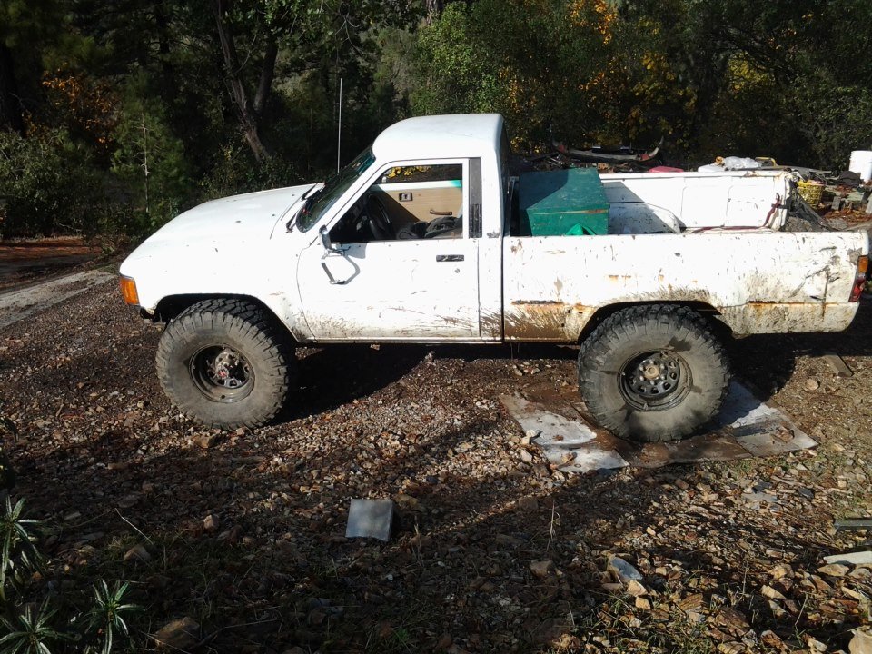

    Well after wrecking the taco I couldn't go with anything but another yota. So I picked up a bone stock 84 from a buddies dad. it was ruff...to say the least. Mechanically sound as could be...but it was a hunting truck for the last decade of its life so...yeah.

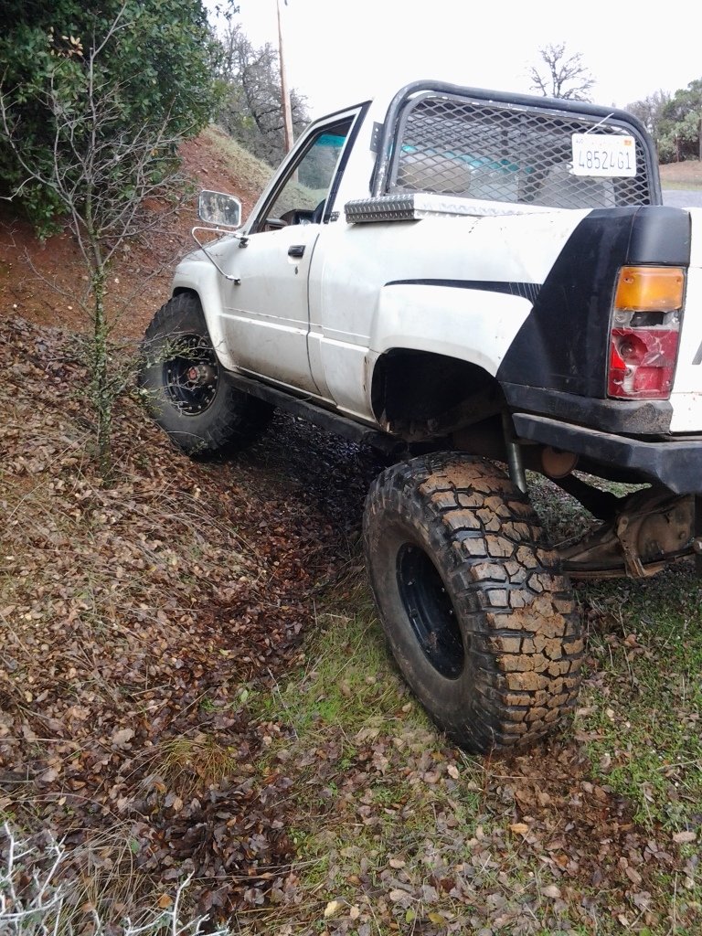

    1984 standard cab 22r 5spd bone stock 330K and running like a top...gutless top but i should expect that when i was used to a 3.4...

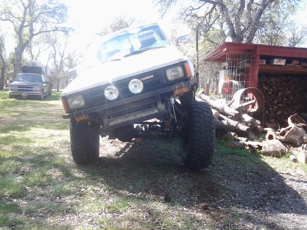

    stock IFS gives this bitch a run for its money in the flex department.

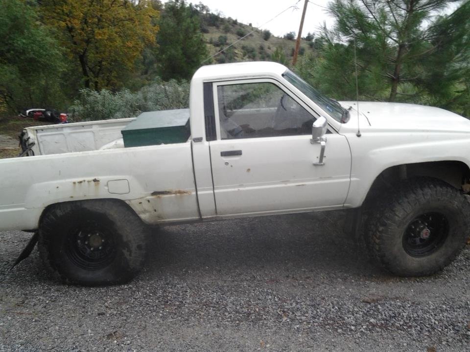

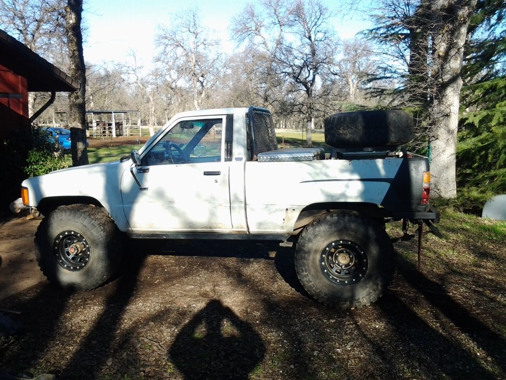

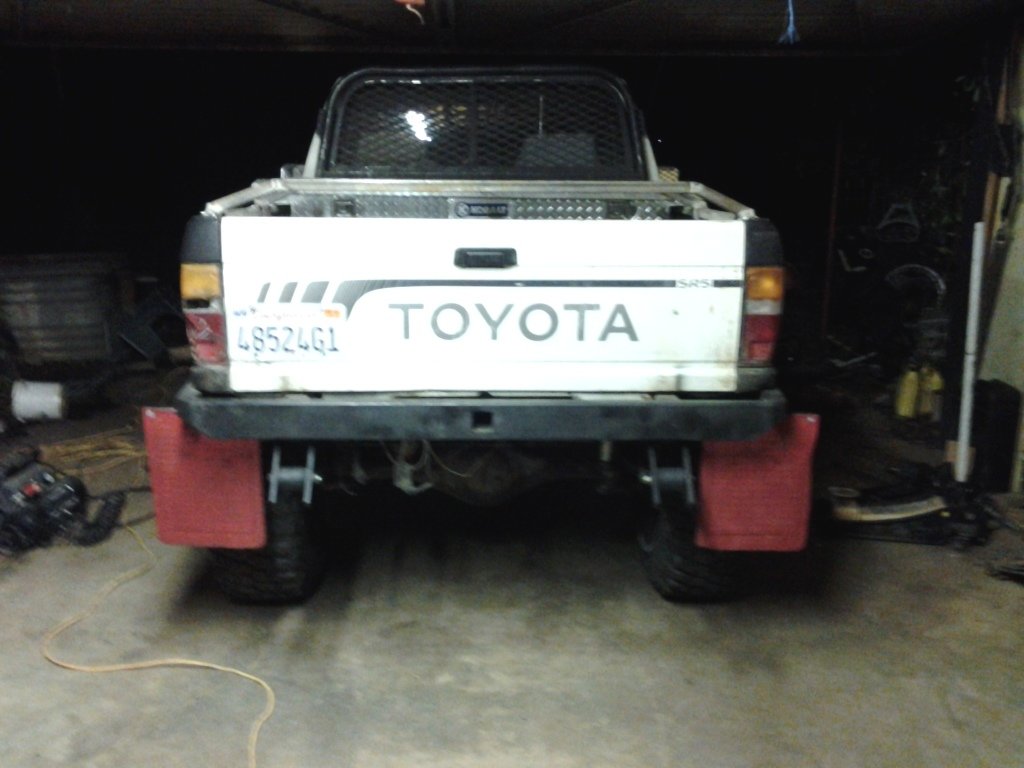

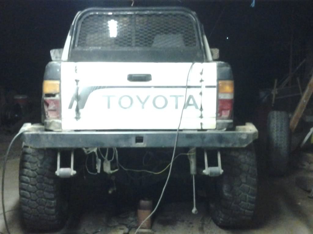

    Then I picked up another bed that didn't have the massive rust holes mine had and a tailgate cause I hate not having a tailgate...oh and I bobbed it 15 inches :cool:
    Made some quick disconnect mud flaps to keep the po po off my back. and a quick rear bumper.
    And 63" Chevys. I need longer shocks, my 10" are limiting.

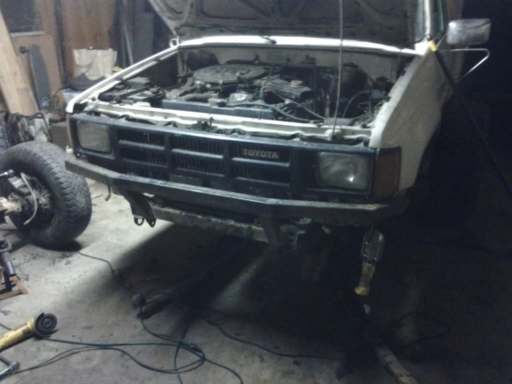

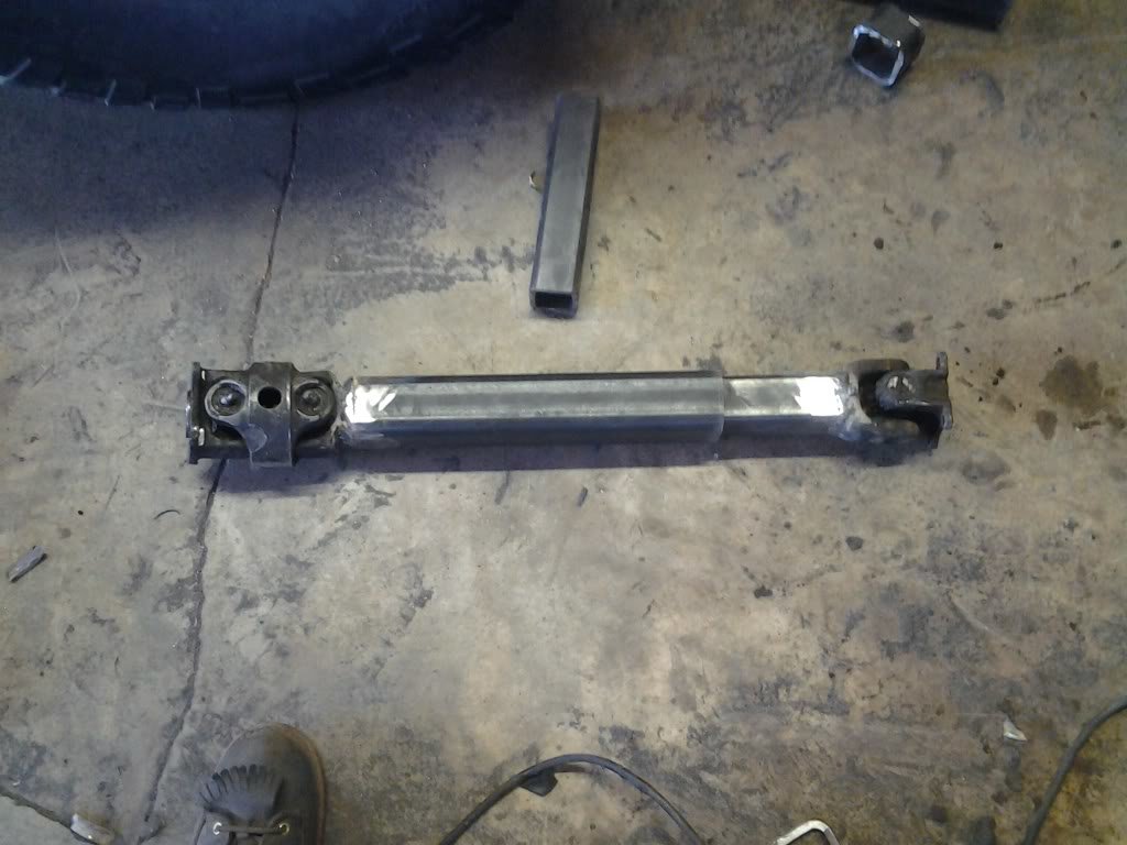

    got RUF done, square driveshaft, power steering also rebuilt the axle while it was out. flexes great. just need some time to get my elocker in the rear now

    modified ifs rear housing for elocker so i got a rear locker now. so nice. gonna weld my spare 8 inch 3rd soon for the front.
    also dovetailed :D
    almost done will get more pics when i finish the bondo job on the tailgate and refit bumper.
    working kinks out of front end right now too. got to re shim my knuckles and get a better preload. some wobble out of it right now. also stock shackles are limiting flex so making new longer shackles, probably gonna pull a leaf to compensate for shackle length too

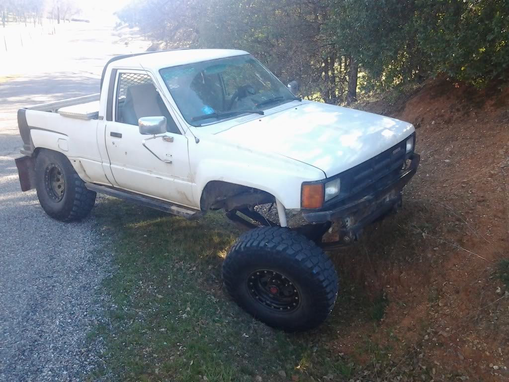

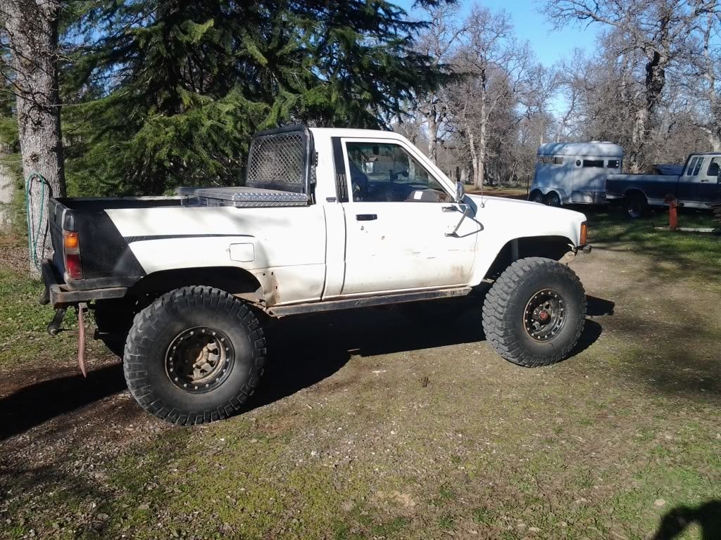

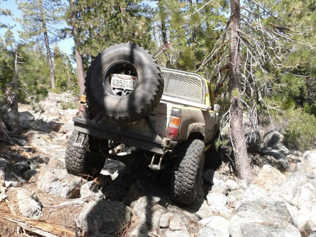

    Front end got changed around with longer 3rd gen leafs. and now am utilizing the last couple inches of my 14" shocks
    Still need to do new high clearance portion of my bumper now that it's dovetailed, but i did add a tire carrier.

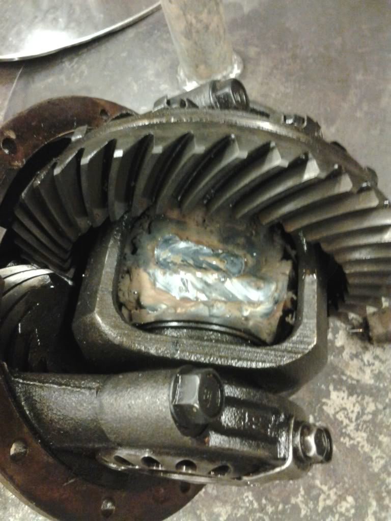

    Welded my spare diff and threw it in the front

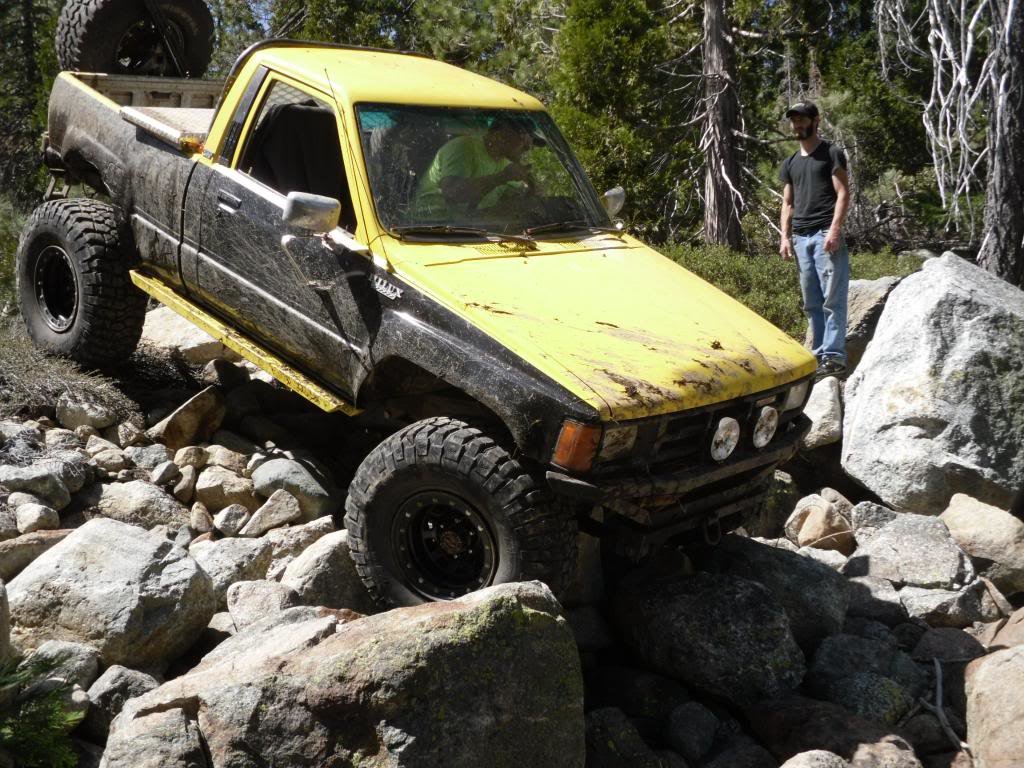

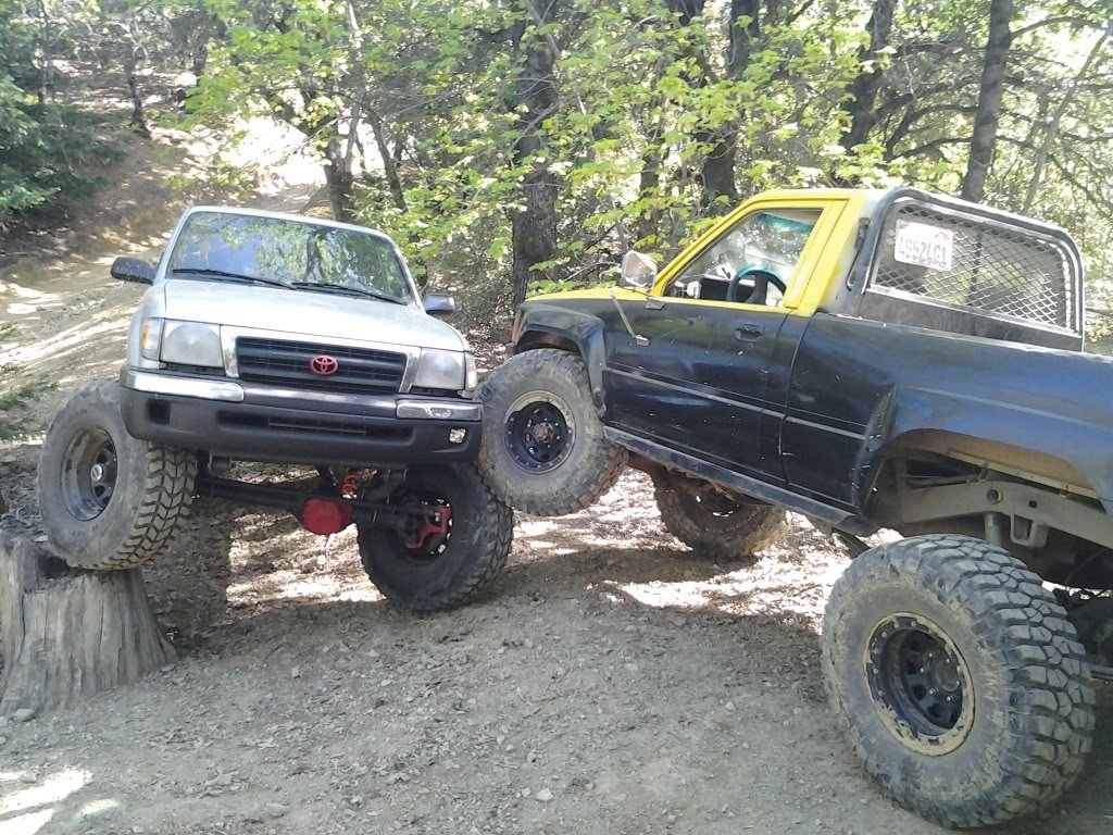

    And then I went wheeling :D and managed to break a hastily made and oonly partially welded on shock mount resulting in snapping a shock rod:eek: and to my amazement i didn't blow a stock birf, but i brought spares just in case

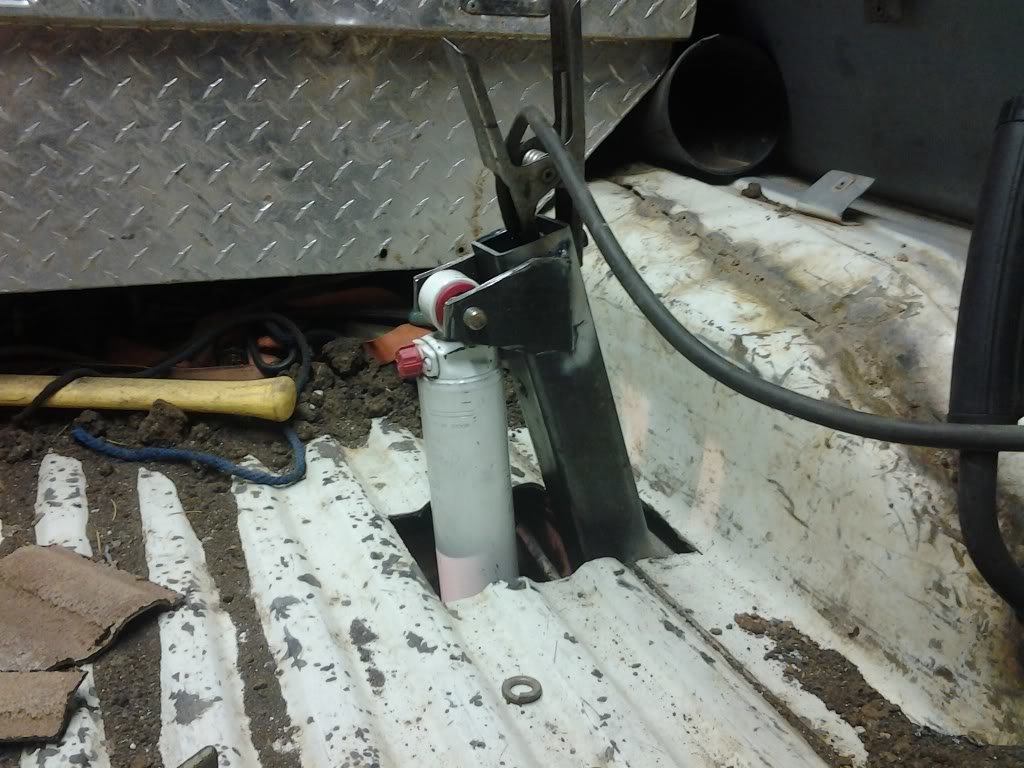

    I got some 13" rancho shocks for cheap and started on through the bed mounts tonight.
