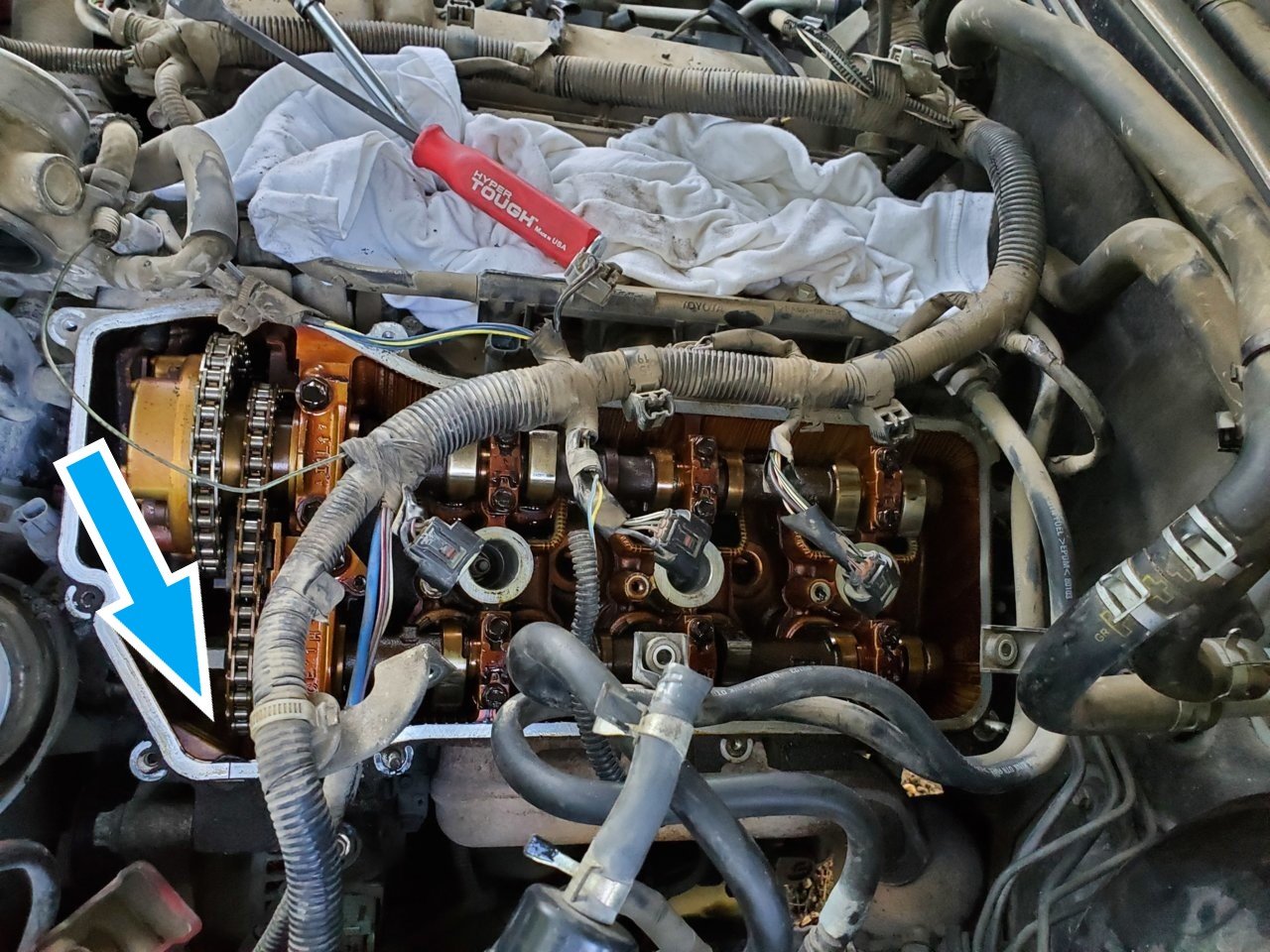

    Hey everyone. I have a spark plug well on the passenger side that had some oil in it, so I am going to replace the gasket. Couple questions for anyone who might like to help a a guy out:
    1. The driver side seems fine (for now). If it were you would you do both or just the side that has the failure? From the way it looks passenger side might be a lot easier and less time consuming to do on it's own. If it were the bothersome side I would no doubt do both, but it just seems pointless if that other gasket hasn't failed..., yet. Tell me to quit slacking and do the right thing if you want.
    2. Here is where my newbness will shine, but the pieces that connect the spark plug o-rings together and to the gasket, do those stay attached for the install or do they get snipped? My logic tells me things flopping around inside a place where other things are moving about doing enginey type stuff is not a good idea. But people much smarter than me designed this and some of you folks who have done this work will know more than me, so please enlighten me.
    3. And lastly I saw the mention to add some rtv to the area where the timing, head, and VC meet? Is the convenient arrow in the pic I have added below that spot? I mean it looks like there is a gap in the gasket surface so again, logic tells me that is the place. If not can someone point me to the right place?
    Please take it easy on me. I am not an idiot, I am just very literal and I overthink everything, especially when it comes to the old gal. Last gaskets I replaced were on a small block chevy, so this is overhead cam, spark plugs through the valve cover business is alien technology for a guy who hasn't had to wrench much on vehicles since I started driving Toyotas.

    If it was my truck, I would probably only do the passenger's side if the driver's side is OK. Since it's a V6, you can always go back to do that one if it ever decides to leak.
    But I understand the people who prefer doing both, since you've already done half the work to get to the driver's side.

    Yeah it even looks like there is a little RTV left over from the original gasket. Just pick that piece off and put a dab right there with some new RTV.

    And leave the rings attached. You're not supposed to snip them apart...

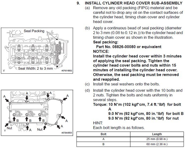

    Stupid question, what kind of RTV were you talking about? Is it the hardened glue to make a gasket maker or lubrication?

    Toyota calls it seal packing.
    The rest of the world calls it RTV.

    I got you. But I'm still confused since we are replacing an old valve cover gasket with a new one why would we need to apply RTV? just curiosity.

    Just remember. Bolt and Nut (B) are in inch/lbs.
    That is, if you actually torque them to spec.
    I’ve never torqued a valve cover bolt. I just go by feel.

    I know your post is from 4 years ago, but just wanted to mention that there should be 2 places on EACH valve cover that needs a little bit of RTV sealant. Your arrow is correct, but there should also be a spot directly above your arrow that needs a little bit of RTV sealant. There should be another slit that looks exactly like the one you put an arrow on that is at the top of the valve cover that will need some RTV sealant. Other than that, it looks good! I have been needing to do this on my 2009 Tacoma Prerunner for awhile now, but just haven't gotten to it yet. I am planning on replacing both of my VVT solenoids and filters, so I might just tackle the valve cover gaskets as well, since I will have them exposed. Happy Wrenching everyone!!
