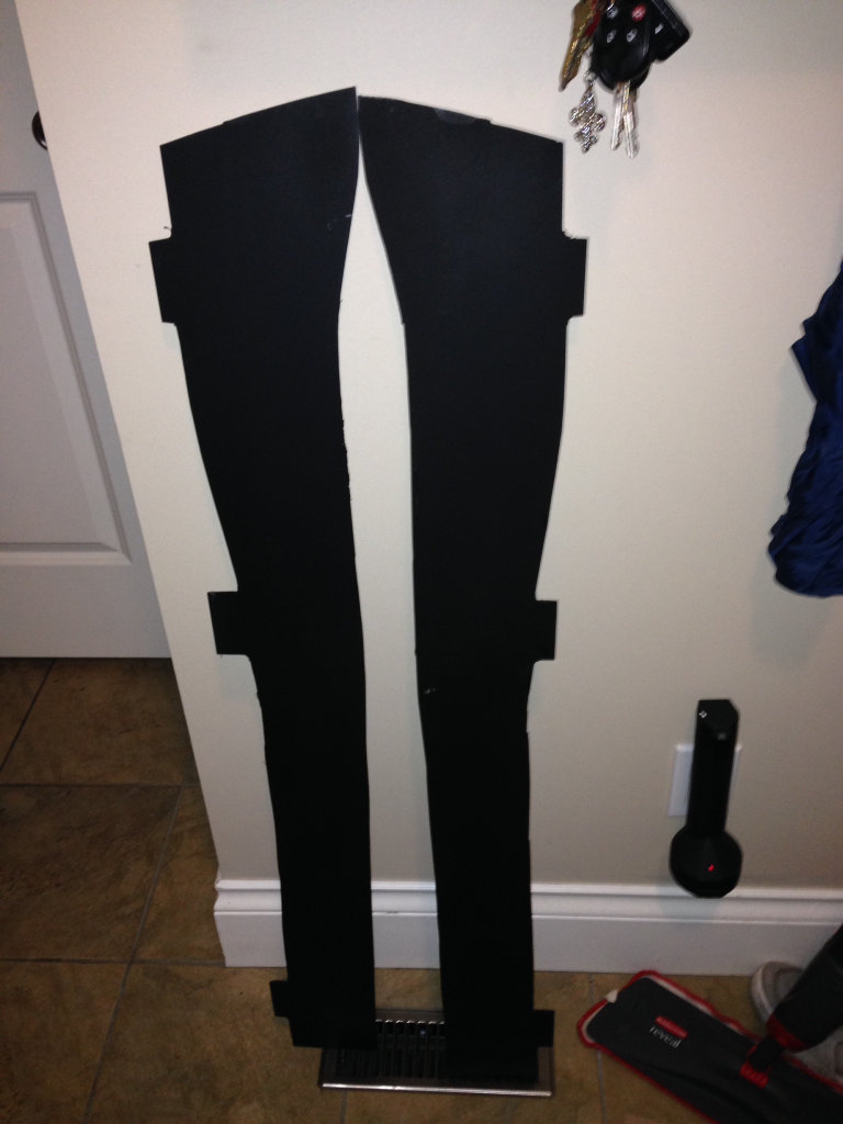

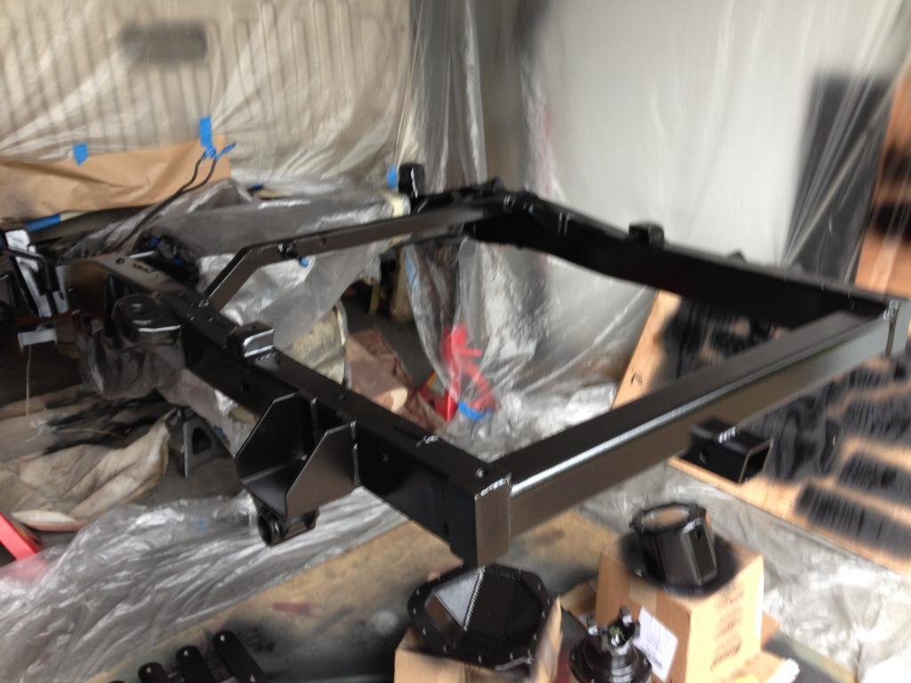

    Under way, bed off, removing mounts and cleaning frame rails. Should be all welded up and in by weekend. Then coating everything with hd epoxy.
    Will have to install ARB and brake calipers and bend some tube for a bumper and she'll be ready for KOH :woot:

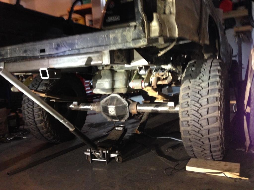

    Taco now sitting on a 1ton read end. The 63's flex like a mofo, so soft yet hold lots of weight. Shock mounts, paint, mount calipers and waiting on arb locker and she'll be running, just in time for King of hammers. Driving the Tacoma down for the whole week :woot:

    shackle angle looks a little flat dude

    6" shackle still going in should bring it up a bit

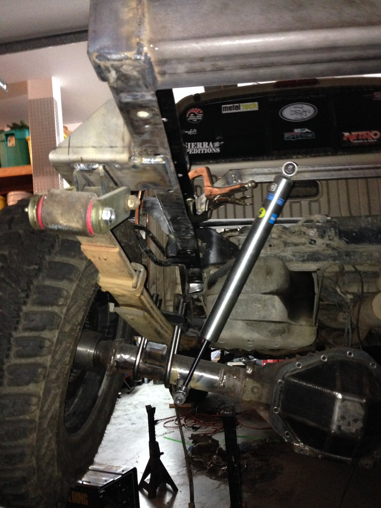

    Shocks mounted and made up some frame plates. I cold galvanized the inside of plates and rails then sprayed with a flame proof paint so i can weld the plates on.
    14" blisteins in and I was close to limiting them with full droop so going to move them a little more vertical, should ride very nice :cool:
