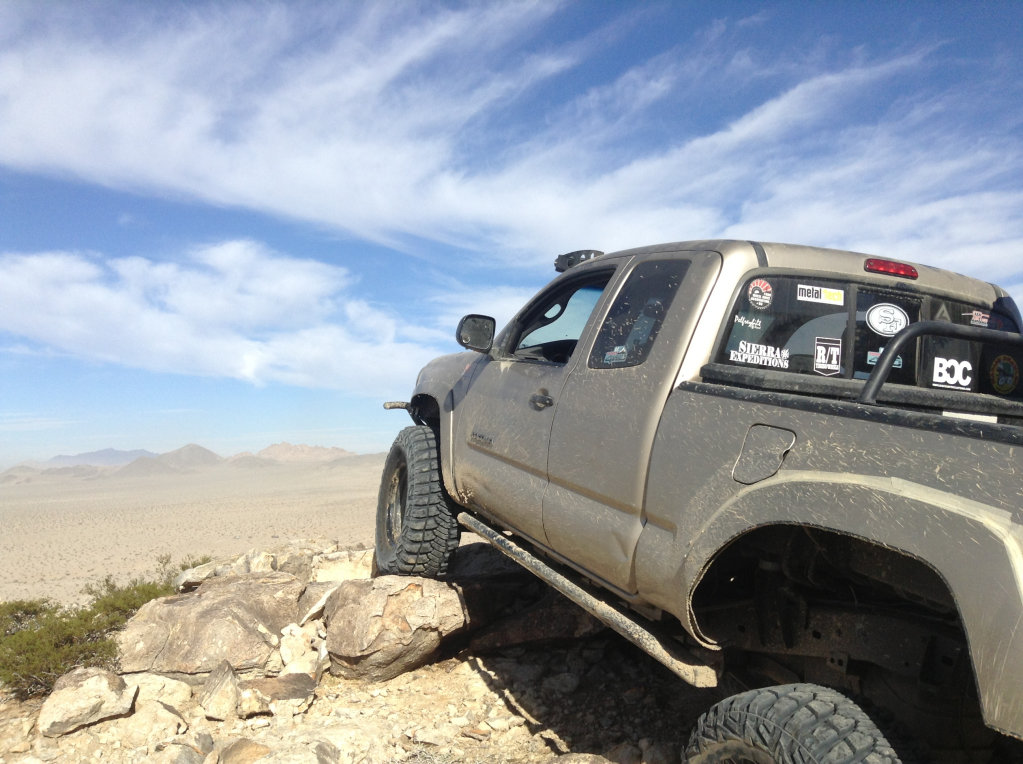

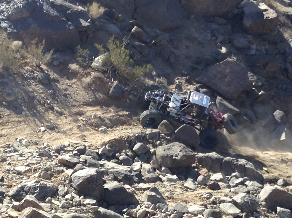

    Welp Koh was fuckin awesome! truck runs great with the 14bt, 3k miles round trip :cool:

    Nice man! That rear shock crossmember looks familiar :D

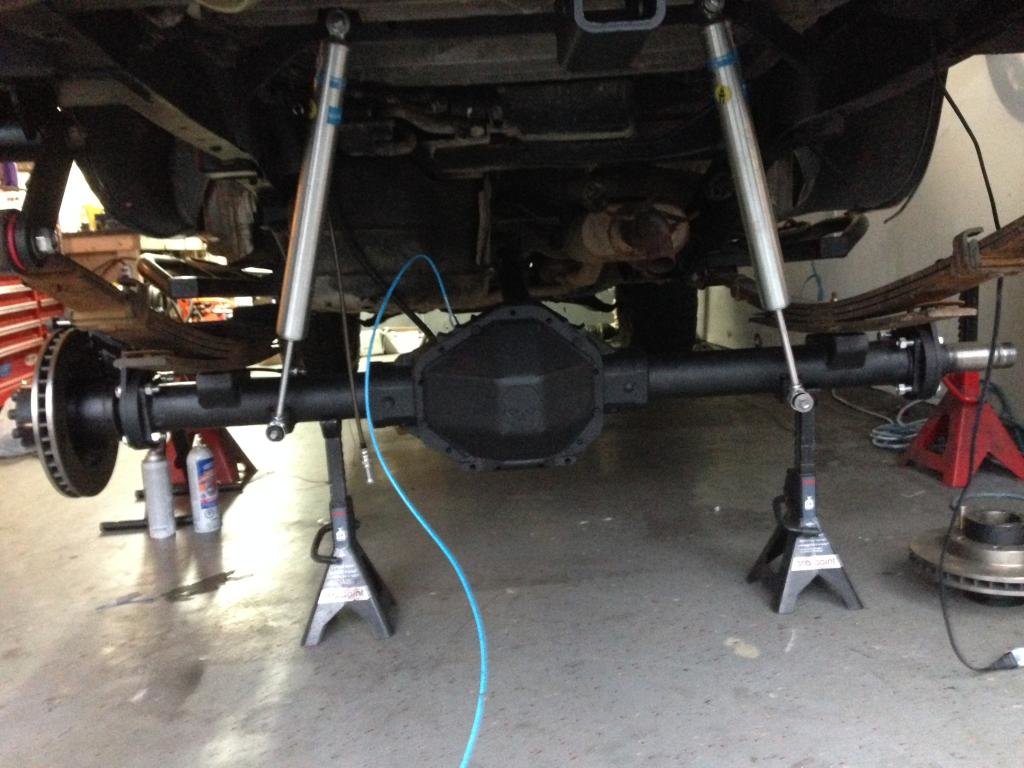

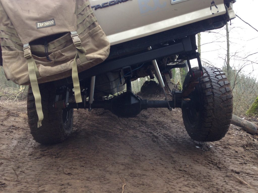

    Flex much :eek:

    Maybe a little lol I got the shocks pretty vertical so don't get a ton of body roll.
    Ya have rear flex for days now, just need to ditch the shitty ifs

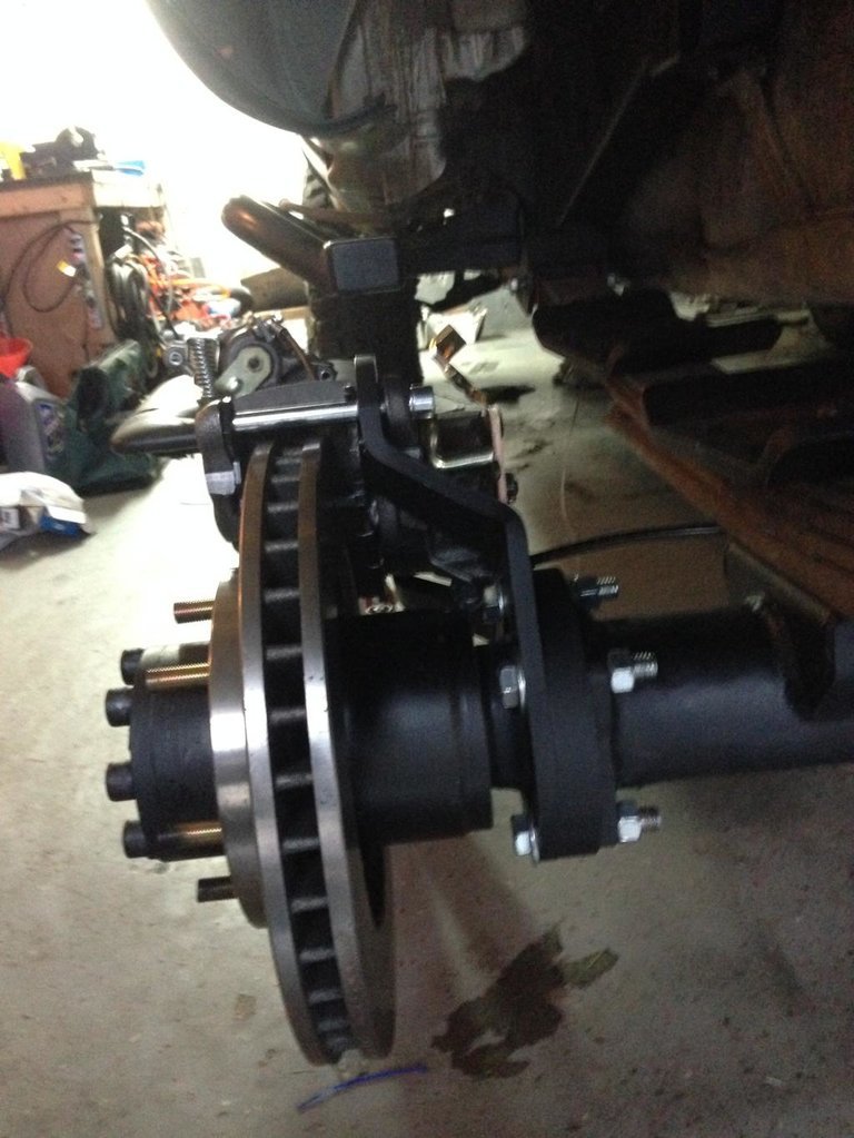

    Yeah I tried to get mine higher but the way I mounted them I used tabs instead of a bolt so I lost about an inch of space. What did you do to convert the 14 bolt to 6 lug did you buy the cut throat conversion kit?
    The rear end looks good I look forward to the progress on the front :cool:
  18. Mar 1, 2015 at 9:46 PM
    #218
    VanCity4x
    VanCity4x [OP] Well-Known Member
    Aug 1, 2011
    #60970
    1,411
    AB
    05 Tacoma
    3link on tons

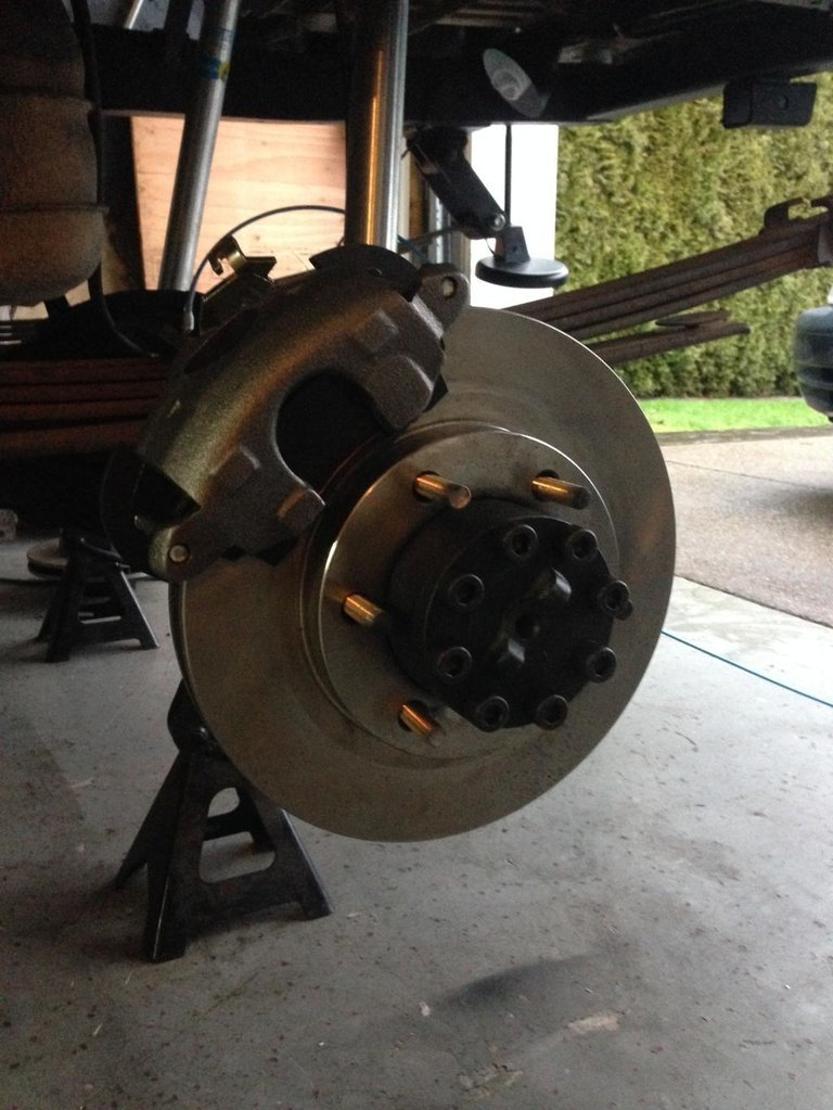

    No I had a buddy mill the factory 8 lug hubs down, plug weld and redrilled for 6. The cut throat kit the rotor still mounts to the inside of the hub I believe where as mine slip on the front, don't have to press out lugs when I wana take the rotor off
    Also a ton cheaper, the cut throat kit is over $500
