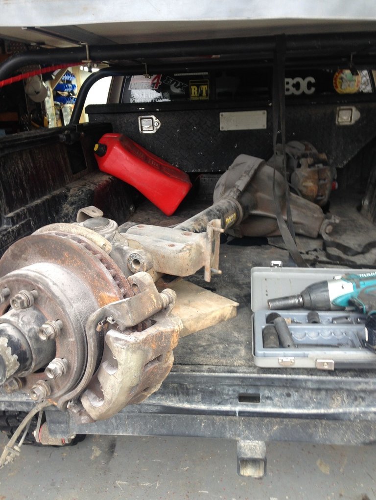

    Here's the front axle, 2003 ford superduty d60. Going to run a Ballistic shave in front as well, plug and redrill unit bearings to 6x5.5 and respline to 35, TMR histeer arms, run warn hubs, arb and 5.13 yukons.
    Also going to be running the basics of Wyatt's 3 link kit, piece together the rest and 14" 2.0 radflo's. Run 38-40" tires. As of right now swap will prob start in late July or August

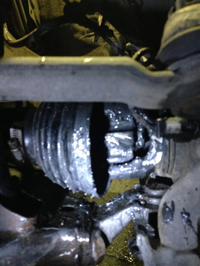

    Last weekend blew out both CV's and a coilover bearing running a very wet and tricky obstical. I'm so ready to sas this bitch

    Me and thekernal are custom spec it, axle/frame brackets, frame plating, Enduro joints, panhard assembly, steering shaft and Rays used 14" Radflo. Also the hydro assist stuff when comes out, think he's working on a kit with Howe
    Link/steer Dom, heims, coilbuckets, ifs box, driveshaft ect were buying because of shitty Canadian dollar.
    Got the front d60 Ballistic shave so will fab that in next couple weeks, also getting knuckles machines for TMR histeer arms and ub's bored for 35sp outers and 6x5.5 pattern.
