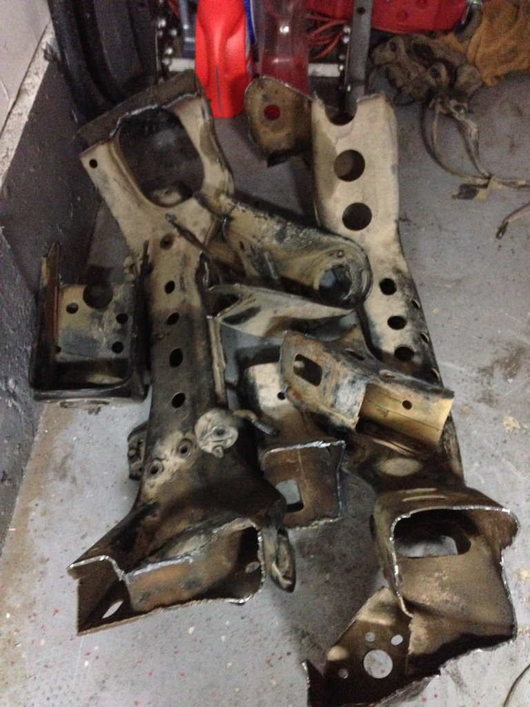

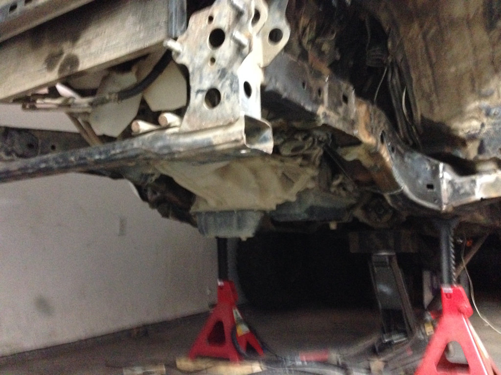

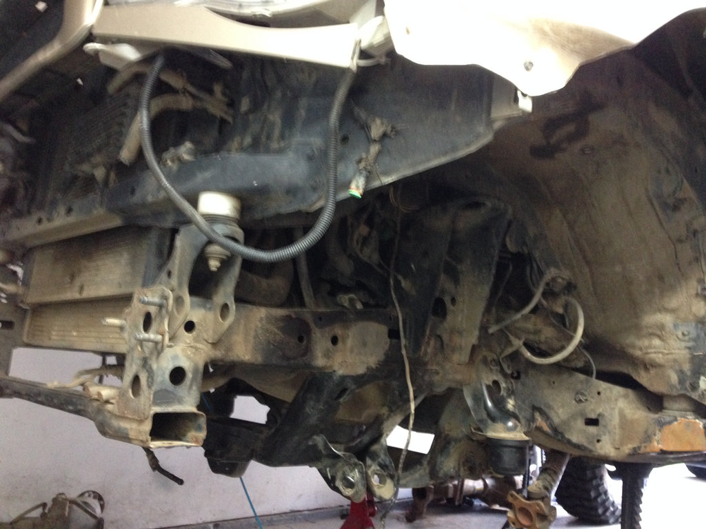

    SAS has started :sawzall::woot:
    Expecting it to be done in July, running most of the RST setup.
    Just picked up some 39 Krawlers, a ARB, 5.13 gears, Warn hubs and getting my knuckles and ub's machined for histeer and 35sp next week.
    All ifs parts are sold
