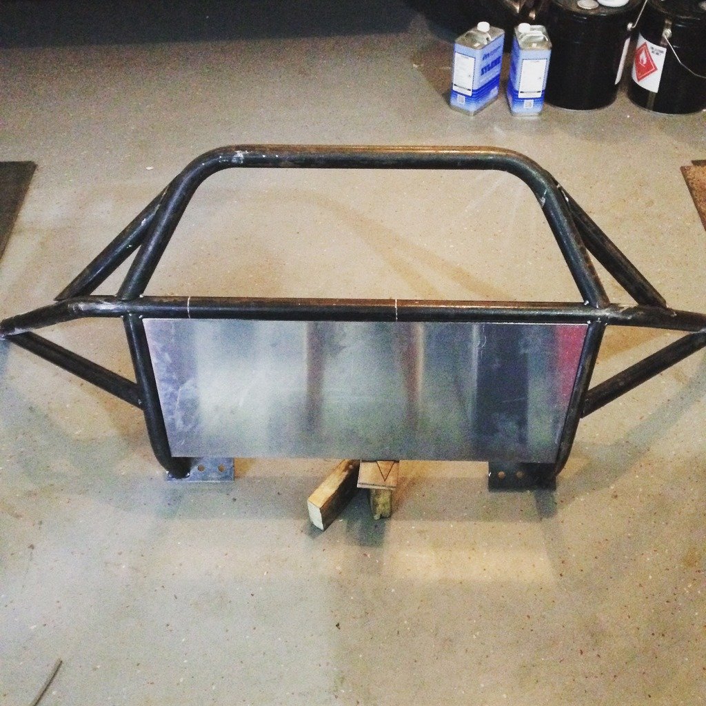

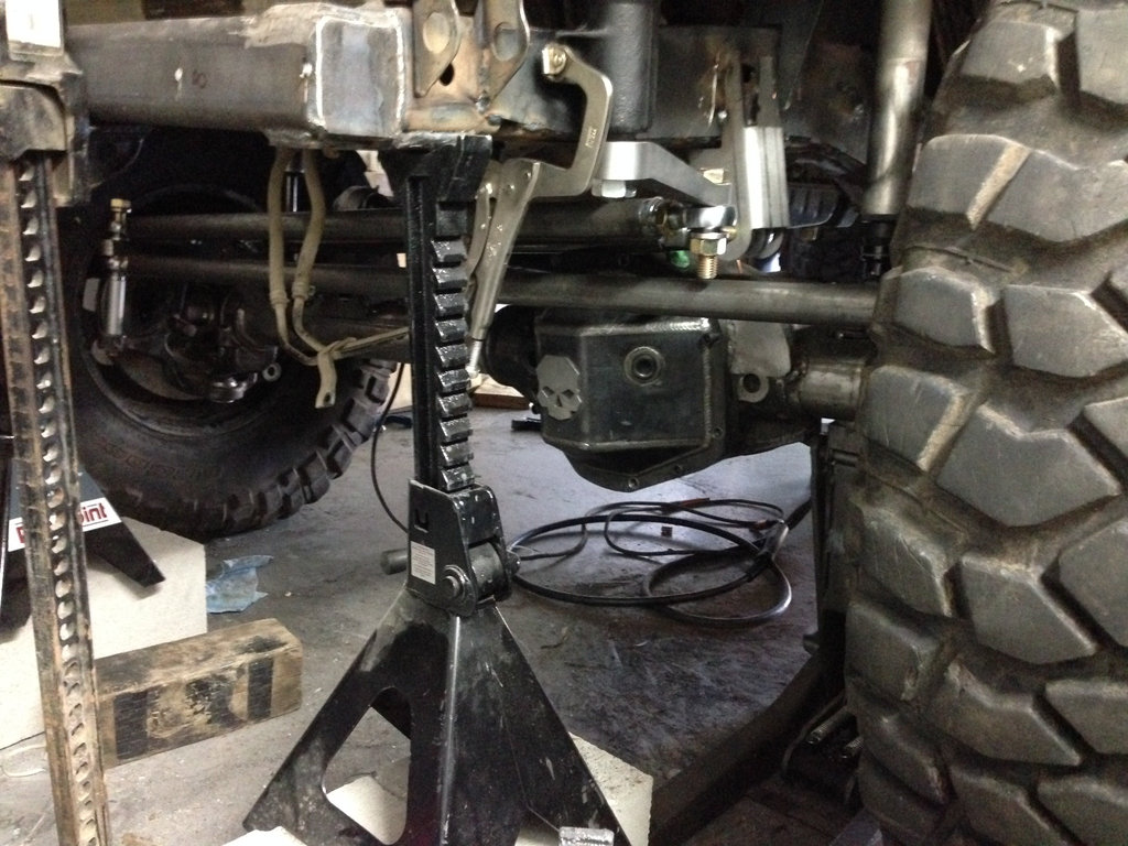

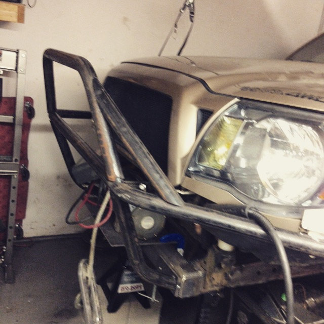

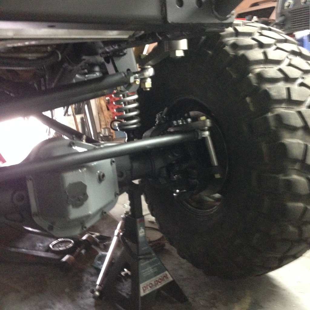

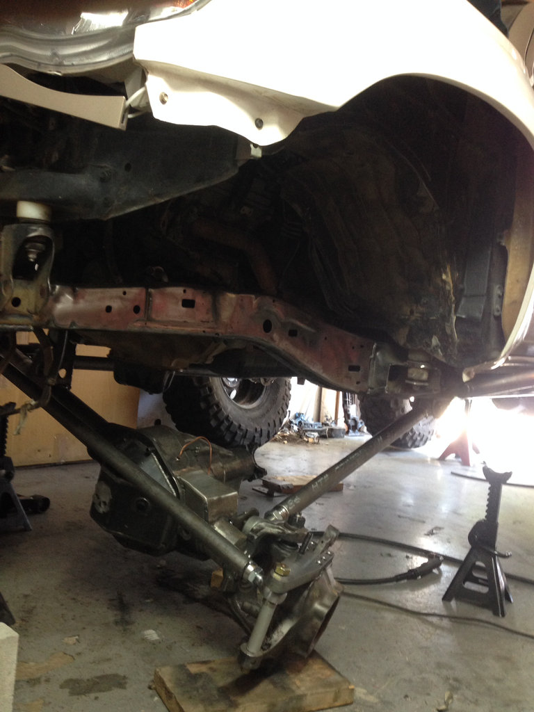

    Update,
    Rear is back together, picking up some fiberglass bedsides, making a tire carrier and rear bumper eventually
    The front has been a bit of a struggle. I ordered a sas kit from RST over 3 months ago and have not received frame plates or lower link gussets (made my own). I am suppose to be getting alum lower links as well. Been caught up in misc fitment and mock up stuff, ie weld washers didn't fit the mounts so had to drill them all out.
    Lower links are in, upper link is bent slightly rather then notching the frame, front bumper and crossmember are pretty much done, working on the trans xmember today.
    Hoping to wrap this up pretty soon, getting it to rolling wont take long after getting the frame plates then coil tower, panhard and steer box.

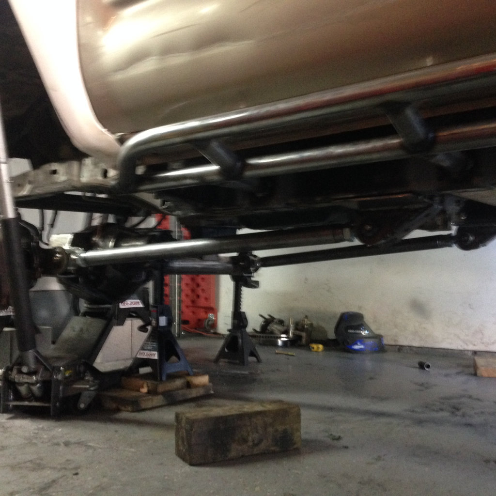

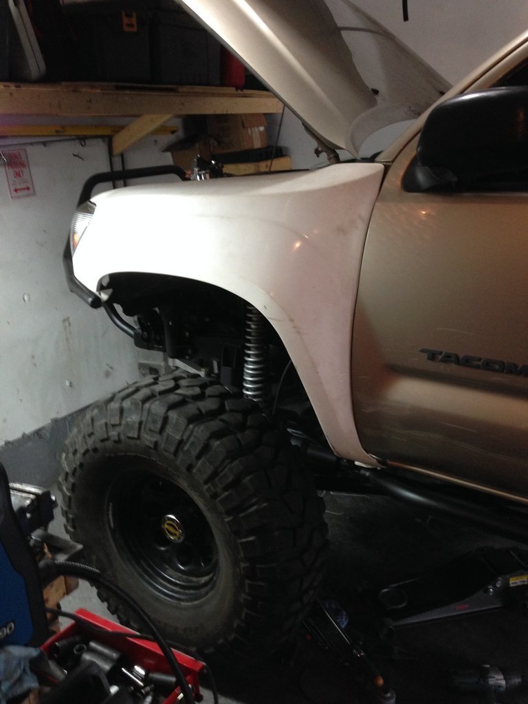

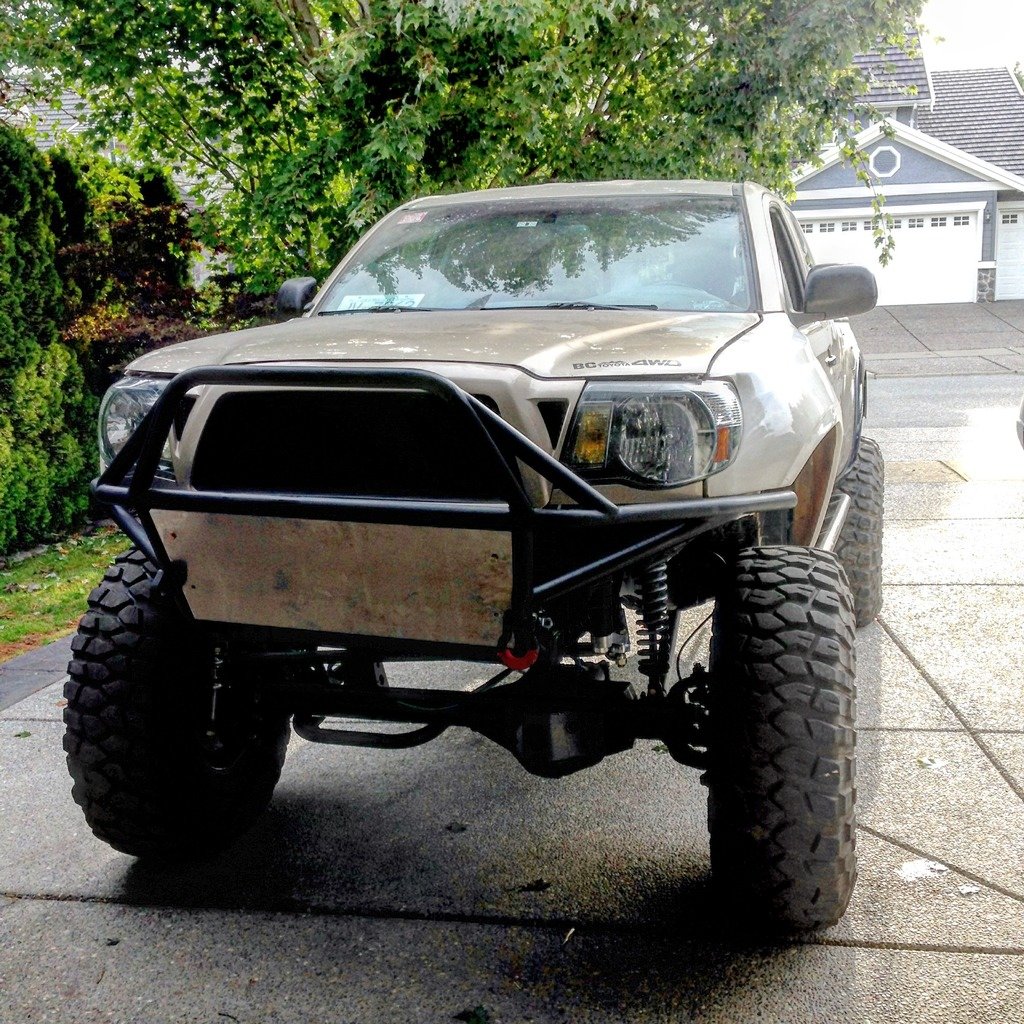

    Painted and rolling. This weekend finishing the steering, brakes and final assembly. Working on getting the stainless exhaust in too. Hopefully get a driveshaft next week just in time for labour day weekend wheeling.
