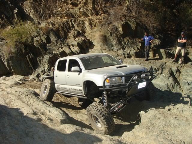

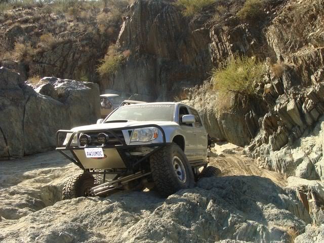

    Keep in mind that up travel in a solid axle configuration for a rock crawler is not measured the same as it would be say a trophy truck that is jumping.
    I have about 3" showing on the shaft of my front coilovers but can do this. Articulation is what your after.

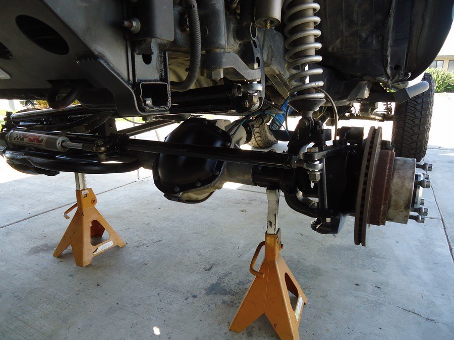

    Yes, Ray was running them 300/300 and still is with the kings. I've been running 300/300 since I built mine. Ray ran those very shocks just as they were when they were sent to you.
    I lowered my ride hieght down some by putting in shorter top springs and a tender spring. But I'm also sitting on the top of my "C" instead of on the axle tube.

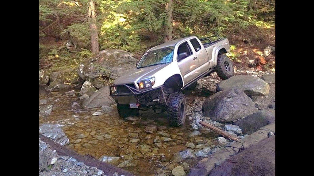

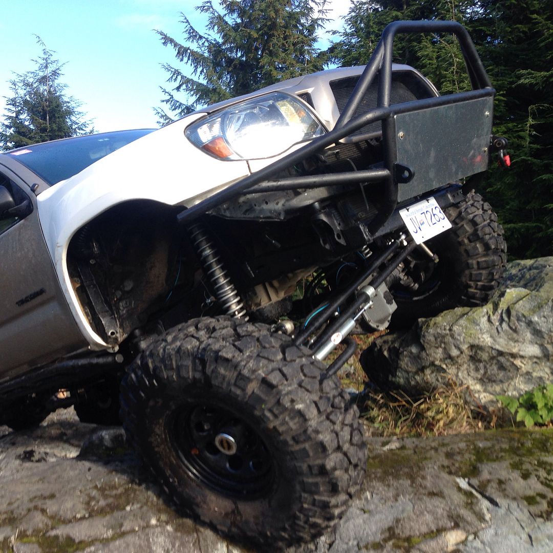

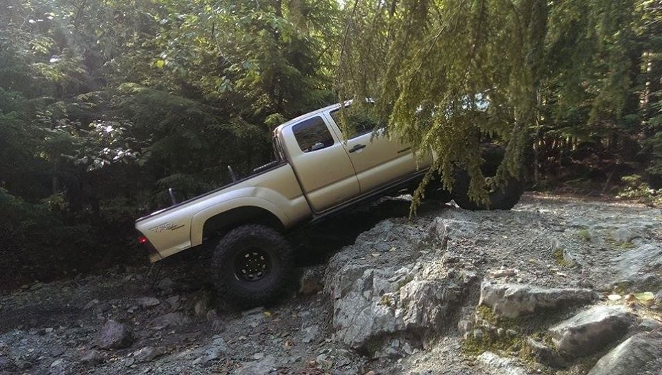

    Took it out and played, she works pretty good. Ton of small misc things to finish and fix now.

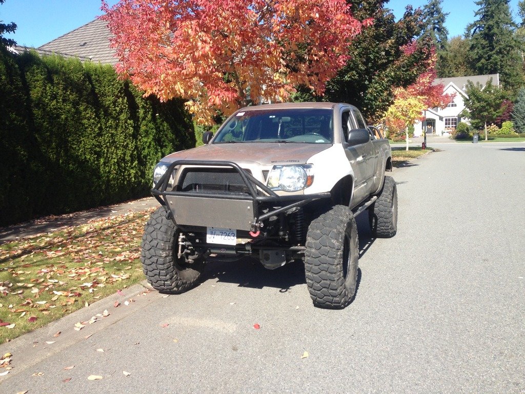

    It actually corners very well on the street, I'm probably bringing the spring rate down a bit might be a little softer but still pretty good for a 3link. It drives sooo smooth on the hwy, holds at 70mph at 2100 rpm, quite, smooth and steering is straight as a arrow, hydro ram works perfect. It's kinda different tho when cornering cause wheel dosent really return to center even with good caster.
    I'm in love with this truck.
